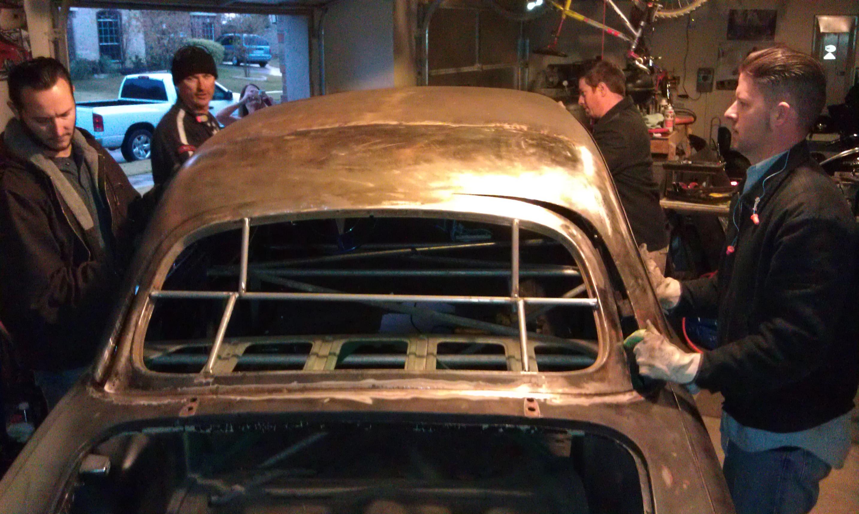

It is that time of year. We are all bringing down the garage doors and turning on the heater in the shop... With goals set for having our cars ready for the spring car shows... The Hard Luck guys and I got together to chop Hazmat's '49 Shoe Box. We started last night with all the prep work. Paint removal, cross bracing, glass removal etc...

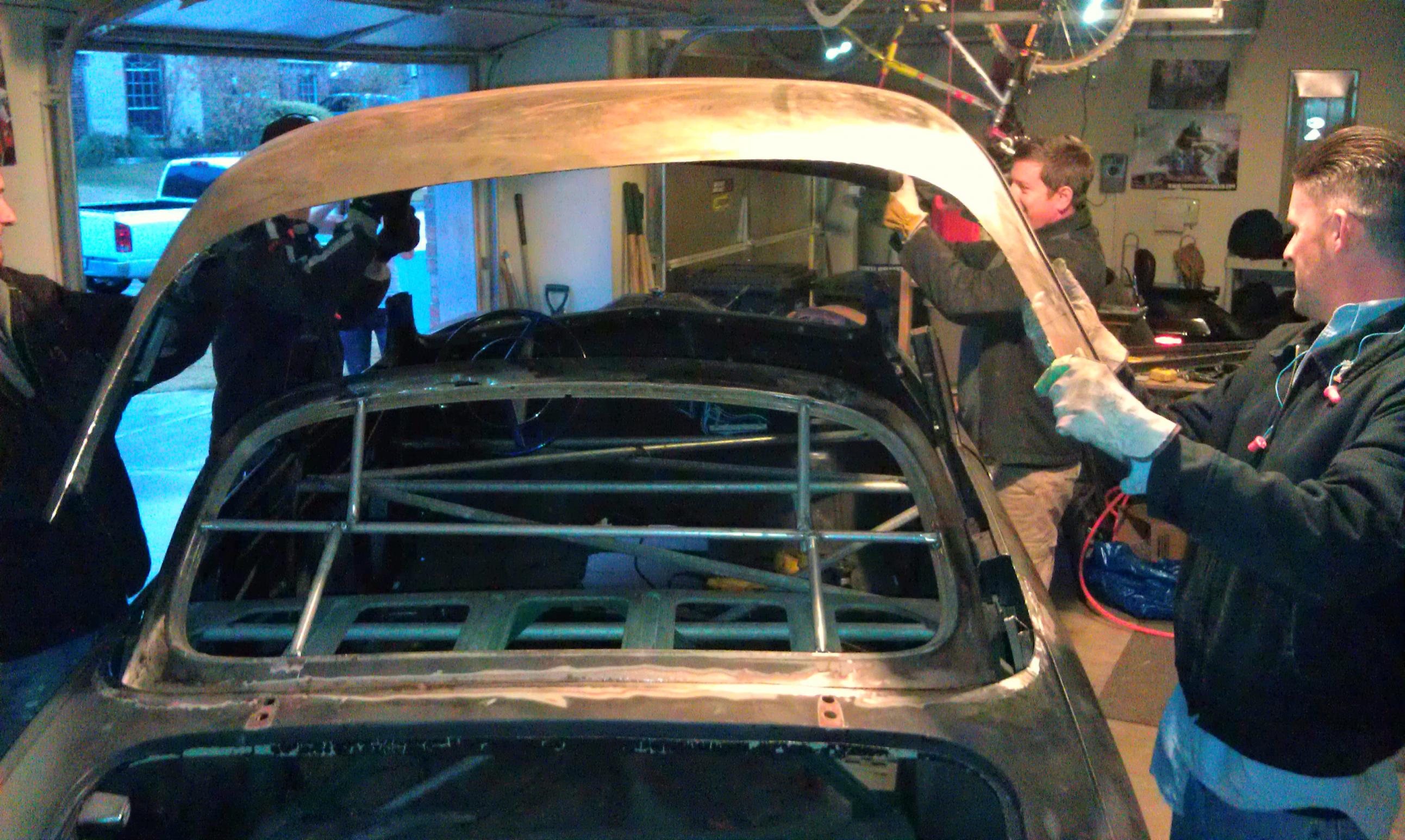

Due to work schedules, we only had a few hours to make the cuts and set the top back on. It is hard to believe how quick this part goes. About two hours from the 1st cut to this point. Very far from being done of course... We will get back on it later in the week to make get her setting in here finial resting place. Matt said "Johnny Cash in the front, Ward Cleaver in the back"

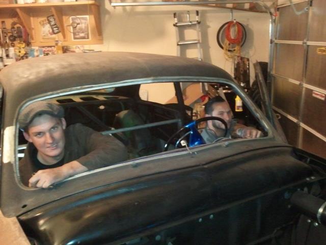

CDD, 4" in the front, 6" in the back... the pic of the sail pannel with the blue tape is sitting at 5"... this way we could "trim-to-fit"...

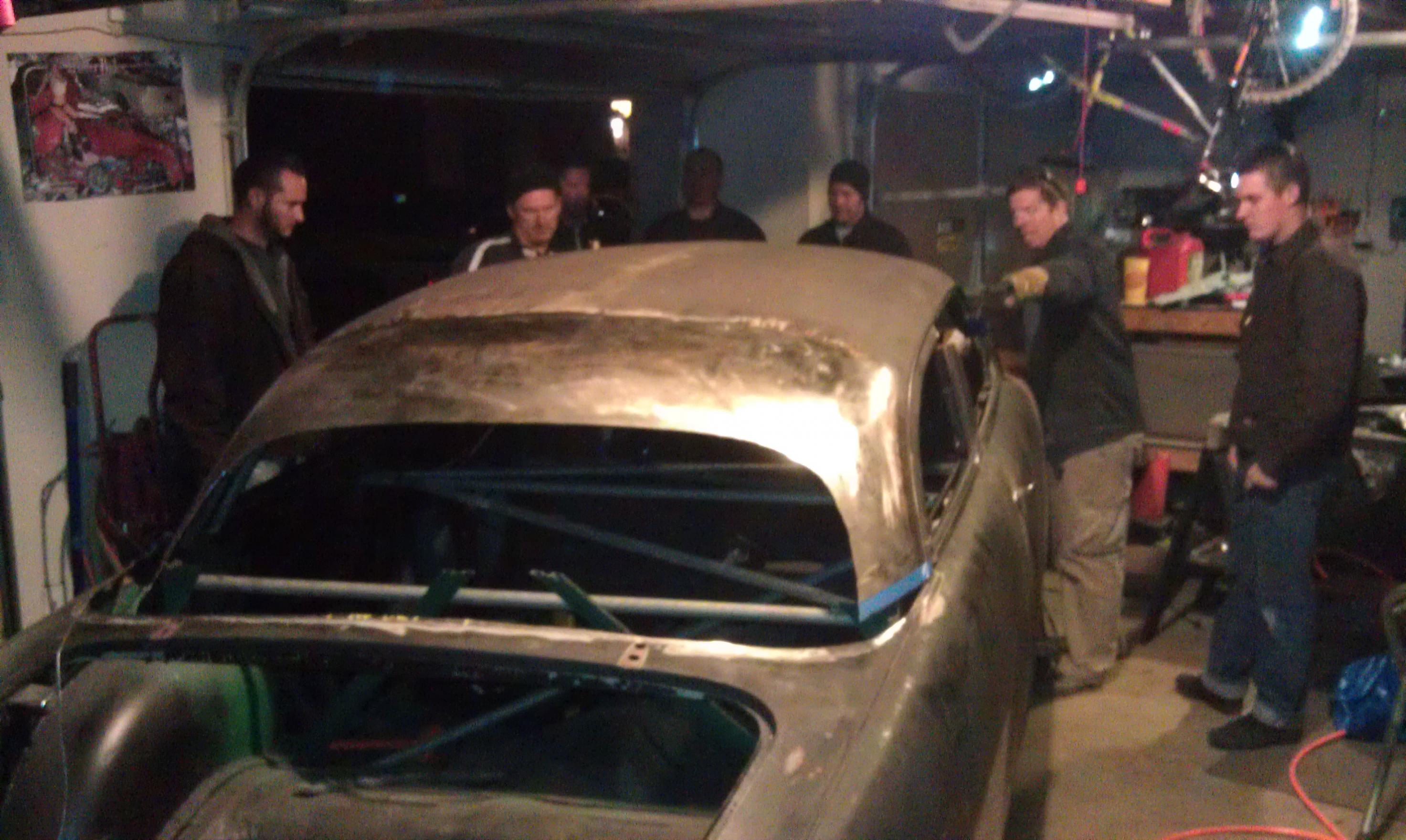

The A Pillars are tacked in place. The rear window is welded in at the top. Today starts the E-Wheel action and the sail panels...

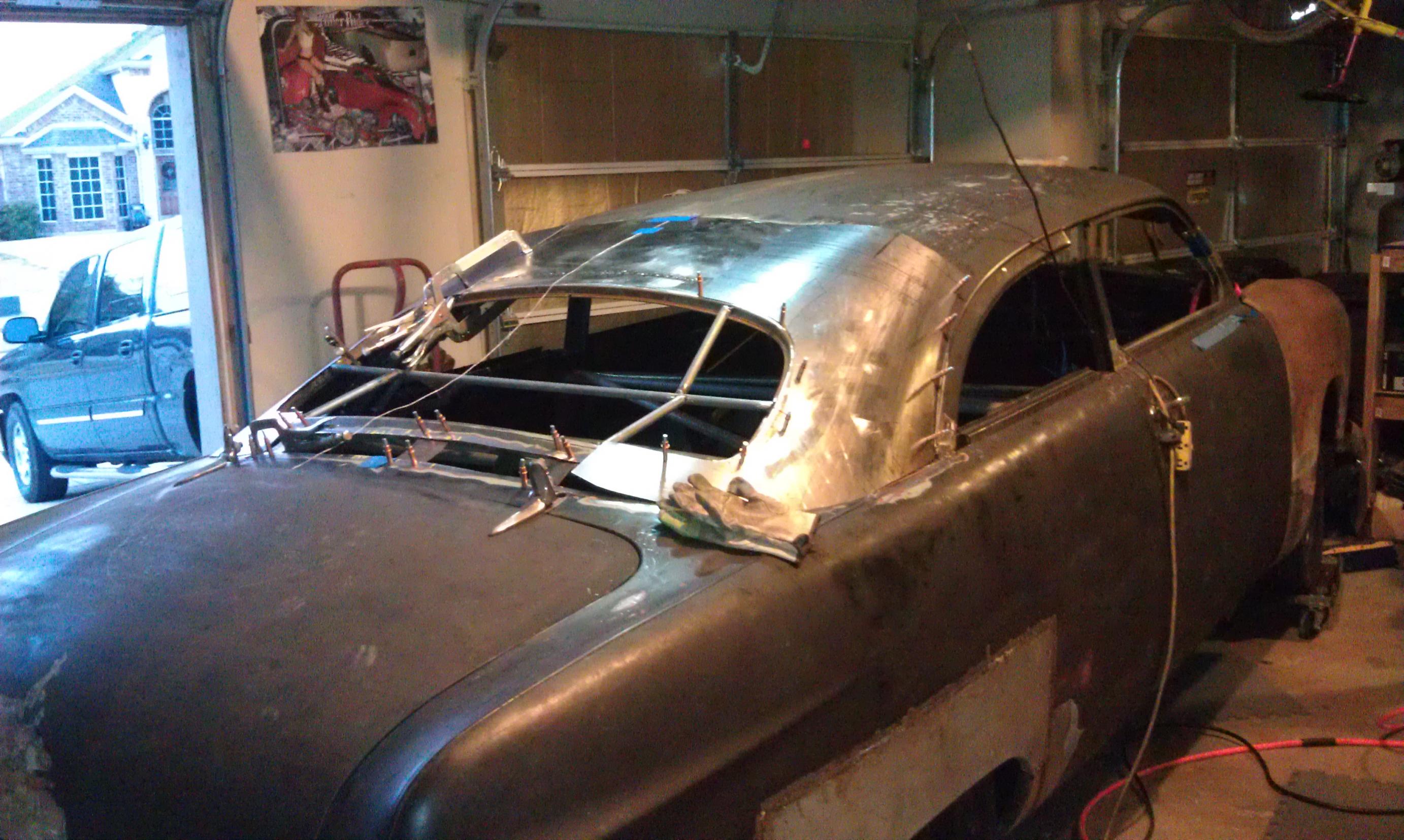

So here is an update from the weekend... Started rolling the sail panels on the E-Wheel. This is an area I wish I had more skill... It took me 3 hors on the 1st one... 30 min on the second. They are not finished, but they are getting close. I'm going to keep rolling and trimming a little at a time until both sides match.
Small Update... The holiday schedule has prevented alot of work on this one... But we are moving forward. I am off work after Christmas, so we will get to rock'n this thing... I was able to tack in the left sail panel. I had to re-make the right one... What took all day the 1st time only took 30 min the 3rd... I guess that means I learned something...

another update... This roof must have hosted dancing lessons at some point.... there are tons of dents... oil canning, highs and lows... as I started fitting the tops of the sail panels... they presented me some big challanges. Think goodness for a shrinking disk... That thing is magic! The left side B Pillar is in, along with the window corner. Right side goes in today along with the A pillars... then the doors.... I see the light...
A lot of work was done between Christmas and New Years. I had to spend a lot of time working the dents out of the roof. I can not say how much I love the shrinking disc for this! It is like metal magic! Rob (Hotrob) came over and we taclkled the doors. it was tricky to figure out how we were going to fab a new door section, but once we figured it out, it was simple... Matt, Stephan and Ricky all came over at one point or another and lent a hand too. Good times for sure! We are very close to being done. Lots of finish work left... Interior trim work etc... Rob left yesterday for his tour in Afghanistan. I was very glad to get to spend some time in the shop with him.
