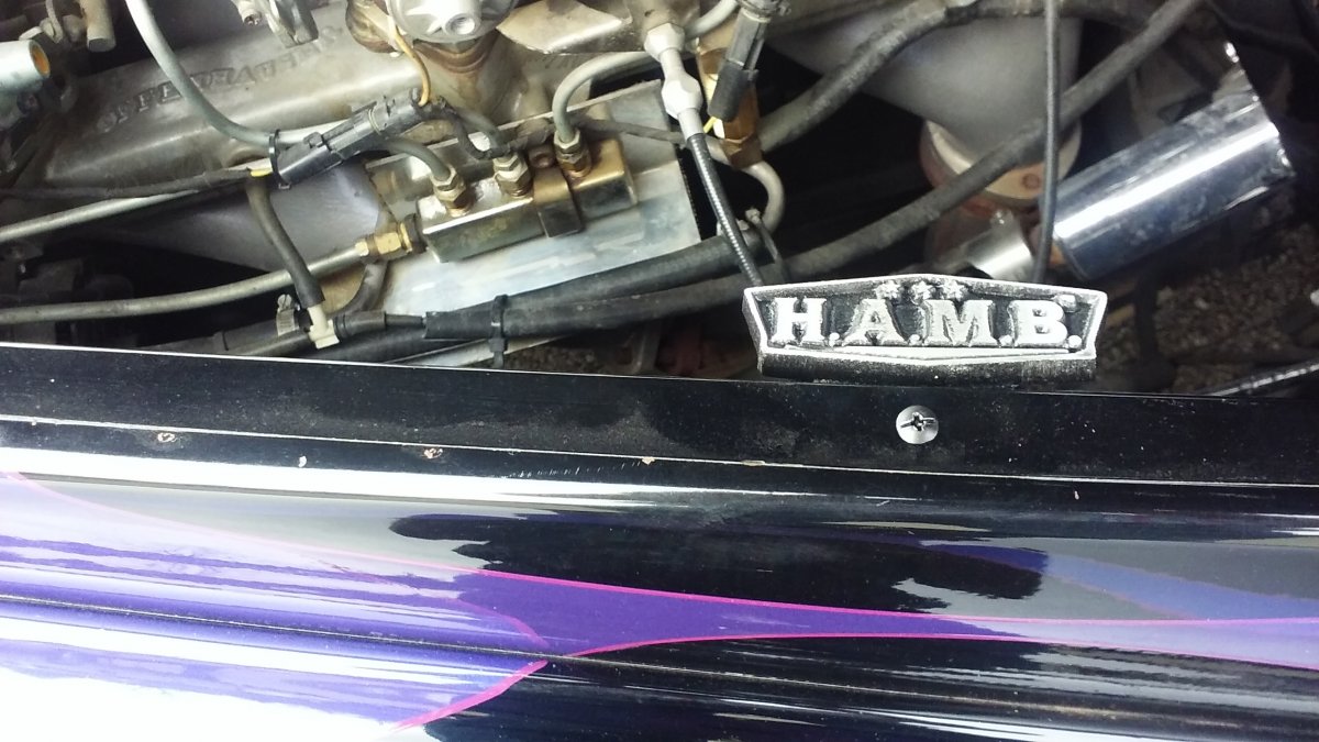

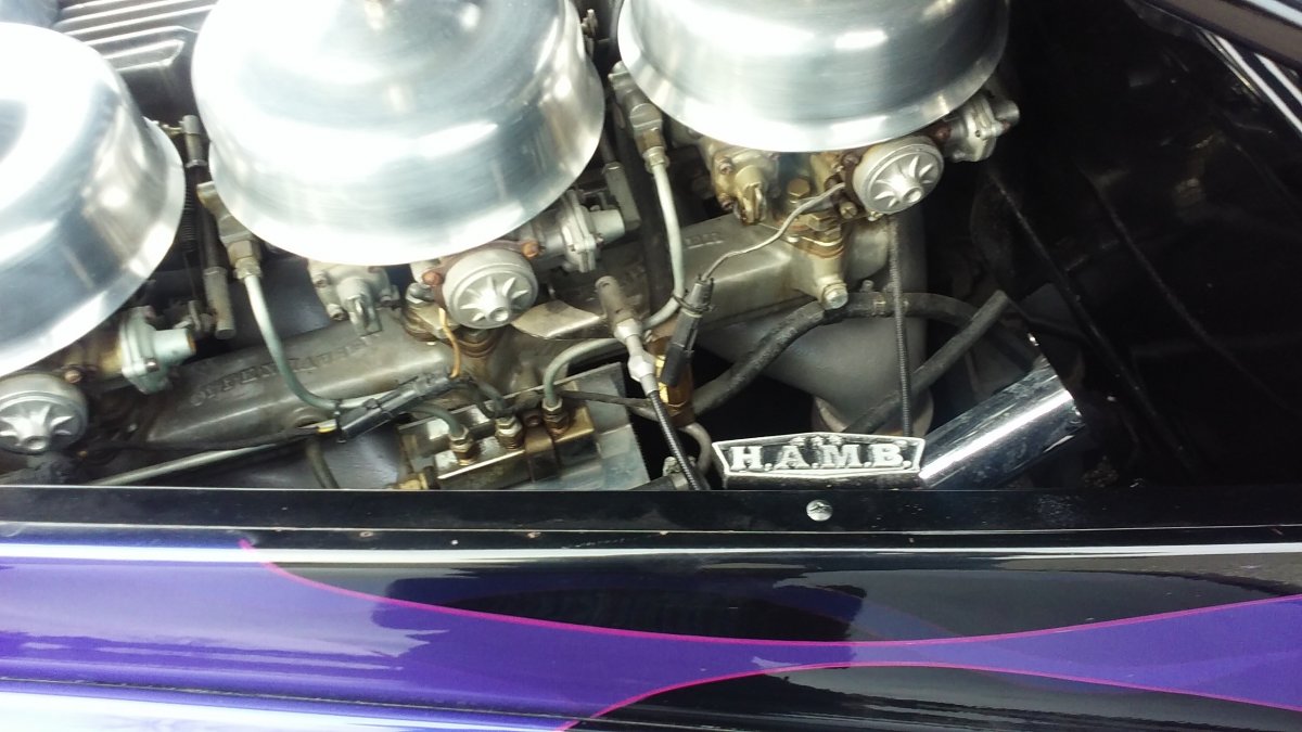

    Hamb Tag 1.jpg Hamb Tag 2.jpg I finally mounted my HAMB Tag where it can be most appreciated. Under the hood where folks can see my handiwork. A little prep, paint and a well placed hole has it firmly secured when the hood is up.
    Hope someone notices.

    It looks great!

    Did you put clear over it?? Cause I can't see it:eek:! Pete

    Front and center!!

    I LIKE how you mounted the fuel block on the intake, with all steel lines - VERY CLEAN! Looks like you're running the Holly/Weber carbs on a later six - 250 or 292? Can you offer any details on the engine, and a couple more pics??? Awesome NOT to see another SBC! :) Tim

    6-bangertim,
    Sure, It's 1970 292, bored .030, crank .010, ported, polished, 270 Wolverine cam, Langdon's Cast Header, compCams Rockers, Offey 3x1 with 2bbl adapters, 3-5200 Holley/Webers with 48's in the primary and 52's in the secondaries. Pertronics IgnitorII. Runs well, healthy 3/4 cam with great response. Gets 22mpg on highway with a T-5 and 3:55 gears.
