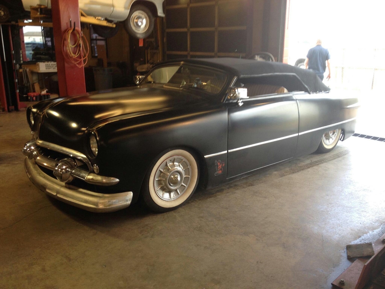

    I am third owner of this project car but its finally about finished. it started as a 1950 sedan, the roof and the B pillar were removed, and the windshield chopped and laid back and modified to accept the rag top which is from a 61 impala and has been heavily modified, i.e. chopped and sectioned frame and bows to fit the v shaped split windshield header and to try and get the right look... then came the total nightmare of getting the windows to work!!! I would never tackle this again...

    Mine was easy by comparison. Somebody in Texas started with a good 51 Victoria, had a ratty 49 or 50 convertible and used parts from that including the frame X-member to make mine. I'm the 2nd owner since the transplant & I've had it 8 years. Windows & top don't fit very well which besides not being an original convertible doesn't give me any pause about chopping it. Just have had other needy projects to try and keep on the road so this one is just what it is for now. It has an AMC Pacer front sub frame. Looks good on paper and lots have been used successfully back in the day, but they used the 51 Ford tie rods, etc. and a Jeep steering box to try and make it work. You can see where the rack was on the sub frame so don't know why they went the route they did. It almost surely handled better with the original 51 stuff under it than it does now. It is fixable but like I said, someday...! My 40 Stude has a Mustang II rack and it looks like the exact model I need for the Pacer setup and should eliminate the horrendous bump steer in it now.

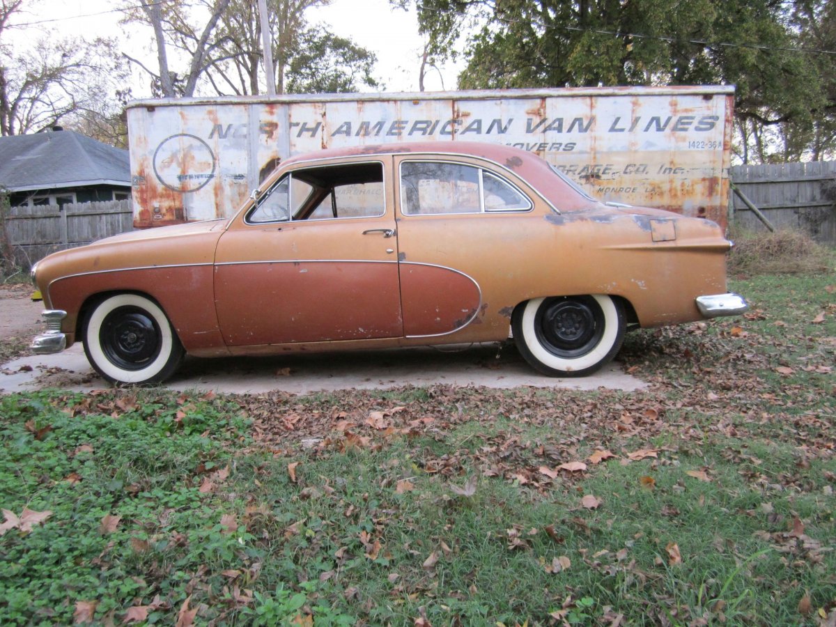

    50 crestliner.jpg I put Aerostar front springs and new shocks on my 50 and now it bottoms at very tiny bumps in the road. Any ideas why?
  27. vwdave30
    Joined: Nov 21, 2009
    Posts: 457
    vwdave30
    Maybe the wrong shocks?? I got aerostar springs on mine and it rides great
