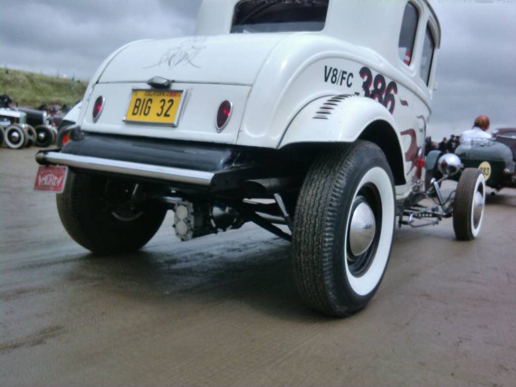

    This is how they did it on this survivor coupe I saw at pendine sands last summer. (not my car)

  24. swifty
    Joined: Dec 25, 2005
    Posts: 2,225
    swifty
    Looks like Model A spring in OG 32 rear crossmember. Might solve the problem but not keen on the fender/tire clearance/ aggressive rake which is the end result.

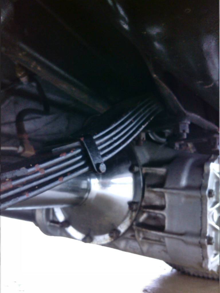

    Just a pic of a quickchange in a Columbia , I can't even remember where I got the pic let alone anything about the car ...
