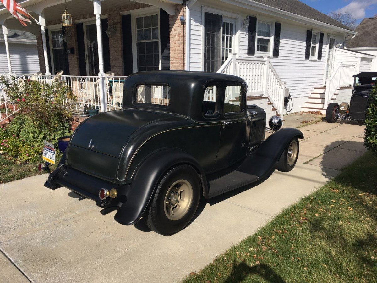

  3. Got the 32 steering box out today. Going to replace it with an F100 that Neal in CA did for me five years back. I sold the car before the box was done so the time has come to get it in the coupe.
    Made a quick steering wheel puller from a left over spring shackle p-late I had in my bracket drawer. Just had to nip the ends a bit to fit in the wheel. IMG_7494.JPG IMG_7497.JPG IMG_7498.JPG IMG_7499.JPG
    Gone!
    Just need to repaint the tube. Got scratched taking it out.

  11. Not sure mine will be that nice! I will say my 32's body and fenders are as nice as I have seen. Today I am changing the steering box to a F100. Next I will do the front axle and f&r springs. Then tires and wheels. Thanks for the remarks!

    Wow great score, Please do not cut that car. Just make her safe and hit the road. Pete Eastwood can drop an original bar for you. I won't ever cut mine either.

  17. Car sits nice, what is the suspension?

    CT, Car has So Cal 4 inch dropped axle and coil overs in rear. Still has original paint on body. Nothing has been done that can't be undone. Original Chassis is in the basement. Doors have never been off the car. Much like yours it should be just driven.
