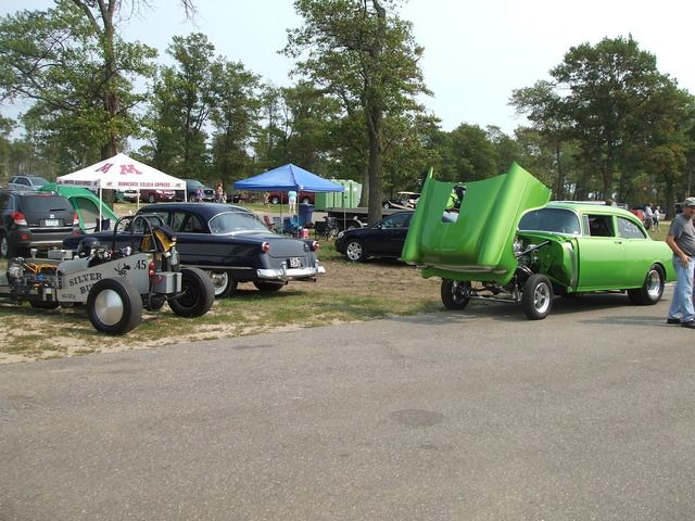

    (A pit Shot)
    Today was the Minnesota Street Rod Assn Super Secret Fun Run held at Brainerd International Raceway. It's a closed drag racing and show event for members only. I brought the dragster and also lent my Crosley to a friend to run. Weather was perfect and since the track held the NHRA event the week before, where all the nitro records were shattered, the track was very sticky. Unfortunately they ran us nostalgia cars on a pro tree, my first experience with that. Me reaction times were pitiful. I did run a best of 12.07 @114.29 and it was fun! My 60 foot time on that run wasn't good, so if I take my best 60 foot time and combine it with... well, you know how drag racers rationalize, I coulda had an 11.99 or better. Maybe next time.
