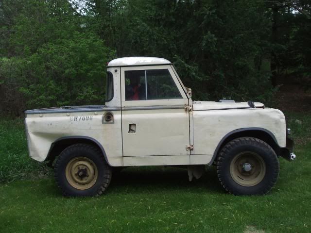

    I ran across this little orphan in a junkyard, 1965 Land Rover 88 inch wheelbase & it followed me home.
    Ir won't be 4WD when I get done with it.

    Is the Rover next winters project? Two wheel drive with a 292 & HD 4 speed? Is your pickup done? Pictures please. I'm looking forward to getting home in July so I can work on the suburban and the race car.

    88" wheelbase! That Land Rover is screaming to become an altered! :D

    I'm gonna stretch the Rover wheelbase to at least 90". Whoopee! It'll be a regular driver. It goes into storage til winter. Sorry it won't become an Altered. I've got too many race cars now and I hardly ever race.
