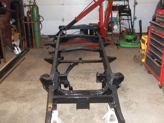

    Since the HA/GR forum is pretty quiet lately, I took the liberty of doing this: The chassis for my '40 Plymouth tow vehicle is pretty well done. The cab is in epoxy primer and I am now doing the minimal body work that it needs. For a Minnesota truck, the cab is very nice.

    Good looking truck...looking forward to seeing it come together.

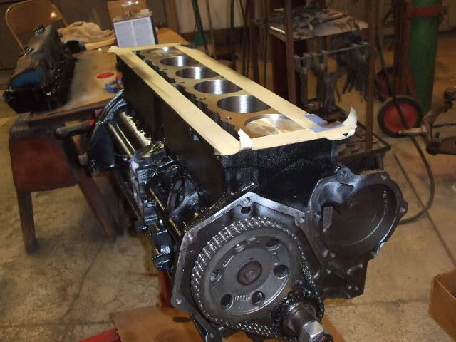

    Picked up my slantie block and head after only a year at the machine shop. It is looking real good. This isn't a race engine build but it got pretty involved anyhow. Turned crank, standard bore but honed for clearance, deck cut .100", ported oil galleries, new stock bore cheap cast pistons, reconditioned rods w/ARP bolts, ported oil pump with hardened gear, reground cam, Cloyes matched timing set, and so on.

    The head is cut .050", oversize (but not very special) valves, new guides, pocket ported, 340 Mopar valve springs. I'll port match.
    With the block decked and the head milled I'll have to check for valve/piston clearance and pushrod length.
    Will probably change from the 2 Holley 1bbls to a pair of 2 throat BBD's.

    I started with a cast crank engine that was in very good shape. Had the crank turned 10-10. The block and head were baked and tumbled in stainless steel shot. I put the main bearing shells in the block and set the crank in place. It was "sticky" and didn't turn well. Finished assembling the mains and torqued the bolts. It turned over very hard even though it Plasticgauged at .0015". As you can see by the pic there is a very tight fit at the parting line (shiny spots. I filed a slight chamfer on the bearings and the block and caps at the parting line. Also used a scotchbright pad on the backs of the bearing shells and the block and caps. After that, the crank turned with an acceptable amount of force. Still, I'm concerned about the fit and will have the crank ground to provide .0025" clearance, which is the spec limit for a slantie.
    Looking for insight as to the cause of this problem and if you think .0025" is not enough, too much or just right. I'm thinking it is poorly manufactured bearings and possibly a little peening over of the block and caps parting line edge while in the shot tumbler.

    Got the slantie crank back with another half a thou polished off the mains. Won't be putting the new engine together until after this drag season. Since I'll have all winter the trans will get some attention too. Hope to be ready with tow truck, trailer and HA/GRa all set at the start of the 2012 season.
    Old28, I can't answer your clearance question yet, but I will. The cam is very mild with .465 gross lift. I need to start with a mild engine as they are easier to tune. With experience I'll hopefully be able to add more beans and go quicker.

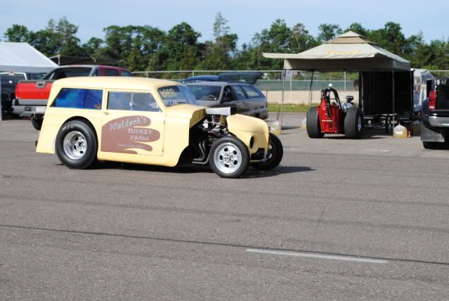

    hoffbug, Since the dragster is still apart, I took the Crosley to Brainerd this weekend for free drag racing courtesy of the Minnesota Street Rod Association. Were you there?

    Hey Bob...great substitute if the dragster isn't running. Always loved those Crosleys.

    NO... Im not a MSRA member since everything I own right now is 1972 or newer.. The Crosley looks sweet though.. Im currently working on swapping out brakes and spindles on the Chevelle.. hope to hit the rock in October to test it out..

    Tom, The Crosley went 11 flat. The problem is I have limited it to 5,000rpm so I end up feathering the throttle for the second 1/8th mile. For several weeks I was prepared to run the car (strip open every two weeks) but various problems (sick dog, I hurt my leg, wife having surgery) kept me away from the track. With the new red line of 6,000rpm I was expecting 10.60's. Then there's the trans brake I've never used...

    Got most of the welding done on the front suspension and the steering on Monday and need to make the aluminum pitman arm and the steering drag link and the car should be a steerable roller soon.

    The front end will be lowered 3". I made a well perforated front crossmember. It will be positioned back a bit from the existing crossmember in order to clear the tie rod. A new suicide mount will have a bit longer reach. The uncut '34 Ford wishbone which is only 3" above the floor at the ball end will be replaced with home made split bones.
