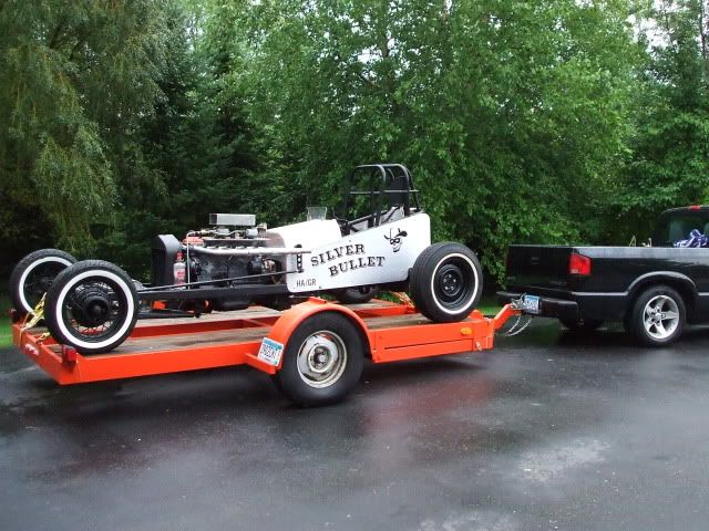

    The trailer you see, I built last year and sized it for my Crosley. The dragster just barely fit. First I loaded it front first but had no tongue weight. It pulled like a dream with my S-10 though.

    I had to put the car on the trailer rear end first. The side panels caught too much air while towing so I stopped and added the "racer" tape. I doubt there would be a problem racing. I'll add some angle brackets to stop the flapping.

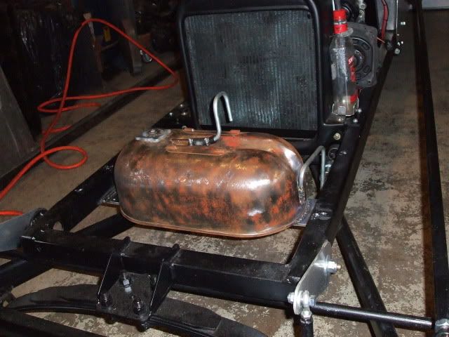

    1. Using Model T rails added a lot of work compared to using rectangular tubing. And, it doesn't look much different.
    2. My gas tank is too heavy, took too long to build and has started to leak. I really wanted a Moon style tank but was too cheap.
    3. I would taper the frame rails from the engine forward. Just for asthetics.
    4. If I wouldn't have had a 9" Ford rear end at hand, I would have found a lighter, narrower rear.
    5. I don't like the looks of the Holley electric fuel pump, nor the way I plumbed it. I can't use a stock pump because of frame rail interference. Will probably get an in-line electric pump and hide it.
    6. I'd like a "do over" on the scatter shield. If it wasn't so much work, I'd make a nicer looking one.
    7. Last, but probably the most important is making the decision about the very nature of the build. Did I want to build faithful rendition of a 50's vintage dragster or did I want a dragster that resembled those of the 50's but was modern enough to be fast, quick, reliable and consistent, while still adhering to the HA/GR rules (except as trumped by NHRA rules)?

    I want to thank Dick (Thingy M) for the idea of using a Ford truck heater fan motor to drive a water pump. Just finished it today and I'm hoping it saves a horsepower or two so I can go a bit faster next week.
    Also, put a "lift it up" strap on the gas pedal and finished the new gas tank, fuel pump and tank vent tube (not the vent tube seen above).
