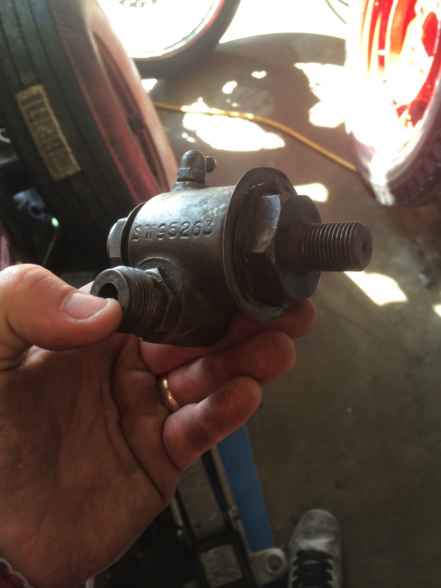

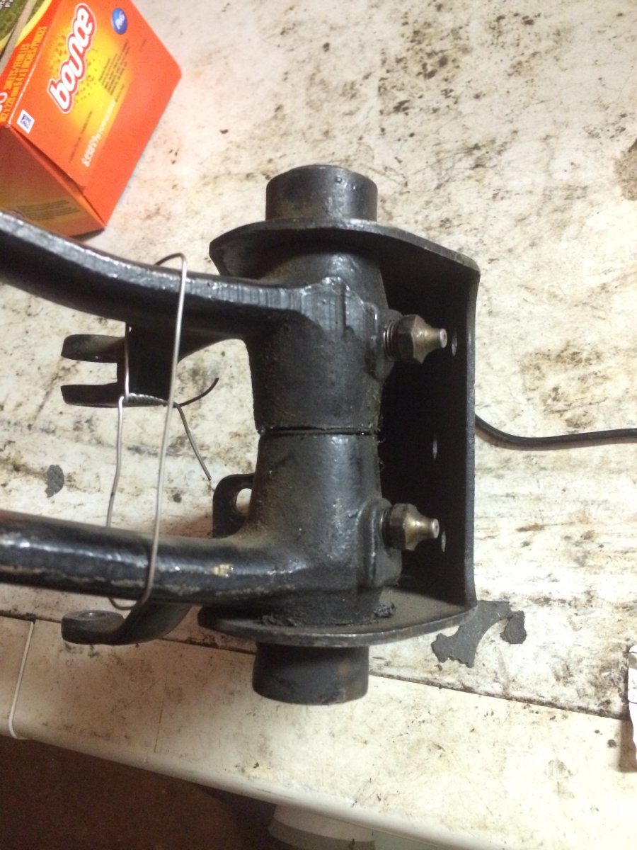

  7. Uhhhhh Ohhhhh . . . . those zerk fittings on your spindles are not '32 correct' . . . you better swap them out! LOL (and just try to get grease into the originals with your nice modern grease gun . . . NOT!). I figure you have at least one more solid day of work - but you're getting there!
    ghornbostel likes this.
  8. Funny you say that dale. That's why I painted over them. I got my real 32 zerk fittings I rebuilt. I showed how to rebuild original zerk fittings back some time ago. Those will be changed out as soon as I'm ready to lube up the chassis. My grandpa also gave all his grease guns from his racing days so I got that covered too..... :)

  10. Oh Noooooo! I went back and looked at your '32 Zerk Fitting' rebuild post . . . and I hate to inform you, that you definitely have issues! :eek:
    I've checked with the official '1932 Vintage Hotrod and Horseshit Society' and you are NOT compliant - as a matter of fact, your particular 'Zerks' . . . are imposters for the real deal. When I attempted to pass off similar 'repop' zerks . . . they told me that my particular ones are known as 'Jerk Fittings' . . . and that I was a helpless Twerker for trying to slide these inferior OEM parts or later replacements as the 'real 32 deal'. Miley Cyrus - ain't got nottin on me baby! o_O
    So . . . in the interest of ensuring that you have ONLY the correct vintage 32 parts on Hypersonic (to make Gramps proud of you!) . . . I went on a 'Jerk Looking for Zerks Snipe Hunt' in my own garage . . . you will experience the REAL qwerk of the Zerk in the following video . . .
    I hope you enjoy my stupidity . . . cause I enjoyed making it! LOL

  11. Now that is funny shit. You are one hell of a hunter.:D
  12. The zerk fitting I rebuilt was for instructional purposes only. No real 32 zerk was harmed in the process. They are like gold so must be handed very carefully.

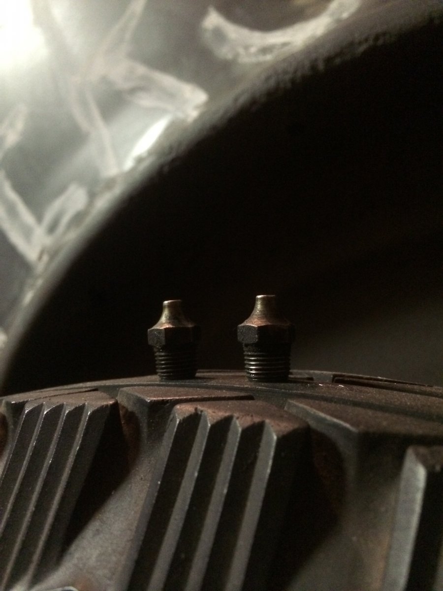

  13. image.jpg image.jpg Dale if you look real close you can see that your my number one fan.:D And yes I got real "32" zerks. Come on now I can't show all the holy grail stuff. Guys are already hating me. Now I got to rub some more holy parts in their faces. Its just 32 space junk floating all around my garage. Zero gravity

  15. image.jpg Shhhhhh!!!I found some more on a junk set of 32 pedals. I got the Midas touch.
  16. Holy Crap Bruce . . . your Zerk Fitting hunt has uncovered the most elusive of gennie 32 parts! LOL I loved your picture with the 'bird' in it - too funny. See - now I just screwed with your mind so you'll be looking for original 32 Zerks from now on -- imagine how much of your time I've now begun to waste! I bet you'll have those period correct zerks on your 32 front-end in no time. LOL Hypersoooooooooooooooonic Baby

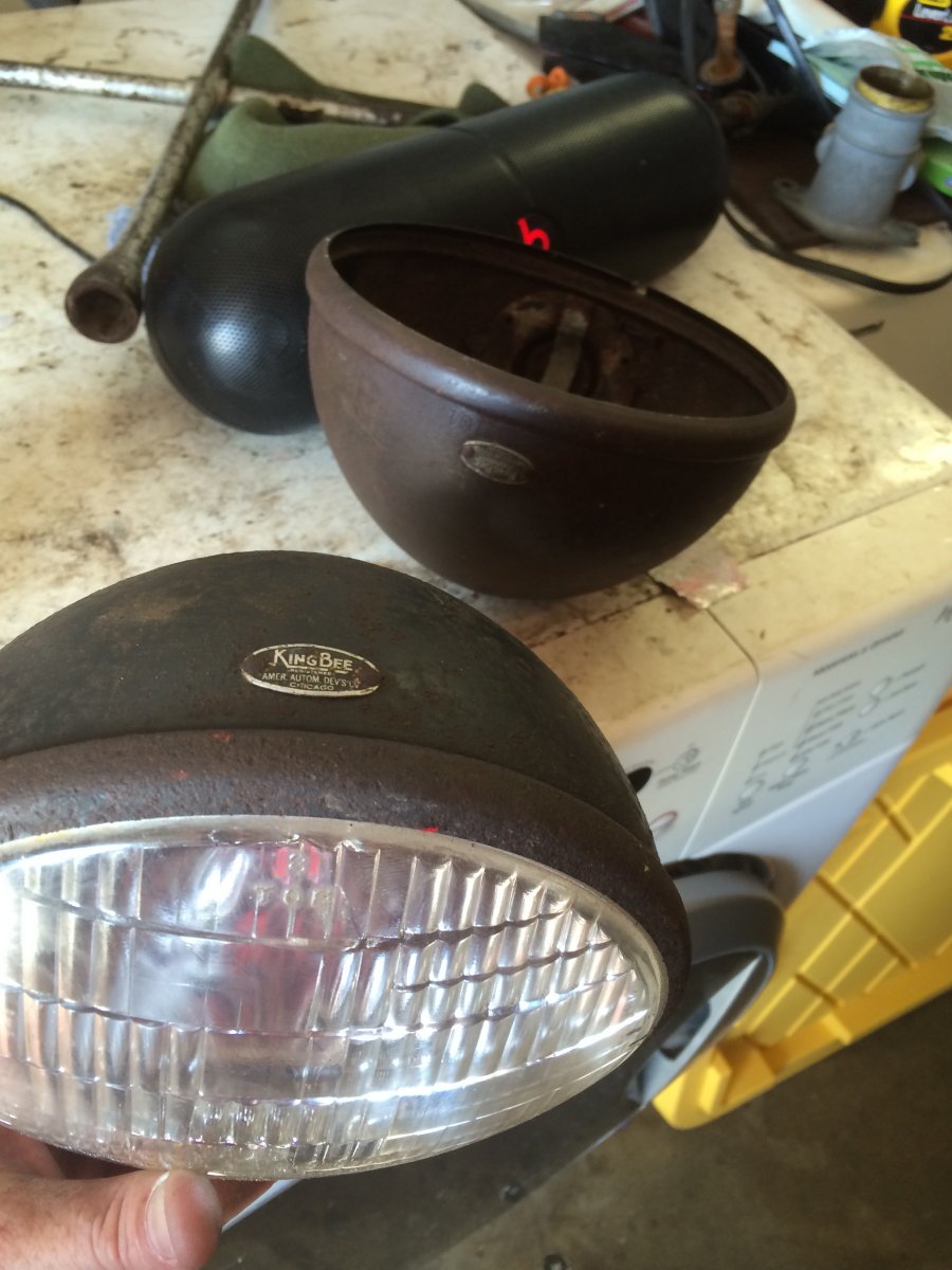

  26. image.jpg image.jpg image.jpg Went down to my early ford parts guy today and did some horse trading on a couple of intakes, for a set of king bees a stewert Warner bolt through tack drive and some kick ass tires. The tack drive needs no bracket it bolts to the crank and is on bearings so the cable holds it flat. Hell ya this is what hotrodding is all about, finding the cool rare of rare shit.
  27. Well I took apart the tack drive to clean it up and it's not bearings it's just bushings in both sides. Must keep it lubed good.

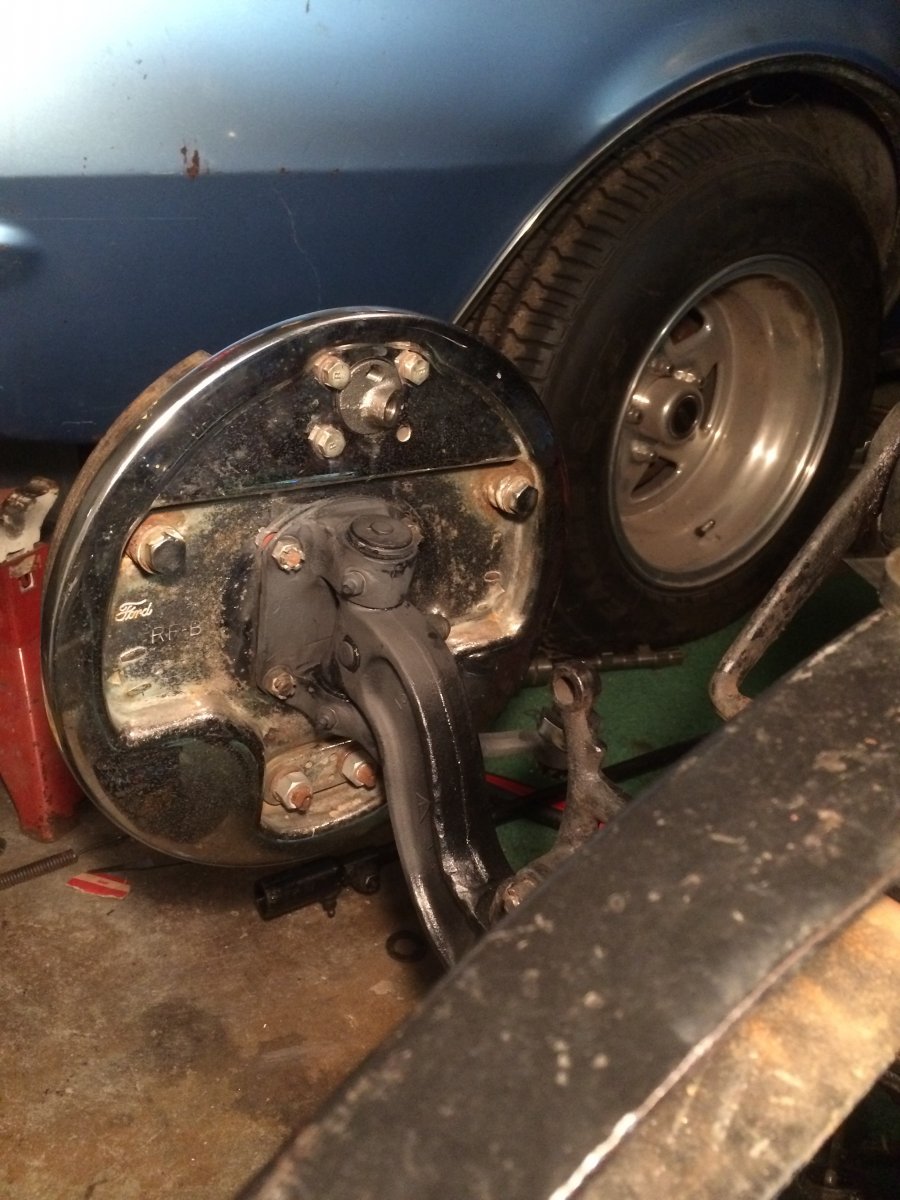

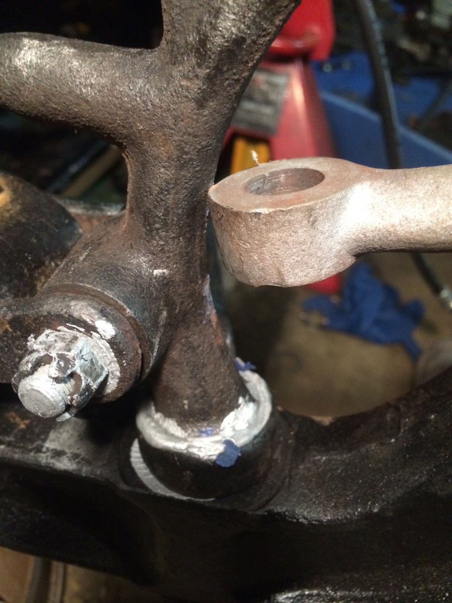

  28. image.jpg More set backs. Looks like joe didn't bend my spindles to the correct position. Steering arm hits perch pin and the steering link hits the wish bone in both sides. Now I have to heat and bend them myself after paying him to bend to fit the axel. Yep eeeeeeee!!!

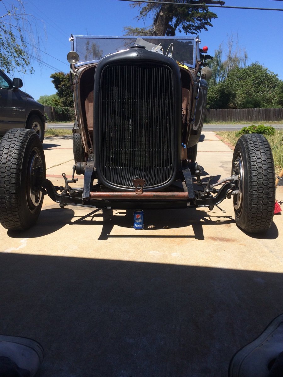

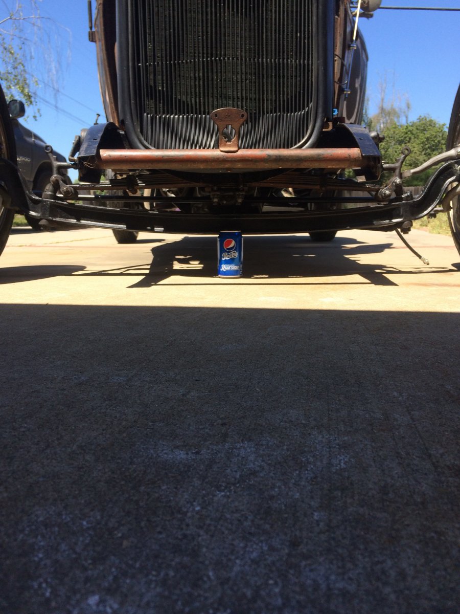

  30. image.jpg image.jpg Damn she's low. I can slide a Pepsi can under the front axel.
