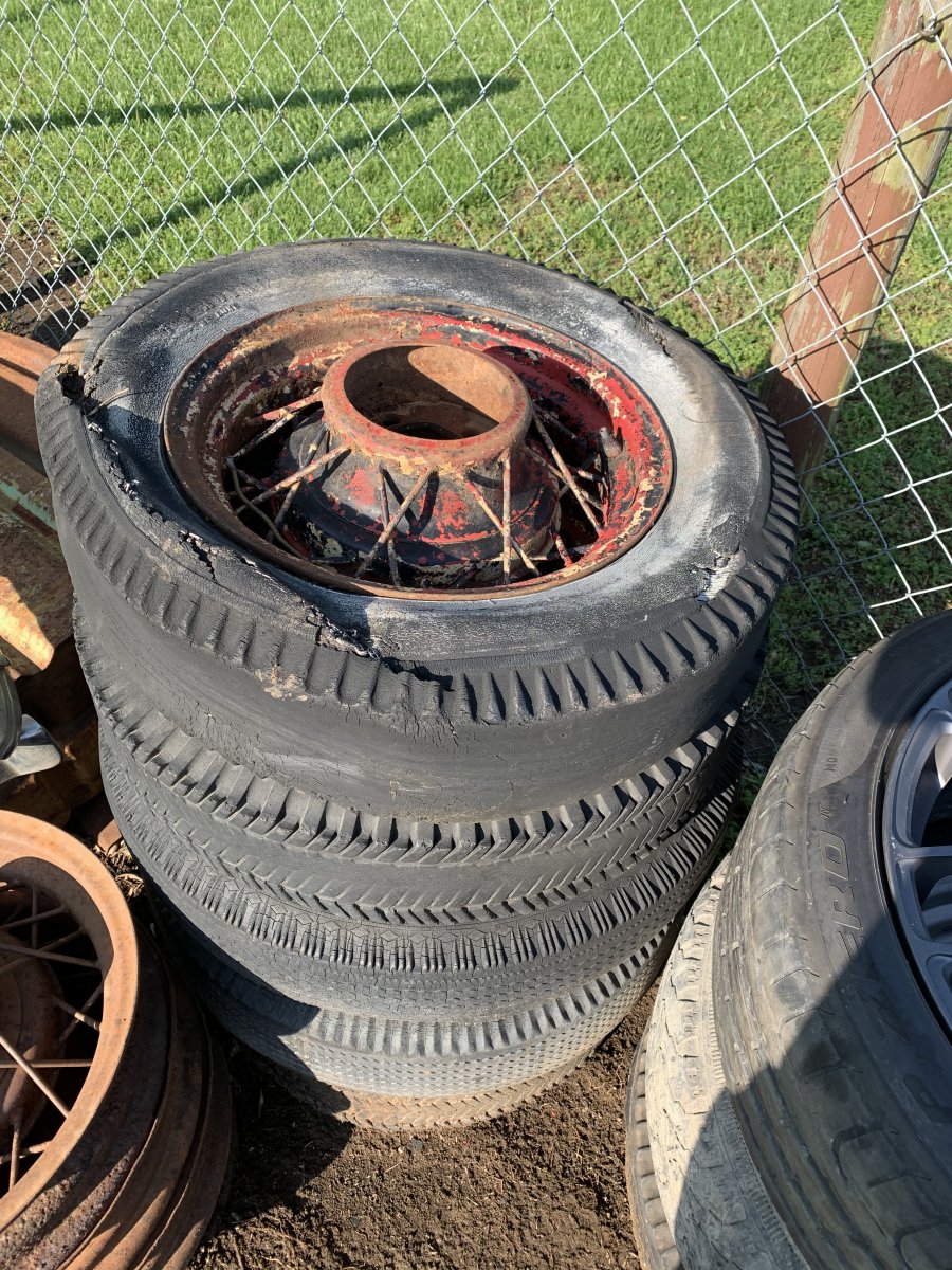

  17. Those wheels should work fine. I would suggest pulling the tires and spinning to rims to check for out of round and run out. They look solid but if there is a problem, you will have time to find some more wheels. If you are going to keep the 4 cylinder I like the 1932-34 4 cylinder hub caps.

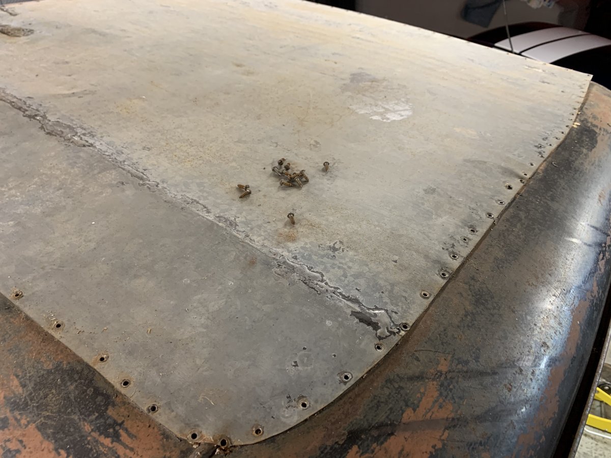

    Someone did a nice job tarring and screwing a piece of galvanized to the roof.
    Lots and lots of screws...
