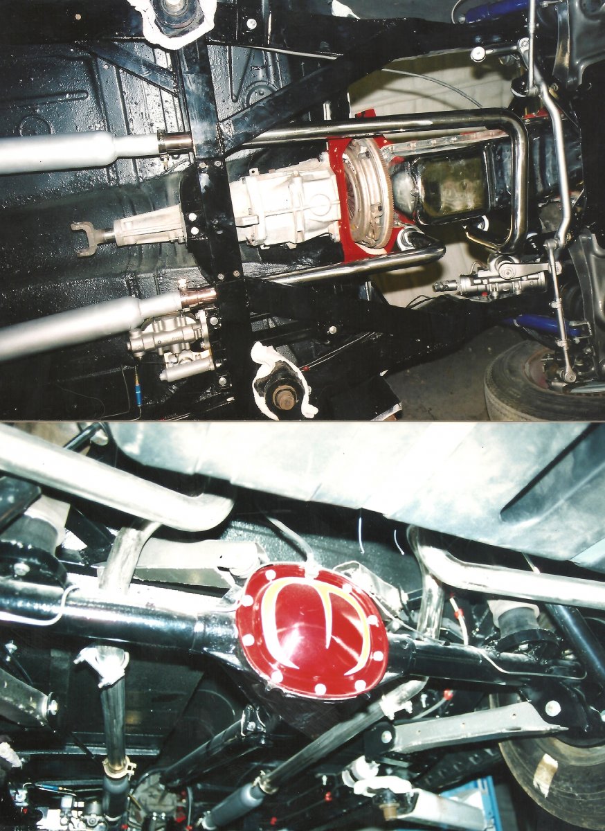

    1. Kustom Painters
    Put one in my 47 Chevy. I left the stock trailing arms on it, and made brackets off the frame to support it, and the springs. Mainly did this so I could run bags and get more lift from them. Easy to do, but the upper mount/spring support crossmember takes up a lot of trunk space. I boxed and internally beefed up the arms, as well. The only thing I probably need to do is make up new uppers, so I can set the proper pinion angle when it is at ride height. Chevybuild 014.jpg
