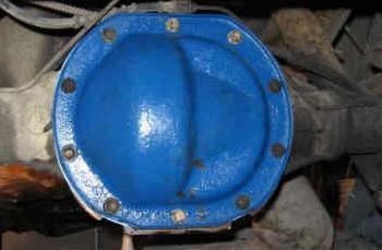

    I'm looking at getting an 8.8 from a 70s Granada. Chances are, for what the price I'm paying for it, it might need a rebuild, and has pretty lame gears. Are Ford 8.8 internals interchangeable?
  2. Hnstray
    Joined: Aug 23, 2009
    Posts: 12,355
    Hnstray
    from Quincy, IL
    I doubt you will find an 8.8 in a Granada, unless it was swapped in. Granada’s used 8” and 9” Ford axles (and possibly a 7.5”) depending on equipment packages/power train.
    Both 8” and 9” are drop out center sections. Both are relatively easy to work on and parts are available. Ratios are likely to be 2.79, 3.00, 3.25 range. Stock 8” with lower (higher numerically) for 8” are not common, though aftermarket ring and pinions are available. 9” had more lower ratios in stock applications and plenty of aftermarket choices too.
    The 8.8” and 7.5” are integral carrier designs, like a GM 10 or 12 bolt style axles and have ‘C’ clip axle retention.

  6. Hnstray
    Posts: 12,355
    Hnstray
    from Quincy, IL
    I believe you will find that is a 7.5” axle, very similar in appearance to the 8.8” but dimensionally different. The tag should clarify both the axle model and the ratio.
    In my opinion, the 7.5” is a decent axle for moderate use, though not as tough as as 8.8”
    If it turns out to be an 8.8”, please report back and post a pic of the tag. I will have to correct/update my mental files! o_O

  9. AldeanFan
    Joined: Dec 12, 2014
    Posts: 894
    AldeanFan
    That looks like a 7.5 to me.
    Basically a smaller version of the 8.8.
    I have one from a ranger with 3.45 gears that will be going in my ‘54 wagon one day.
    I abused the hell out of an 8.8 with 373 gears in high school.
    Asking as you don’t try to put down Big power with sticker tires you’ll be fine.
    As far as I know all 7.5 gears will interchange.
    Factory ratios included 308, 345 355 373 and 410, and Both open and traclock was available.
    The 8.8 is stronger and more often came with a traclock but not needed for most cars.

  11. mgtstumpy
    Joined: Jul 20, 2006
    Posts: 9,214
    mgtstumpy
  12. I think you are right. I was sold a 7.5" on the basis it was an 8.8. It was a genuine mistake. I only found out when the Offenhauser diff cover didn't fit.

  14. BamaMav
    Joined: Jun 19, 2011
    Posts: 6,744
    BamaMav
    from Berry, AL
    There is also another possibility--Ford had an odd 7.1" or something like that under some 75-78 Granadas. It looks a lot like a 7.5 or 8.8, but from what I have read nothing interchanges between them, and parts are extremely hard to find. I bought a rolled over 77 Granada with a 351W in it for the engine and it had that odd sized rear. It was normal 5 on 4.5" bolt pattern and had stood up behind that 351W, but I doubt it had been dogged much before it was rolled over.
  15. dumprat
    Joined: Dec 27, 2006
    Posts: 3,485
    dumprat
    from b.c.
    Doesn't look like an 8.8. Look at the shape of the housing just ahead of the cover. It has a tubular barrel shape and the pinion is quite short.
    An 8.8 out of a ranger pick up or explorer will be a much better axle and can be had cheap. 8.8 axles are like Lego and most everything fits without much work. There is no carrier break and if you make a solid shim instead of the stupid crush sleeve they will take a lot of abuse.
