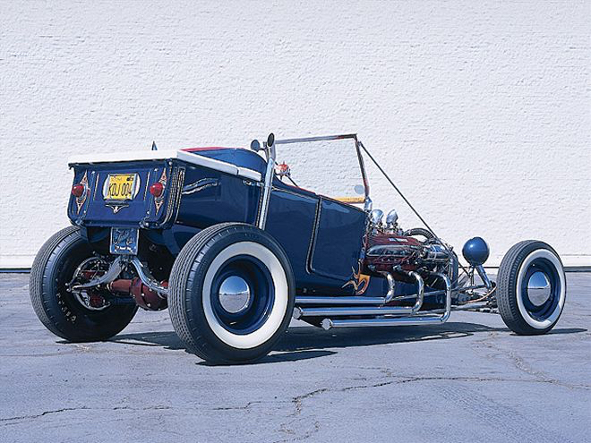

  1. Im looking for some details on Norms T such as its wheelbase,
    if it was channeled and if so how much,
    how the hell he got the rear end of the car so high up,
    and wheel and tire sizes.

    I would be surprised if Von Franko refused to help you. He sure bugged Grabowski a lot when he was building his Klone. You need to get the Bible's Car Craft April and August 1957. I see them on ebay all the time. The wheelbase was/is 96" on the Kookie Kar version according to the mag. The early Lightnin Bug version I'm sure was 101" because it had an early diff. with the spring right over the axle. He jacked up the back with a steel plate he made. Probably channelled 3or 4 inches in front. I've been told the April '57 Car Craft pictures are almost a perfect 1/32"to one.

  7. Okay i did some research, The replica has a 98" wheelbase. It uses a Model A frame, Z'd stock Model A rear crossmember, custom round tube suicide front crossmember, bulldog perch, and a spacer for the rake
    I wonder how the T body fit on the Model A frame. and exactly what the spacers were
  8. Is it possible to get that kind of rake from a T Chassis?
  9. Hey Steel,, any pics of your bucket and how you got the stance? Not as tall as Norm's but it sure is sitting high in the rear!!

    http://www.hotrod.com/cars/featured/1005sr-1922-ford-t-bucket/
  17. Anyone else have hard facts or a how to of sorts to get the rear of a T up so high? ImageUploadedByH.A.M.B.1424313653.915276.jpg

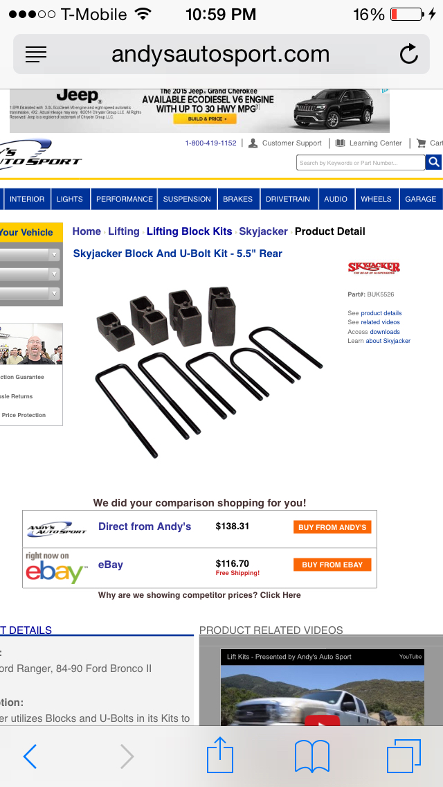

    That club plaque is hiding a huge lift block like used by off roaders with really long U bolts.

  22. Do you mean something like this?
    Obviously this if for a late model pickup but mabye it can be adapted
    Where would this mount on a bucket anyways?

    same idea but norm-made and I think chromed. memory is going....

    Greetings! Manny, stop spinning your wheels and get in contact with Johnnie at "Reno Rod Shop" ([email protected] ) (405) 813-1932. Johnnie spent a lot of time and money collecting resource materials in order to get the details right. As for the spacer on the rear end, it's just a big chromed loop of steel...
    Ed Frazier likes this.
  27. Wow so that spacer was bracketed between what looks to be the high arch leafspring and frame? Do do you know the height of that spacer? Thanks for the help.
