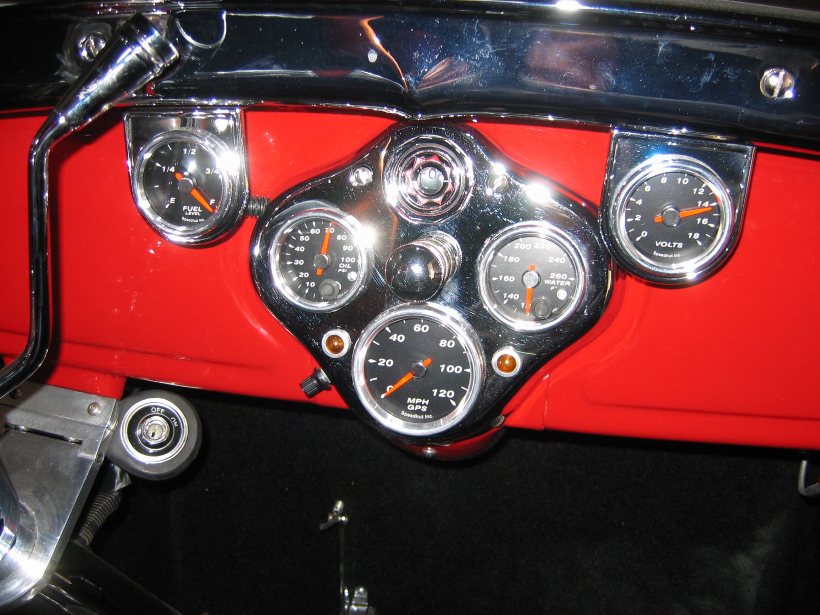

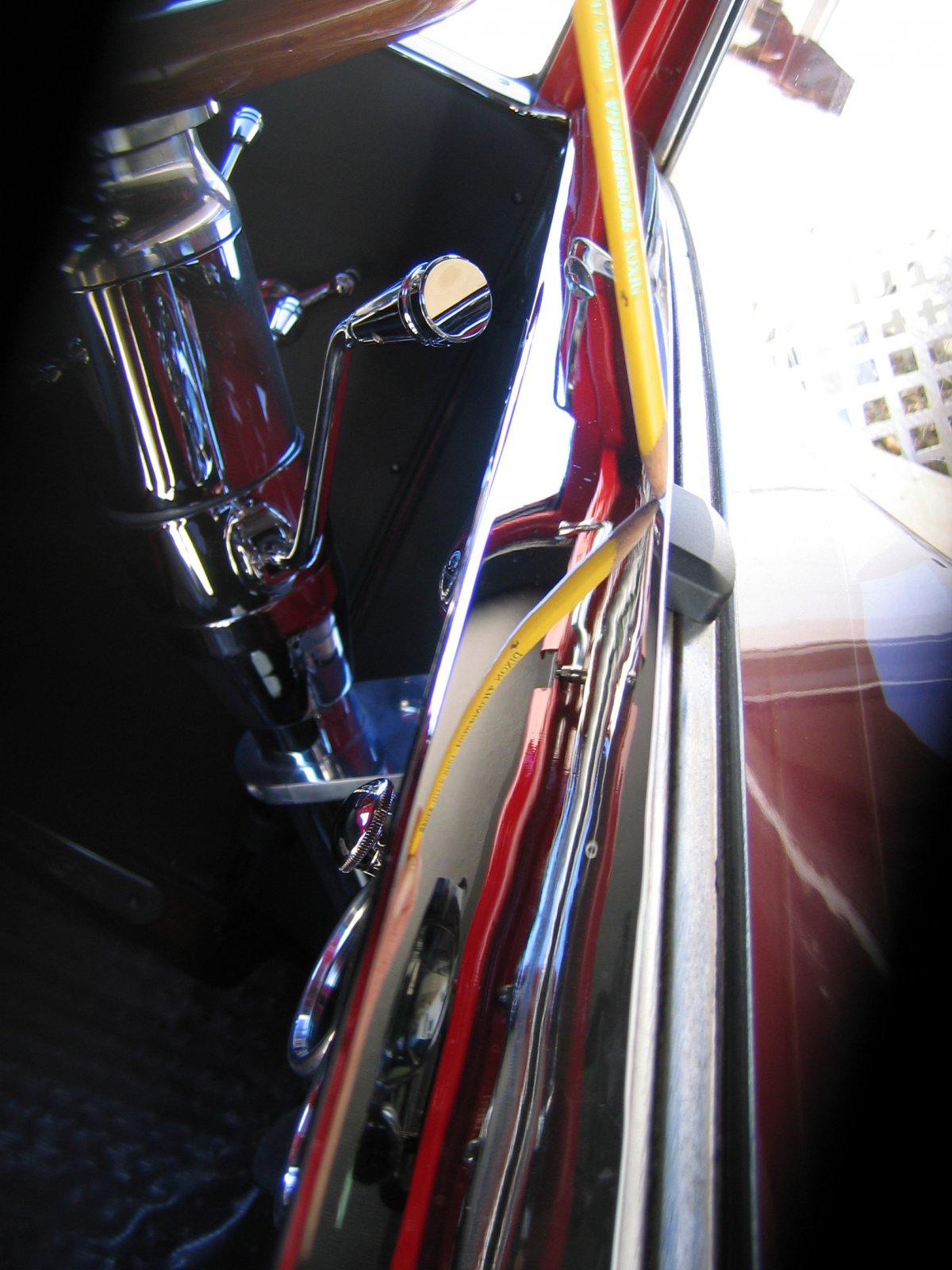

  10. Dave Mc
    Joined: Mar 8, 2011
    Posts: 2,624
    Dave Mc
    Put one in my 29 Like it a lot, Sensor is magnetic, mounted it on lip of w/shield frame.Speedhut Gauges and speedo
