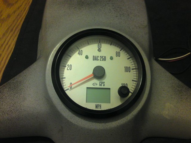

  24. I'm runnin' a SpeedHut GPS driven speedo with no problems-
    Here's the pick up antennea thingy stuck to the speaker/defroster grille:
    Tells ya' time, direction of travel, alttitude, 0-60 time n' distance, 1/4 mile time, top speed recall and it's gotta' odometer, too.
    More info here:
    http://www.jalopyjournal.com/forum/showthread.php?t=708609
