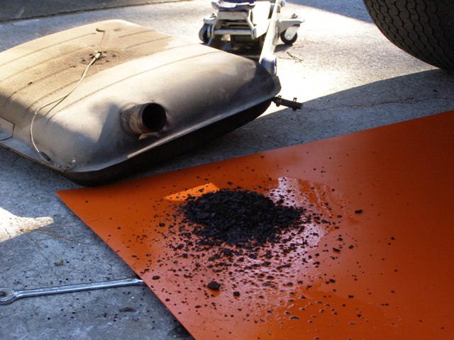

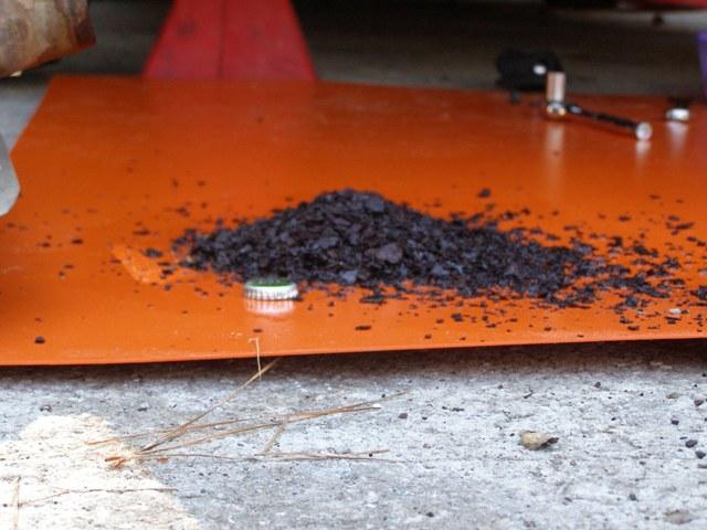

  1. So I have been having a problem going for short cruize's lately. I run a few miles and she dies, I pull over, wait a few minutes and she starts and runns again for a while. SOO I decide to drop the tank and get a look at what I think is the problem an LOOK AT THIS SHIT!!! The small thing in the picture is a beer bottle cap! I poured more than a cup of that crap out with the first dump, then flushed I dont know how much shit out with the garden hose. The ten foot piece of 5/8" chain I put in came out caked full of the same shit only in sludge form two times. I finally got it to flush clean.
    I have searched all the cures, but I am concerned with this amount of crap. I am taking it to the radiator man in the morning for a tanking or should i concider an aftermarket tank and scrap the old one? It seems solid from the outside.

    radiator shop and por 15 tank sealer.

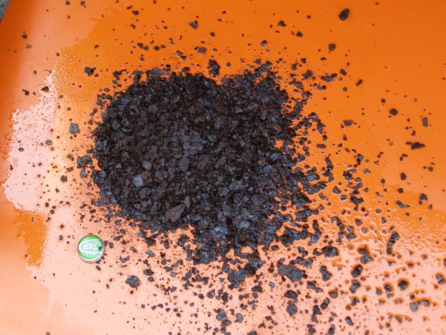

  3. Shit, if that is a ShinerBock cap it aint mine!
  4. i had a gas tank like that. i put a handful of screws in it with some dish soap. shook it for an hour, rinsed it out, let it dry and got 4 more years out of it.

    Seen worse, Bill Hersche sealer and ride.
  6. TMAN I was wondering how that fucking thing got in there, or who did it! This problem DID start at the HAMB drags. The danm thing died on the way to the track from the hotel-motel. Had to load her up on the side of the road and when I got there,BAM, the danm thing started!!!
    The old car had sat up a whole lot before I got it. I guess that shit coming out finaly is par for the course!!!

    Been through this one a few times. My '41 Ford had lots of crap in the tank, dropped it, rinsed it, shook the shit out of it, repeat as necessary. Much improved but was always finding shrapnel in my filter.
    Still getting crap out of the tank in my '31. Started with one of those fuel filters with a removable element so I could dump it. I'd get a few miles out of it at best for the first 100 miles or so. Finally replaced it with a clear plastic one so I could see how much stuff was in it, I'm now of my 4th one and after about 150 miles its still clean.
    I suspect that the tank will continually deteriorate over the years, but since its welded and molded into the body I don't have much choice.
    Just another thought, I know a lot of radiator shops won't touch a gas tank. Hopefully yours will. Have 'em boil it and seal it and you should be in good shape for a long time.
