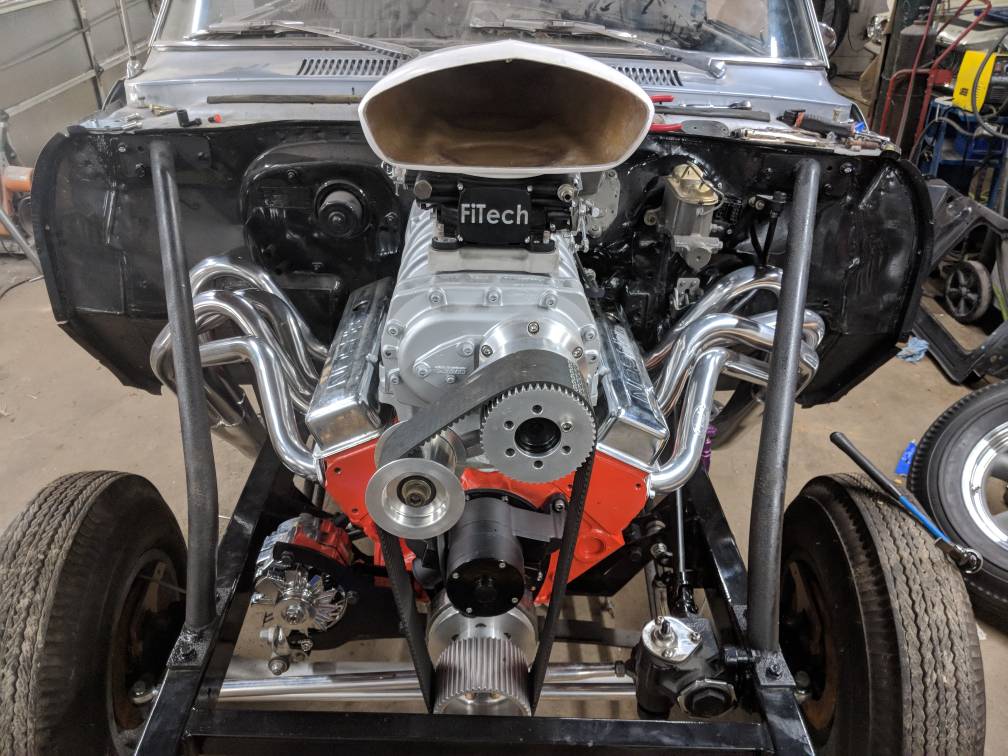

    Been long time coming car is 1965 Chevy 2 Muncie 4 speed 9.3 olds fully built roller 383 hairpin axle IMG_20180819_202630.jpeg IMG_20180812_191702.jpeg

  2. :) Looks ANGRY !!!!!!!

    It should be a pretty strong runner 610/610 blower grind 208 valve heads 230cc runners I hope she sees some time on the rear bumper

  4. Satin blowers are badass looking. Great to make progress, keep on posting!

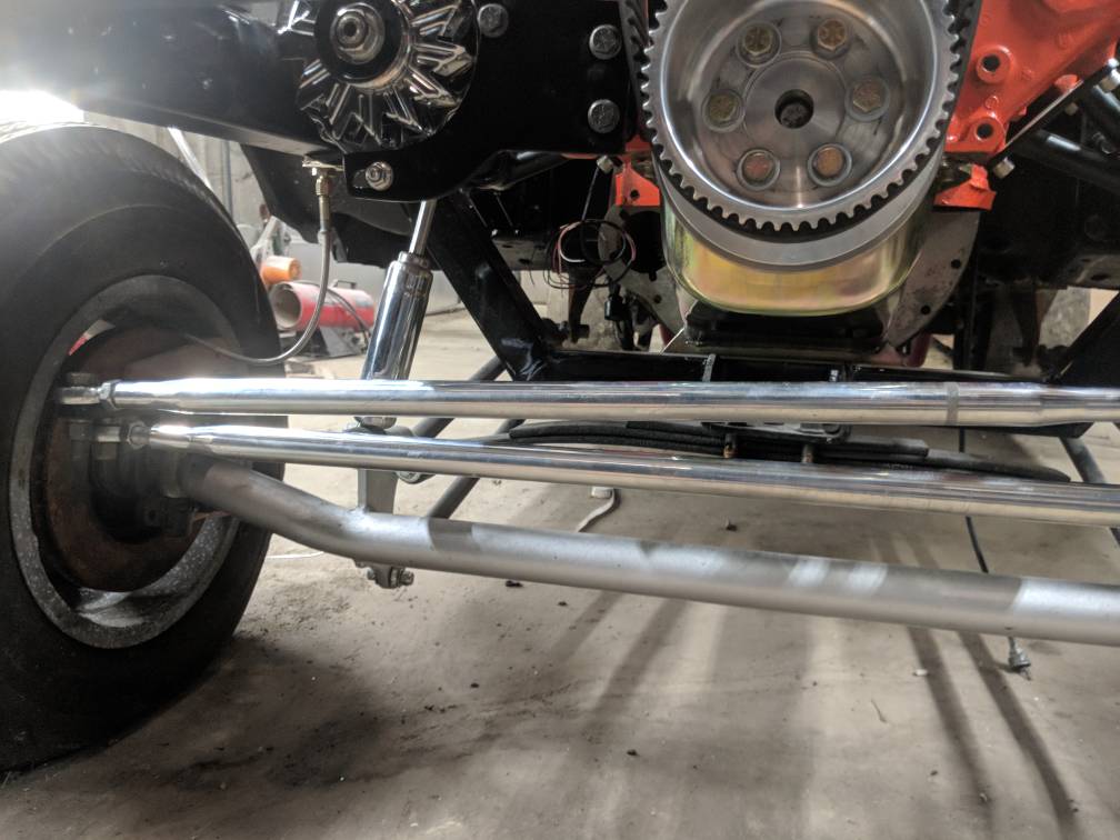

    A little more progress my homemade alt bracket couldn't buy what I needed so I made it it's probably not the prettiest but it serves its purpose throttle linkage is complete next is drag links front brakes IMG_20180916_193213.jpeg IMG_20180916_150358.jpeg

  6. 392

  12. Engine looks good. Not sure if you have it, but on your alt bracket, it should have a brace on rear to help keep it from flexing. You could use the fuel pump cover bolt holes if not running mech fuel pump. Flexing will potentially cause the mount bolts to develop crack and break

    The bracket is there just can't see it in pics
