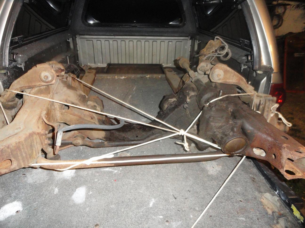

    Picked up a '76 Trans-Am sub frame today from a cool guy in Scappoose. It was only $125 and it's complete. Big brakes/ fast ratio steering / huge sway bar and HD springs.
    He had about 50 F-bodies in his back yard. If anyone in OR or WA wants to get a subframe, pm me and I'll get you his info. Standard Firebird clips are only $80! This guy has the setup and it's cool that he's helping others out by not being a prick.
    I'm sure that I am not the first guy to put a SBC/auto in a lwb '59. I would think that a standard driveshaft would work if it's long enough. I guess I'll know when I put in the stub and then the drivetrain.

    Yep. That sway bar is HUGE!!! I think he said it was 1 1/8". Could be a slot car when done. You know you can get a 'new' cab for only $9,000, then you'd have 9 grand into it. :D
    Me too, plus the color is growing on me. Washed it today and it looks pretty good. I saw somewhere on here where a guy cleaned the car with CLR and it neutralized the rust. We'll see.
