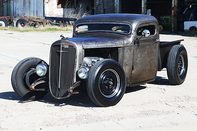

  22. Found this picture..I think Ive seen this on the hamb.
    RMR&C and tb33anda3rd like this.

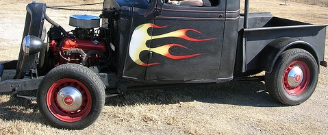

  26. How do you get away from the natural consequence of this stance?
    front spring mounts extended way out front or the axle CL behind #1 plug.
    To me this looks way off - that's how it has to be but it looks like a fuck-up.
    I'd like to see a dead on side view of this one.
  27. If you look at the second truck the front spring perch is on the front of the frame horn, a lot like the early poncho, as I recall the '30s GM products used a pretty short spring too. Theoretically the shorter the spring the closer to the perch the axle will be.
