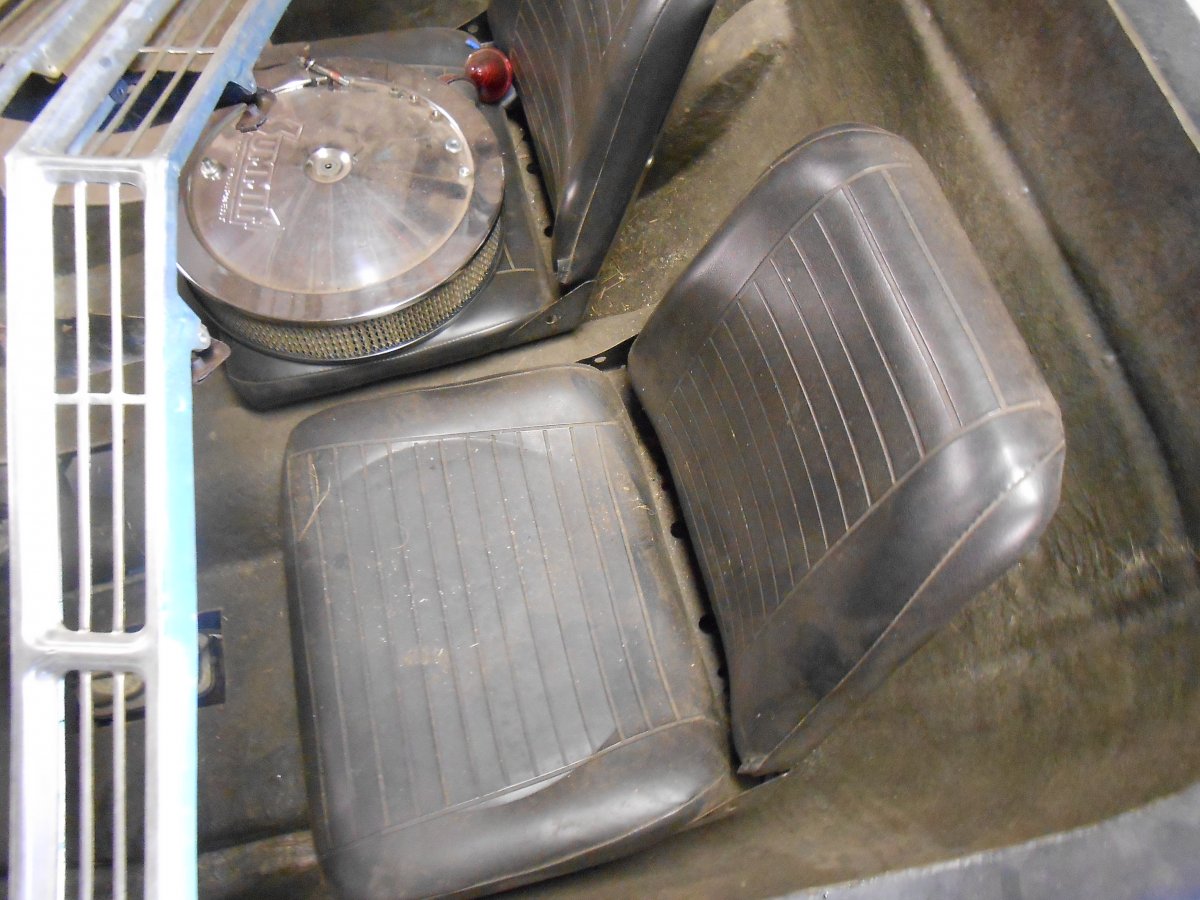

  6. Well since the MG Midget was introduced in 1961, their factory buckets are probably OK to discuss here. And at only 19 inches wide, they fit nicely into a Model A with a little 3 or so inch gap between them. I modified mine to tilt forward to gain ingress and egress to the back seat. The later ones have a headrest that is easily removed.

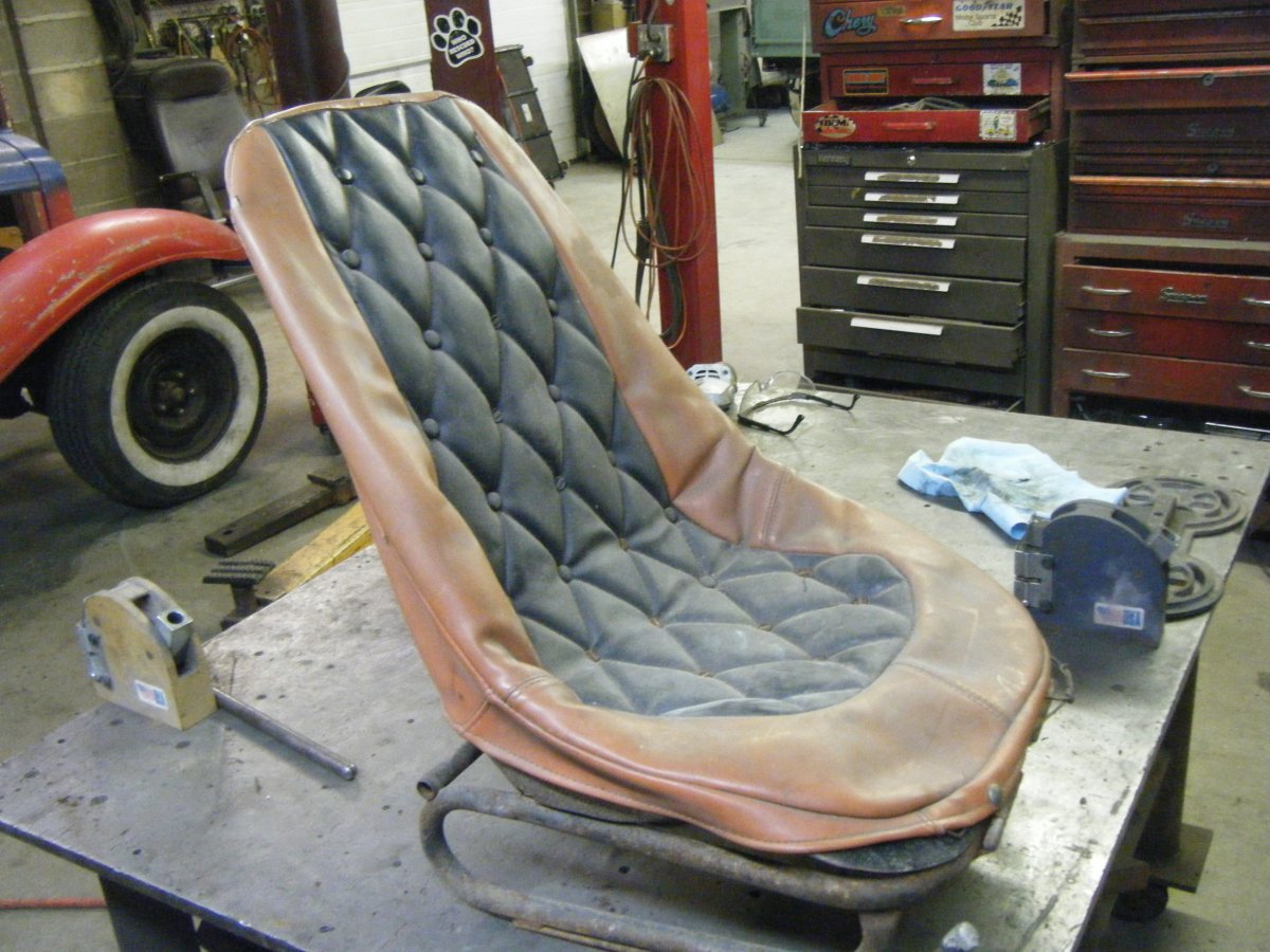

  10. bought a pair of these, 60's era vw tracks and dune buggy buckets. goofy looking but not really comfortable but they make up for it by not being in that great a shape. perfect for my 31 buick i am building. DSCF5013.JPG

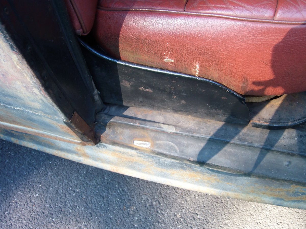

  14. This is what I did for my A beater.
    Simple, quick, cheap, available, nobody ever guessed what they were.
    Rear seat from Volvo, 740, armrest cut out.
    Fits right in a Model A seat frame.
    Welded the seat bottom springs together after cutting out
    the center portion.
    $100
    Hotrodmyk and MyOldBuick like this.
