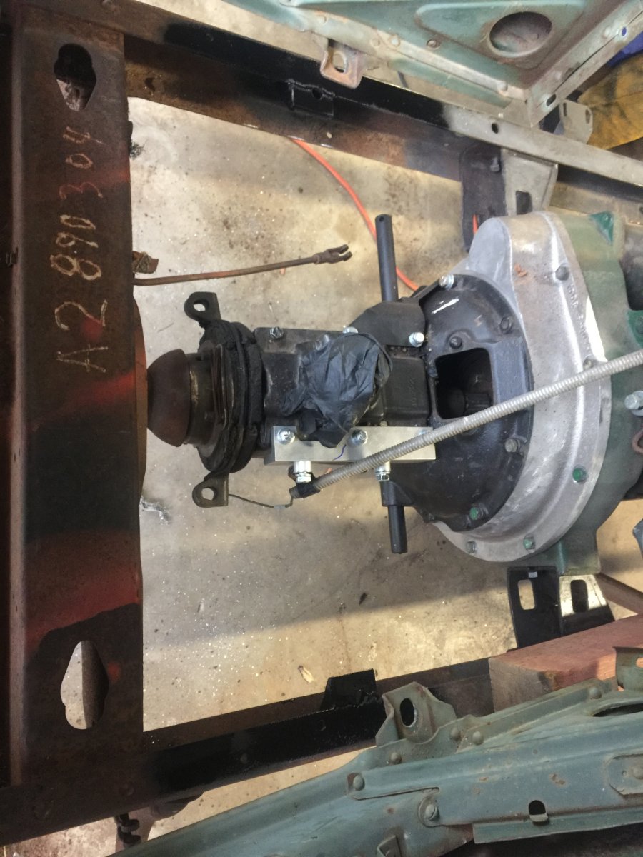

    View attachment 4278016 Body mounts in![/QUOTE]
    Can I bother you for the measurements from the front of the middle crossmember to center hole on the front body mounts? My 27 that I’m mounting on A frame has a little twist and I need to mount it and get the subframe straight so I can line up the rear turtledeck. Just looking to get it close to center wheel well and I’ll adjust from there.

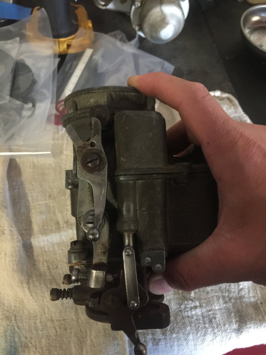

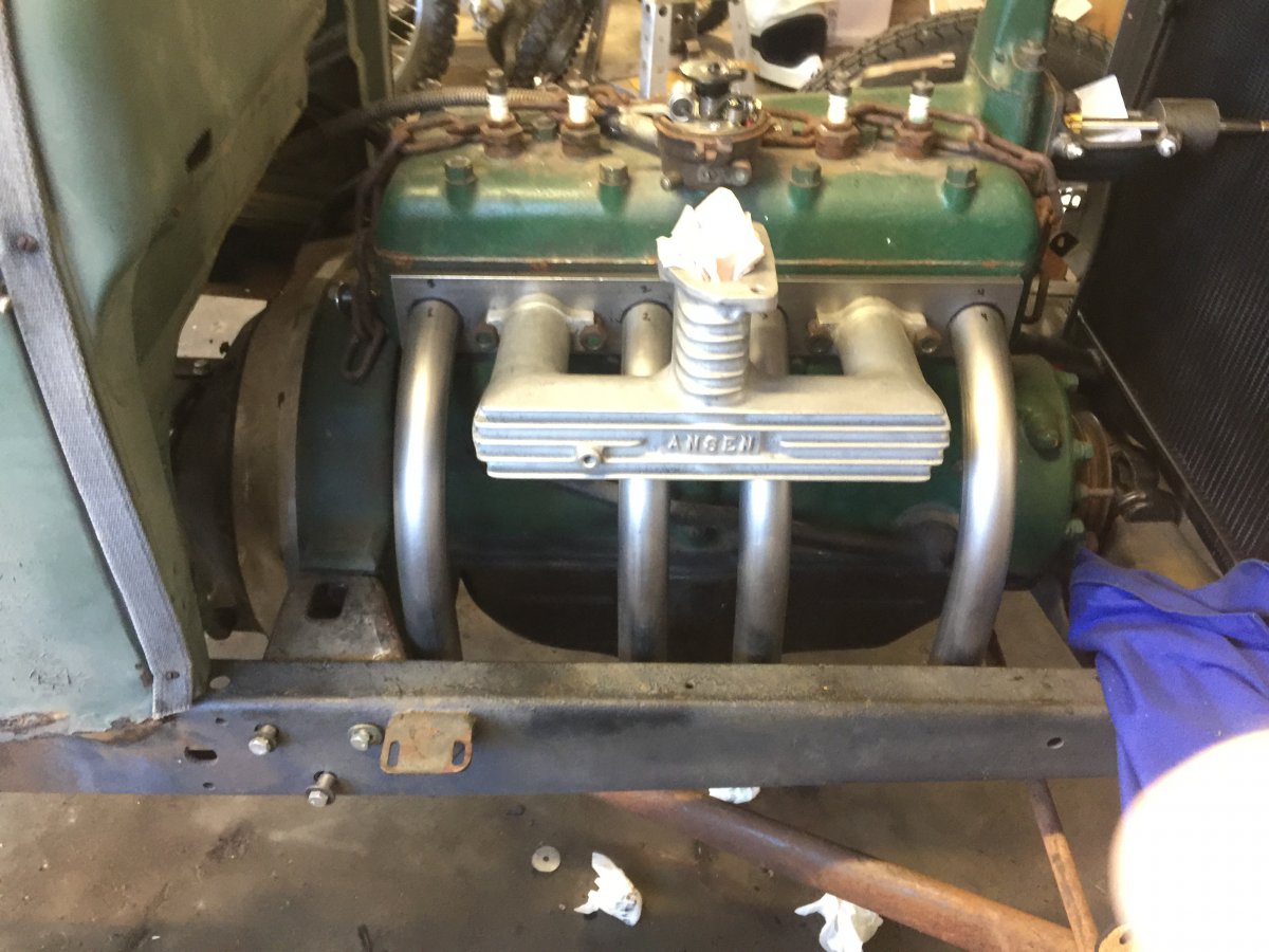

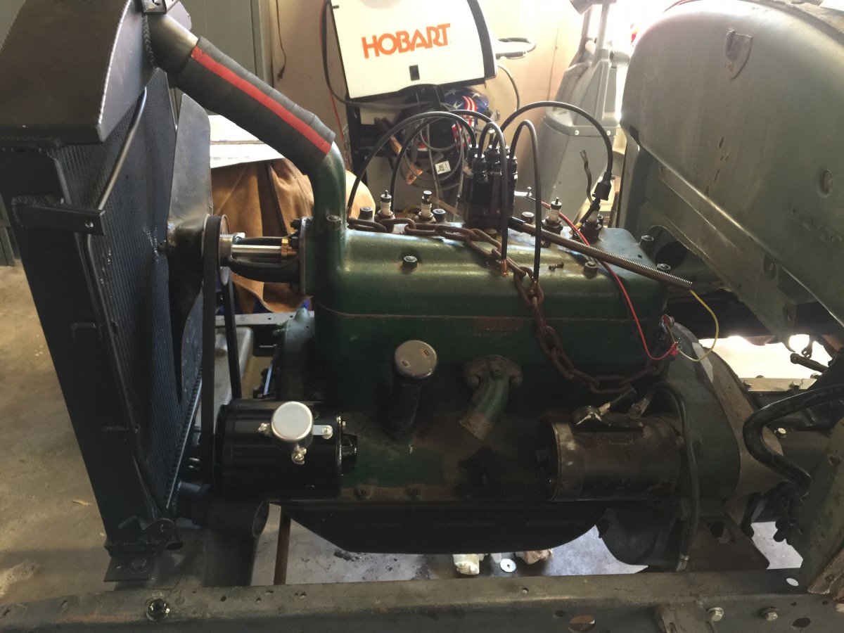

    CD5F8DA8-0DA8-41EB-B34E-9C7B7BA3B074.jpeg A0D7C5AE-6921-46C0-898B-05B1FD1421B1.jpeg 158F1CCC-2EC5-461E-8E76-10E385FA56CB.jpeg 881EDDF2-B223-4D11-8BB4-F7C54BE0BF86.jpeg Got some work done today which felt good. I got the exhaust nicked up, electronic ignition set up, rebuilt the carb and installed the powergen alternator!
