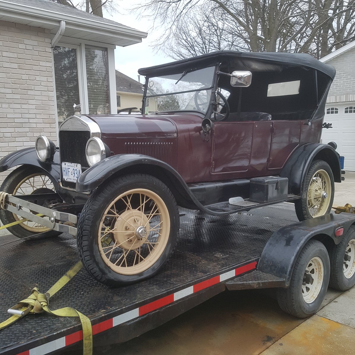

  25. T spring is 2 inches wide , model a.spring is 2 and a quarter .
    Cut 1/8 th off.each side of the hanger and use a 2 inch shackle .19 inch model a wheels on the touring 20181230_150411.jpg

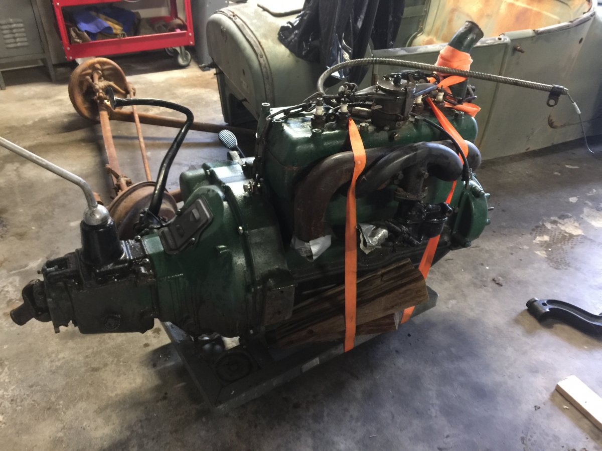

    Picked up the motor I am going to use today!
    I have a few questions that I could find the exact answer for when searching...
    I am going to run mechanical brakes
    What pedal assembly do I need to run my 35’ V8 transmission with the A motor?
    I already ordered the transmission adapter from clings
    Also, the guy I bought the motor from is an old hot rodder and he suggested for a “budget friendly” hop up option is to machine the thickness of the head gasket from the stock head to give you a higher compression head.
    Anyone ever heard of this?
  29. When it comes to raising compression, babbit has it's happy limit. To high and short life. I believe it's 7-1 but don't hold be to that. I will verify that tomorrow.
    Being your adapter is to mount to an A motor does it have a thread boss on the Left side where you can install a Model A pivot shaft. If so I'd use Stock A pedals and adapt to V-8 crossshaft. I believe in K.I.S.S. don't re design something that already works.
