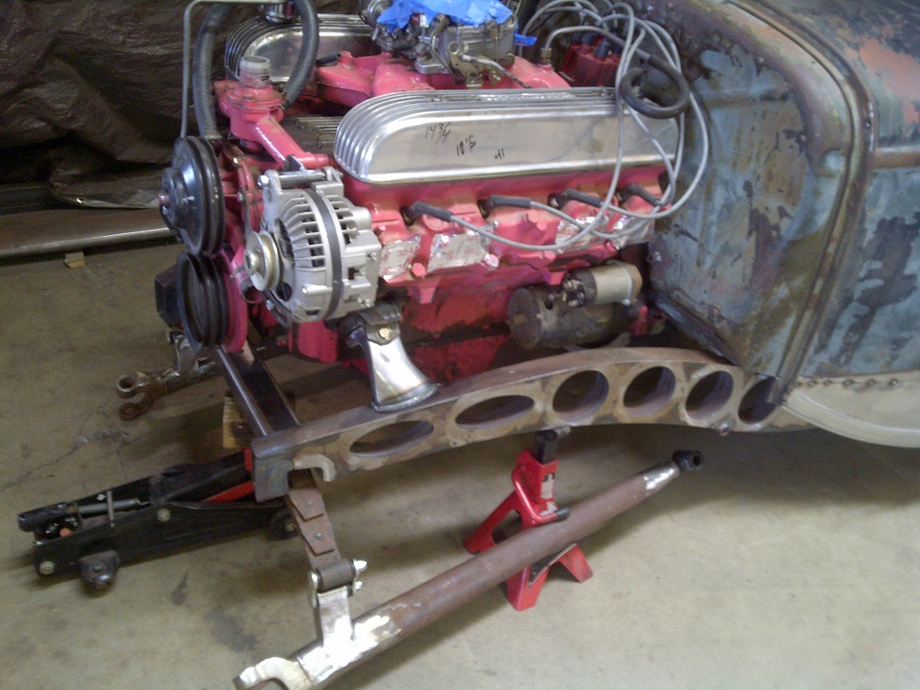

    To answer your questions, the nailhead is out of a 64' Buick and is the 401.
    The radiator I'm running is one that I found at a swapmeet for $20, and I was really worried that it wouldn't get the job done - as it is small and only has 1 core, or "row of cooling fins". It is a very wide single core though (about an inch), and I believe the radiator was built to fit in a 60's Mustang. I have yet to have had an overheating issue so far though, quite the contrary actually - I can hardly manage to get it to warm all the way up. I'll probably put a higher temp thermostat in it this week. I am running an electric fan due to lack of room, but I pretty much never even turn it on. And the fan was just a generic cheep-o from the swapmeet.
    My motor is brand new all the way through, which must be why it runs so cool, but I'm not sure??? Maybe a Nailhead guy would know their tendencies better.

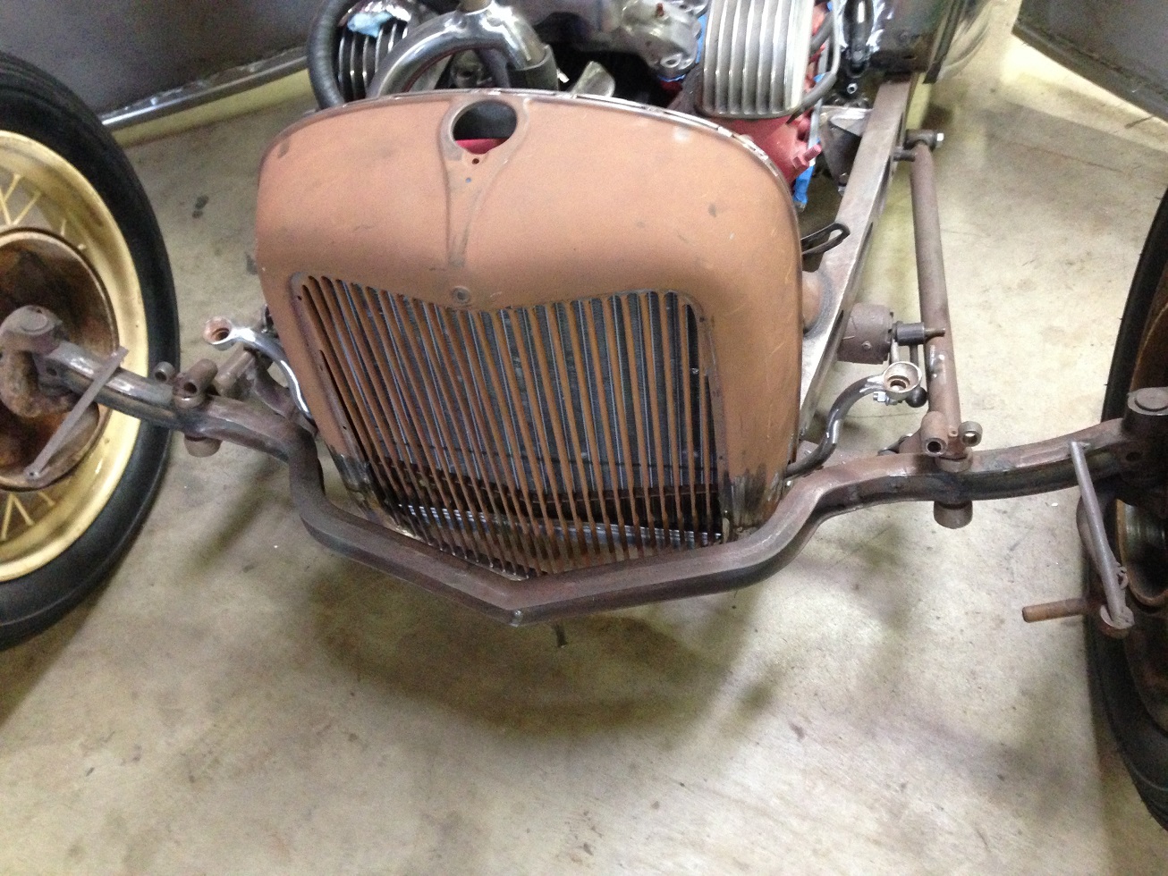

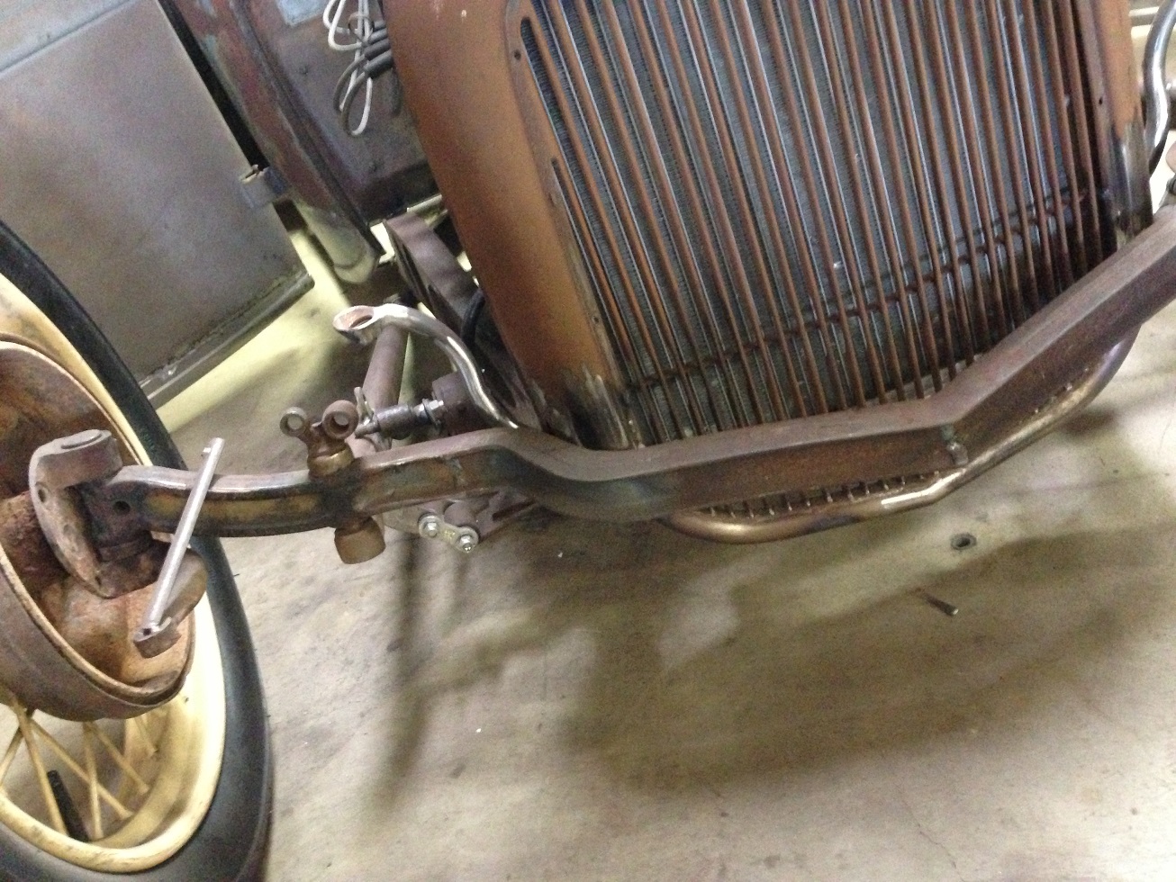

    And lastly, I built the front axle from a 36' axle and just bent the crap out of it with a torch in a little jig I made. I actually had to use a donor axle to add to the center to keep the original width. I bent it like I did to try and keep my wheelbase and front wheels in a somewhat stock position, and I didn't have enough room to go about it any other way. Hope that helps! I'll look tomorrow to see if I can scrounge up any photos of the axle in progress to post.

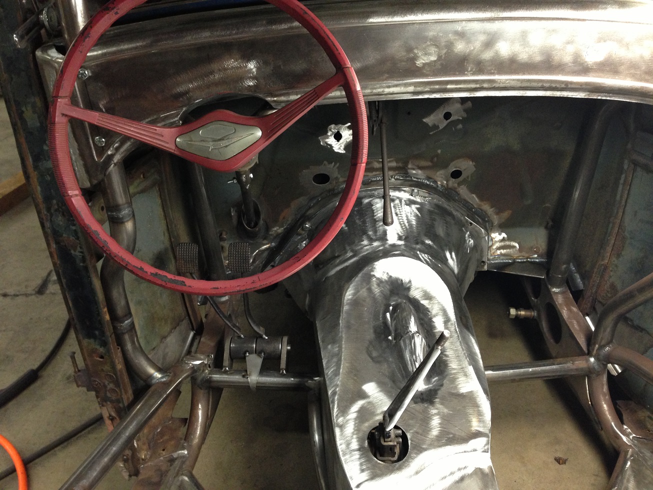

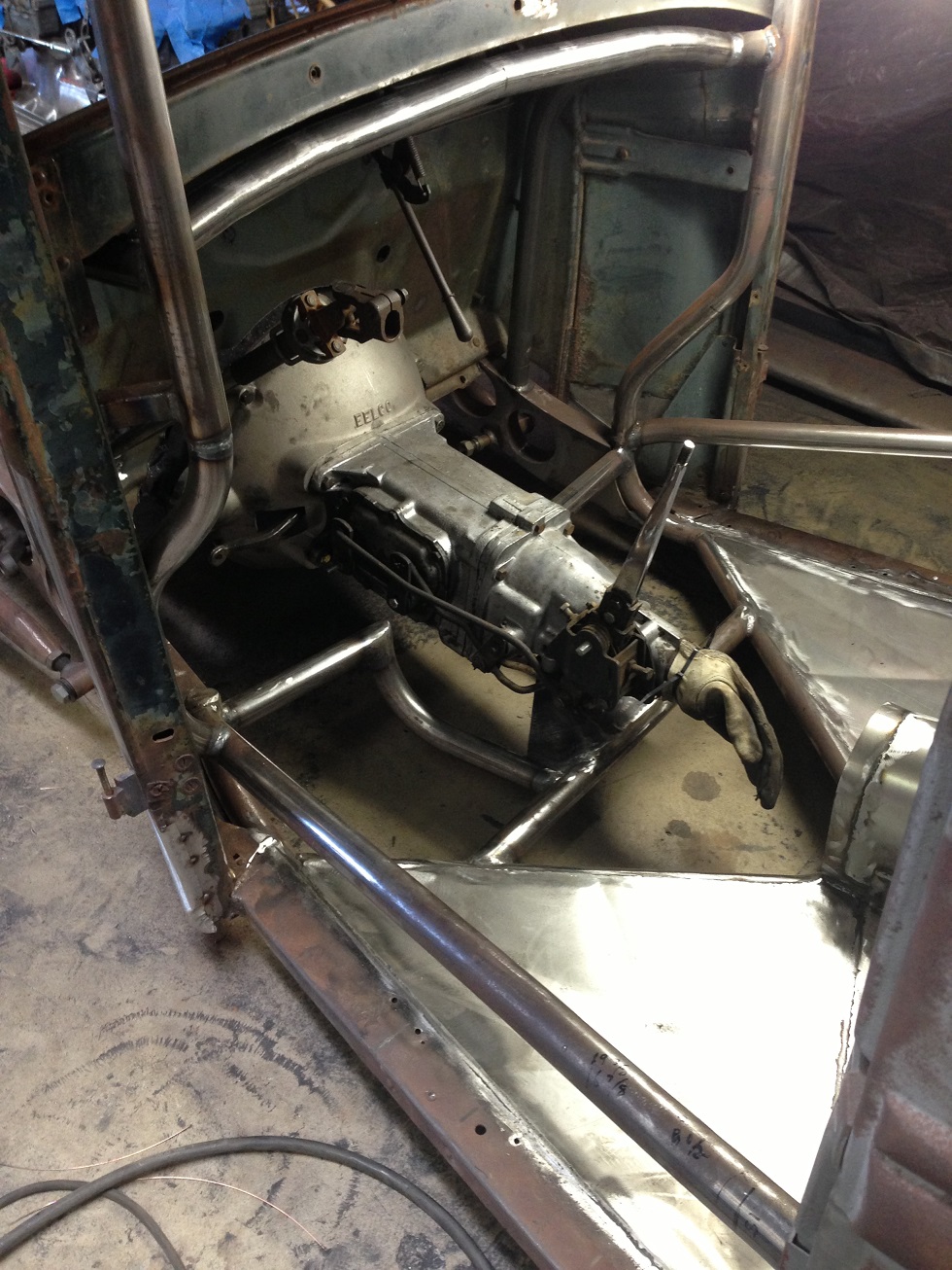

    What tranny are you running behind the 401? It is a manual right?? Do you have any pics of the inside of the car you could post?

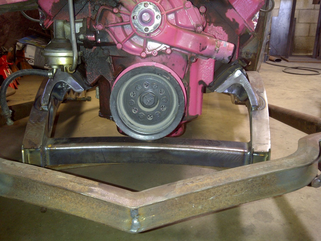

    Mospimpson, I couldn't find my pics of the axle jig I made, but I'll keep looking. Here's a few pics of "in progress" that I was able to find and a few of the inside also:

    Oh, and the trans is out of a 69' Camaro - Muncie 4spd.
