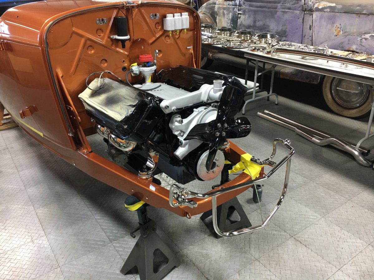

    Once Cato got his templates all made we took the car back to start the assembly here at the shop while he wrapped parts at his shop.
    We are making the best of what we have at this point, parts still dribbling in. Its going to be tight but I have had worse deadlines. IMG_7965.JPG

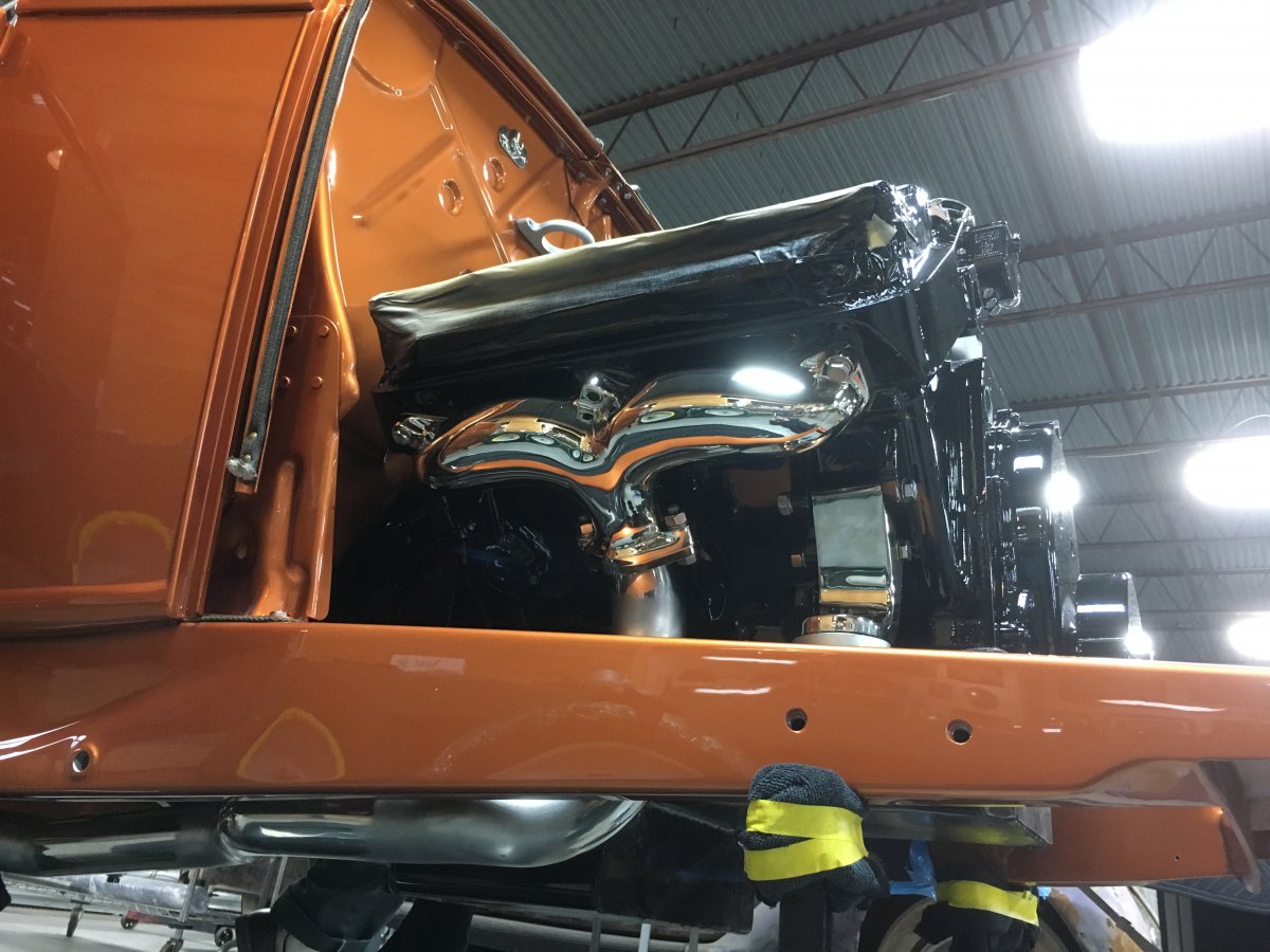

    Eric remaking the exhaust .
    Bolting some more stuff together:
    We don't have much of a budget to be attempting something at this level so instead of complicated one of machined parts we opted for refinishing cool original parts. And doing what little tricks we can.

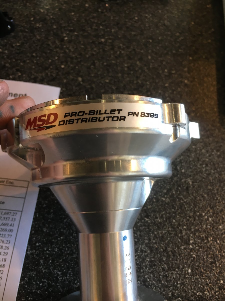

    For instance, the distributor was pretty much the only billet thing we had on the car and it stood out like crazy, In a perfect world I like to put an old restored Mallory in it but this is what we have. So we rounded some edges and did a soft media blast.

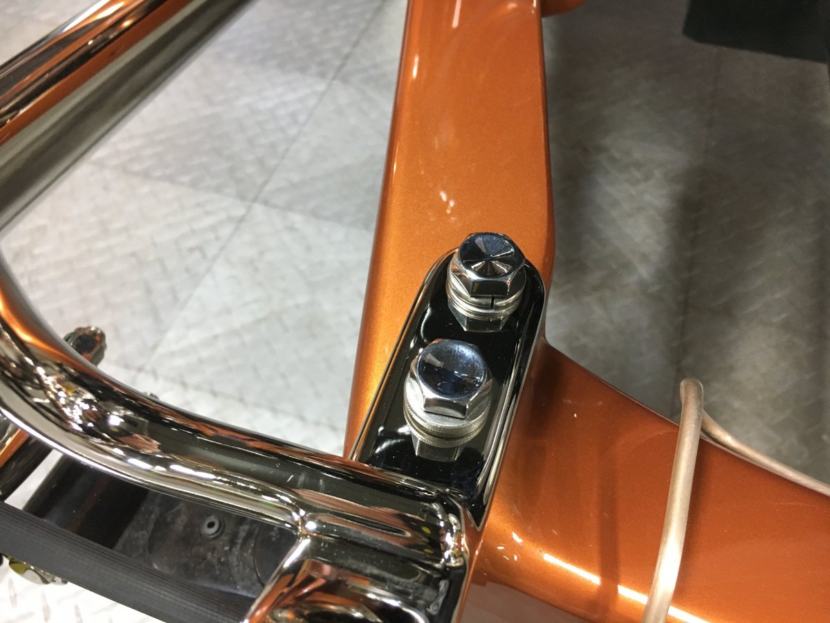

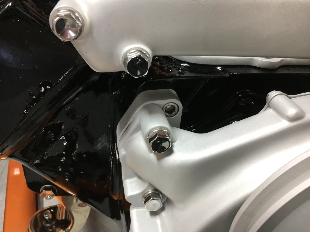

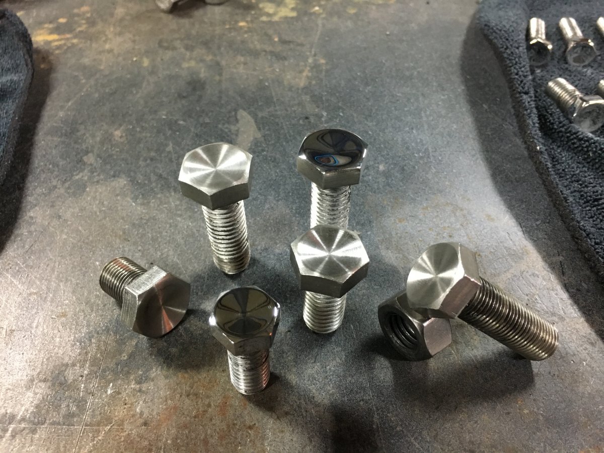

    And some of our hardware is boring and so instead of plating everything we took some stainless fasteners and turned a dish into the head, sanded and polished them.. it doesn't photo as good as it looks in person but you get the idea.
