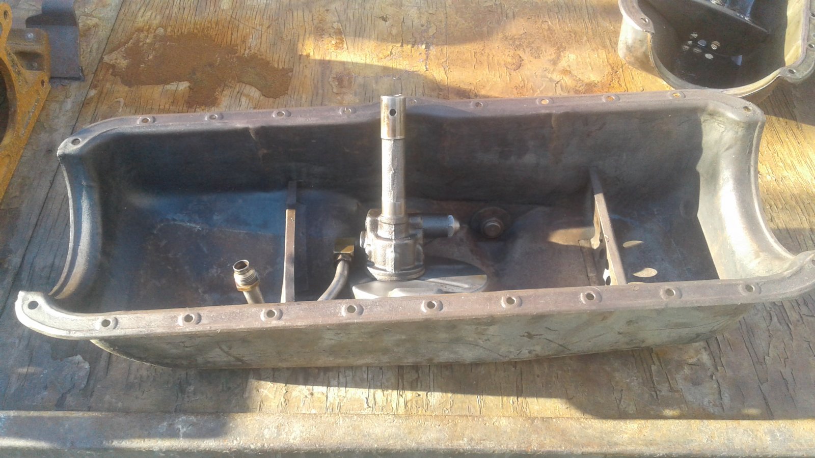

    I've just begun rebuilding a 270 GMC for my roadster and wondering what could be done to improve the oil pan. Motor was pulled from a Deuce-and-a-half, so the stock pan was fine for rough ground and steep inclines, but what about hard driving at speed? I'm hoping the car will see action at drags, dirt track, and hill climbs. Thinking windage tray and gated baffles. Maybe an extra baffle or two closer to the pickup? Do I ditch that huge pickup screen or was that the secret to being able to handle inclines? It seems like back in the day it was common to run a dry sump, but I don't want to go to that expense. So wet sump it is.

    Depending on what they came out of gmc made differerent pans and pickups for those pans. You might look at a 228 or 248 pan. They had differerent sumps and baffles
    Gofannon likes this.

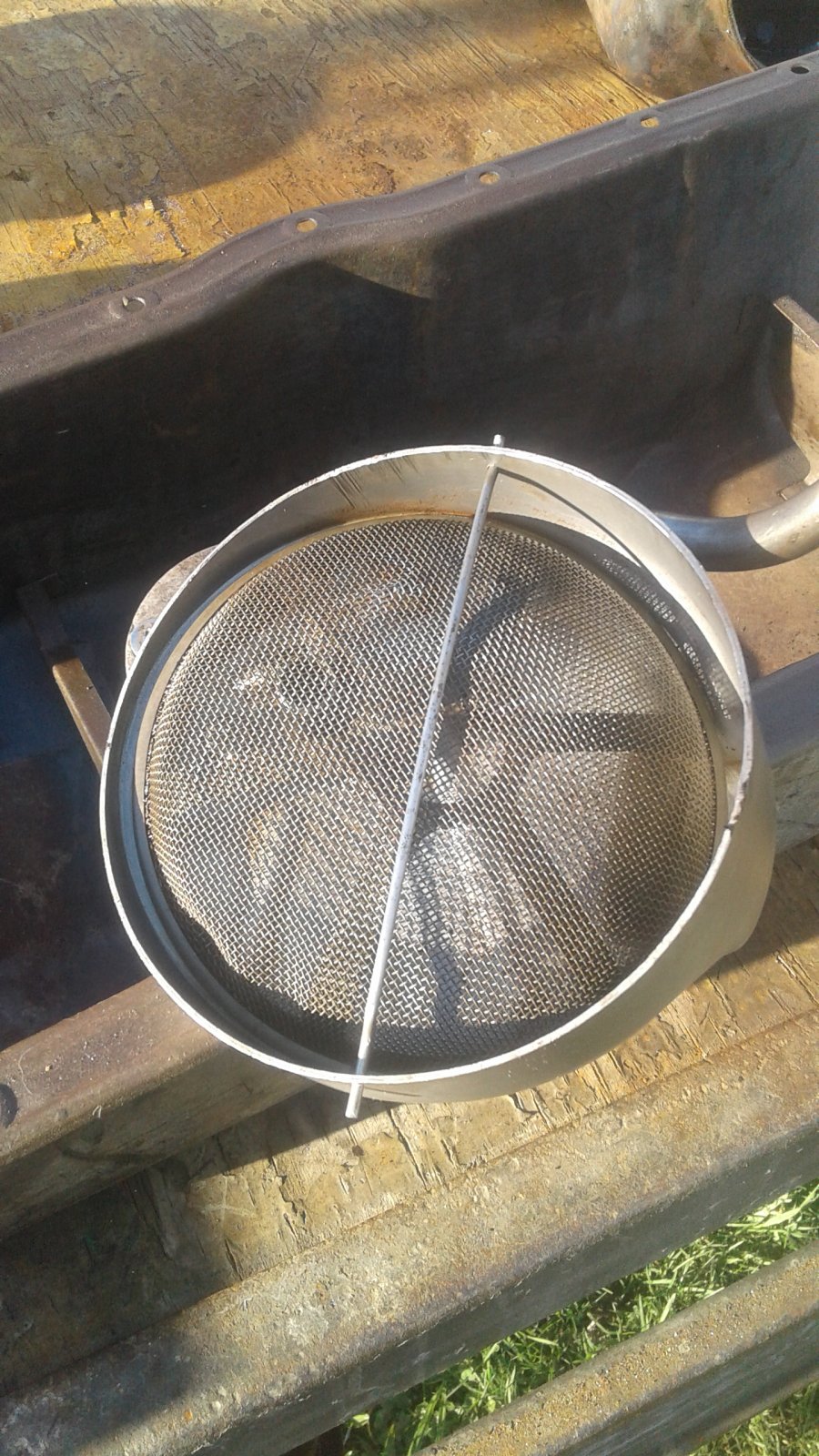

    A 228-248 pan is easiest because it can be used stock. Adding hinge doors on the existing baffles which have factory holes near the bottom will hold the oil from forward movement at the end of a drag race where it wants into the timing cover. I pop rivet or machine screw them in from piano hinges. Welding a flat 3” long plate at the front side to side just clearing the rod is good also. 3/4” long stitch weld works fine for this. This is if your using the stock oil pump which is very good.
    From your photos you just need the floating oil pick up off a different stock pump and the piano hinges to keep the oil in the center section for drag racing. More work I’ve described if your going to turn right and/or left on a track.
    The civilian 302 and military 270-302 pans are the best to convert because the block rail is reinforced with a 1/8” strip over the stock rail. I’ve seen aftermarket BBC pan bottoms cutoff and welded to most of a GMC when using an external oil pump (which I do) or a dry sump. If you doing a right side kick out make sure you leave room for the starter. The pan doesn’t need to be any lower that the bell housing for the most part if your making one but using the stock oil pump can cause a clearance. There are at least 5 oil pump bottoms depending on the application but all the pump bodies are the same.
    My racing pan uses an external oil pump, belt driven, and full length kick outs on both sides. Panels with doors and oil catchers are on both side but no louvers or screens. I have photos somewhere. A single pick up near the back on the left side to feed the pump. Moroso oil pick up parts from Summit and some welding. Good luck.

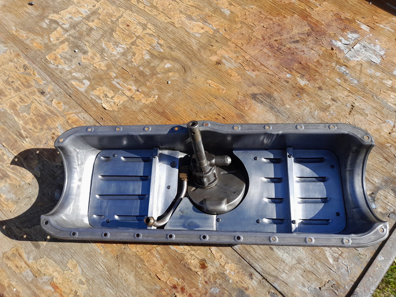

    Here's what I ended up doing. I started by thinking I could just sit a windage tray on top of the existing baffles, but found that would interfere with the crank. Measuring across the inside of the block was about 8 1/2", so I set the windage tray at 4 1/4" from the bottom of the block.. I added 2 extra baffles with trap doors closer to the pump. I decided to keep the original pump pick up as it adds shrouding from windage. Supposedly these pans hold 11.5 quarts, so I measured out 11.5 quarts into the pan and found the oil level is just above the stock baffles. This would mean the crank throws would dip into the oil. Measured the dip stick, Full is 4" below block, low 4 5/8". Now I'm wondering whether I should drop the oil level up to 1/2" lower to make sure the crank is clear? The pan holds a lot of oil, and I have much better control of it. How much would the oil level drop while the engine is running? I can see why dry sumps are popular for these engines.
    Also drilled and tapped the block for full flow filter, and an oil feed to the distributor gear.

    Your idea for the trays are very good. When I used the 11-12 quart pan at Bonneville I ran 8 qts. However I used the floating oil pickup which was 3/8” off the pan bottom when the pan was empty and on a stand. When I changed to the pickup truck 228-248-270 shallower pan I just changed the oil pump bottom. I had one of the oil pickups you show but never used it.
    There are 3-4 different bottoms to the oil pumps for different depths of the pan that will accept the same floating pick up I believe they only had one of those.
    I’ll see if I can find them and take photos. As for a statement above I’ve raced GMC’s since 1975 at Bonneville on gas an fuel up to 216 mph in a roadster and ever had or used a dry sump.

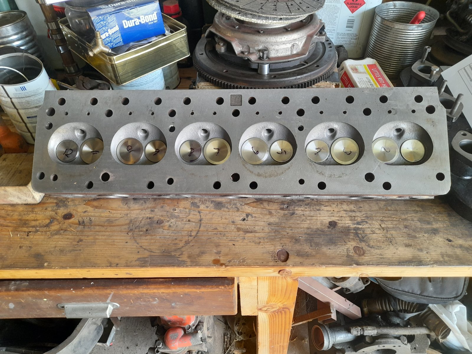

  17. jimmy six
    Joined: Mar 21, 2006
    Posts: 14,929
    jimmy six
    I supposed they could but I follow Howard’s recommendation from the 70’s when using steel or cast iron.
    Spring pressure looks good on the seat and maybe slightly light on open but it will never hurt for sure. The bigger valves kill a little low end for the street but 4500 up will like them.
    Your head looks great flattened but not cut too much. I can see looking in the water holes near the exhaust valves the brass deflectors don’t seem to be there. Not a major problem but please install a water line on the top of the head last 1/2” pipe fitting up to the thermostat housing. Smaller GMC’s didn’t use it but all the military and big trucks did.
    A stock 270 made 140 hp and you are being realistic. With 10-1 and the cam you described and a good intake your # of 250 is right on to me. It would be great to see the torque line from 2500 to 5000 on a chart.
    ottoman, Gofannon and Desoto291Hemi like this.
  18. Gofannon
    Joined: Feb 8, 2007
    Posts: 927
    Gofannon
    I forgot about those deflectors. I'll have to check if my small port head has them. I was going to fit the water line on the top of the head, but run it via a manifold heat plate. I'm struggling to find NPT fittings in NZ. One of the curses of being an old British colony, all BSP in these parts.
