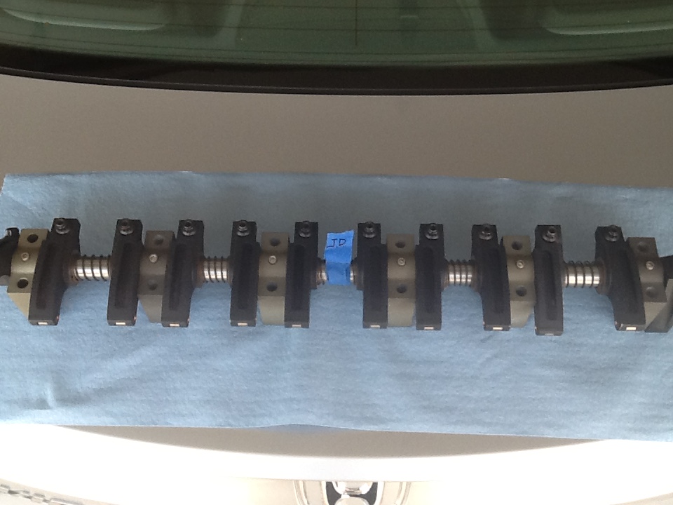

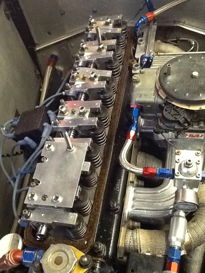

    image.jpeg image.jpeg akk... You can make them in many ways: bushed, bearings, or nothing. The set on my current engine I made 20 yrs ago and used 2 narrow Torrington bearings (small gap inthe center for oiling) on the stock shaft after .003" was ground off on a centerless grinder. It did break near the end after 18 years of hard use. I made a new shaft with a 3/8" hole in the center (rifle drilled, ground, and heat treated) . The photo of the one on the trunk is for an Arias/Howard head and is rocker to shaft. No bushing or bearing and they work great. 7075 material and a hardened shaft. A friend of mine is using the Arias rockers on a chromed shaft on his stock head 302. The one for my Skinner 12Port is also Torrington bearing.

    That's kind of what I was thinking would need to be machined. The problem I have is that I don't have any parts to reference for sizes and if I buy a set for US $150 I may as well use them.
    I would rather make my own as I would like the project and what you have done looks really nice. I like the idea of using the Torringtons as I feel this is the best way to reduce friction.
    Are the rockers on the trunk hard anodised.
    Thanks
    Karl
  16. jimmy six
    Joined: Mar 21, 2006
    Posts: 14,916
    jimmy six
    Yes they are. So are the ones for the Skinner head I have also. The ones on the engine are not. I never thought of doing that when I made them. The reason the Arias/Howard do not have any bearings or bushings is (I believe) that the top fuel/alcohol drag engines don't use them. If I would have thought that would work I may have done it to. Well it does work and sure would have been easier and cheaper. Good luck.

    JD, with your carb 'sideways', doesn't that cause a fuel slosh problem? As most carbs are setup have the fuel bowls in line with motors and direction. I would think that at 175+ mph the fuel is tilting with fuel heavy to one side?
  19. jimmy six
    Posts: 14,916
    jimmy six
    2 questions:
    #1The HEI was new stock 194/292 unit I sent to Performance Distributors in Memphis Tn. 20 years ago. When I got it back I machined off the lip and made a clamp. The other late model distributors I have I just turn the gear upside down and repin it . The gear then lines up with the cam. I use an external oil pump so I don't care about the oil pump tang. This one however will reach the stock pump.
    #2. I have no clue what is happening with the gasoline in the fuel bowls. Remember there is no launch, we push off at both El Mirage & Bonneville. The adapter is as recieved from Clifford Research which only mounts in that direction for the carb. Also how many dual quads you've seen mounted sideways. I'm pretty sure all the Pro Stockers were that way. With all that, I've never seen a problem with the way it is now.
