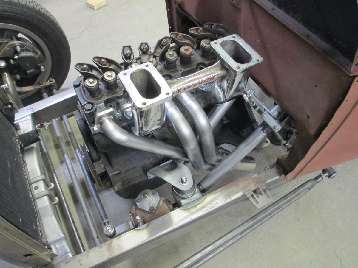

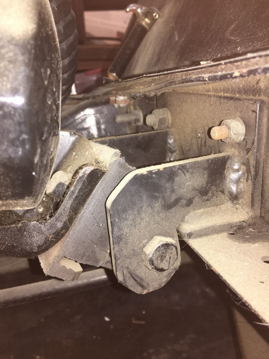

  3. Marty Strode
    Joined: Apr 28, 2011
    Posts: 8,889
    Marty Strode
