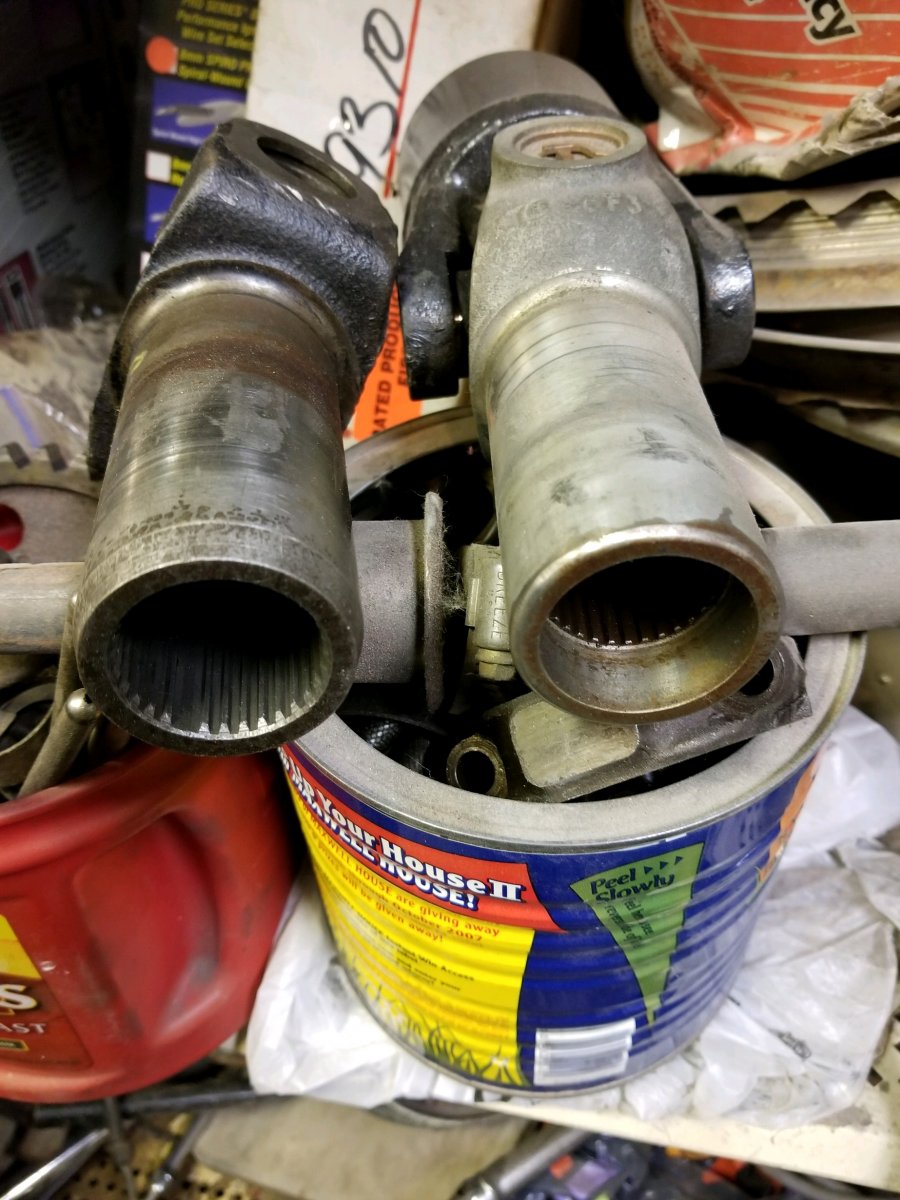

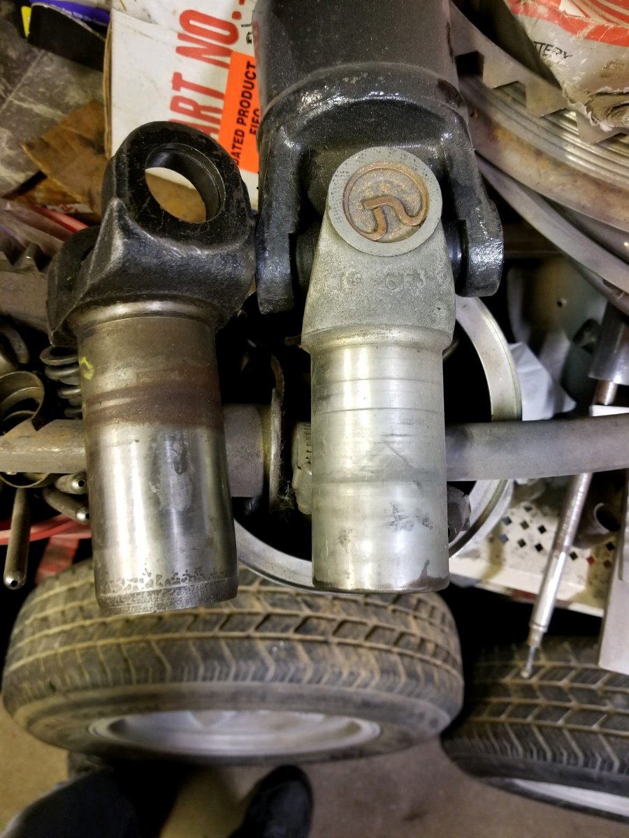

    The output shaft on a truck t 400 has a ridge on it which does not allow the passenger car yoke to fully seat in it. Yes the yoke can be shortened to give 3/4" to 1 " of free travel , I have done this several times . I can remember Tim who used to own San Diego Driveline asking customers who would bring in measurements for t400 driveshafts asking ...is it a truck t400 or a car t400?
  9. Lumpy is correct, you can't just change the seal and make a car yoke fit, the output shaft has an O-ring on it to keep the fluid in, when you look at the bolt in yoke you'll see it's not splined to the end so it can go over the O-ring. Another supplier for the slip yoke that will fit that trans is Inland Empire Driveline
    https://www.iedls.com/
    The conversion yoke from Inland Empire on the right (about $80 bucks) and regular car non bolt in yoke on left, you can see how it's not splined all the way to the end and it's overall shorter.
