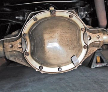

    There are four (4) versions of 10-bolt GM rear ends: 7.5/7.625, 8.2, 8.5, and 8.6". If yours matches the picture it's a non 'C' clip 28 spline BOP 8.2" either from a:-
    • Oldsmobile Cutlass 1964-1972;
    • Pontiac Firebird 1967-1972; or
    • Pontiac GTO 1964-1972.
    This a similar 28 spline Chevy 'C' clip' 8.2" 10 bolt.

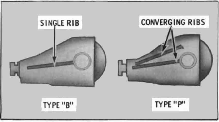

    'B' - Buick and 'P' -Pontiac https://www.hemmings.com/blog/article/b-o-p-rear-axles/
    10-bolt 8.2-inch B-O-P axle usage:
    • 1964-’66 Olds F-85, Cutlass, 4-4-2;
    • 1964-’72 Tempest/GTO;
    • 1967-’71 Firebird; and
    • 1964-’71 Buick GS/Gran Sport
    You may be fortunate to a rare 'N' (Nodular) housing

    Hey Stumpy. Thanks! Top pic looks like mine, except mine doesn't have that reinforcing web on the bottom from the housing to the axle housing. Mine does have two parallel webs on either side of the front of the hogshead.
    Now I can buy my brake kit. Thanks!
