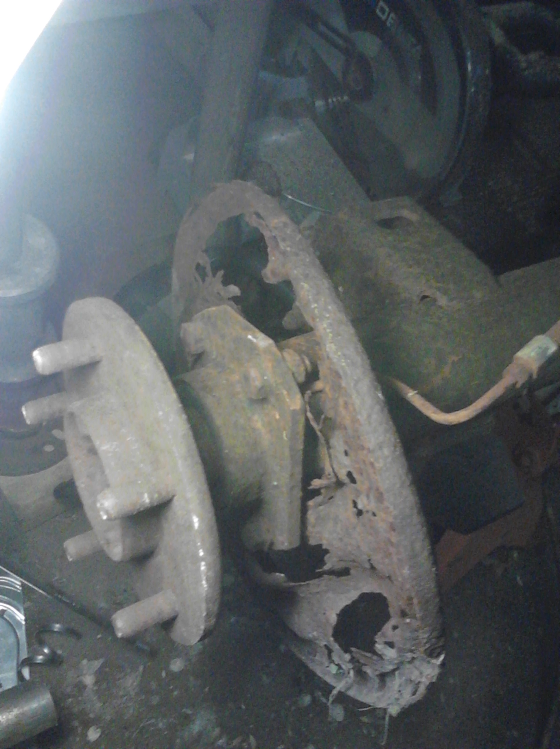

    get a picture of the mounting flange as you might have the weird ones .

    Here's a picture hopefully you can tell the set up, though I'm starting to loose faith that I can find parts, my online searches are turning up empty.

    Sorry guys I think I'm a clueless donkey. I think I might have a mid 60's BOP rear.according to this website http://www.jdrace.com/diff_id/10bBOP_Early.htm especially since my bolt pattern is 5 on 5". So I may be in luck, as far as finding parts. I've never been familiar with rear axles, you live and learn I guess.

    quickest way to ID it , does it have a flange ( like a ford 8.8) or a u joint cup on the pinion , if its a flange its a 8.75 from the 70's , the HD ( police ,taxi, tow , large motor ) version of the 8.75 was a 5x5 pattern and its a junk yard only part unless you can find someone willing to help you convert to discs ( they will need the axle offset to the flange plus some other measurements , I was reading its also a truck flange , but truck brakes supposely do not work due to the different offset .
