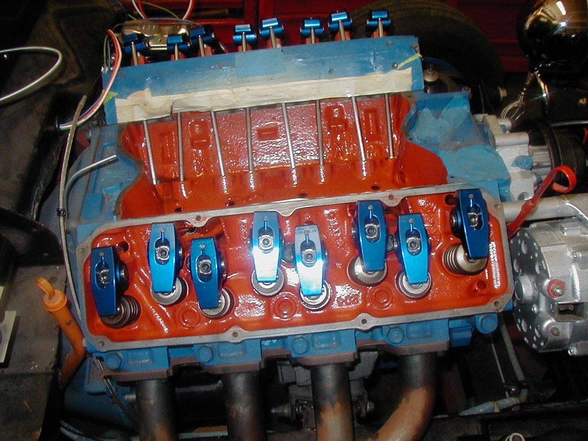

    Hello, well I painted the Glyptal today. It went on pretty easy. I took a die grinder & ground down all the cast surface on the top of the head. I also chamered the oil drainback holes & cleaned it REALLY good in the parts washer at work. What I'm wondering about is that it went on kinda thin with a lot of brush strokes showing. Will it dry thicker & even out a little or do I need a second coat? thanks.

    I didn't use any heat. It worked fine. I was very happy. I would do it again.

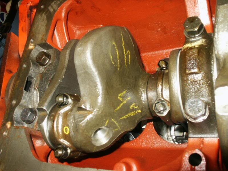

    My block was painted 33 years ago...pic is from yesterday still looks new
