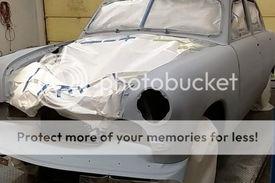

  26. gijoe985
    Joined: Jan 7, 2015
    Posts: 172
    gijoe985
    We just block sanded all that down, going to put another coat of primer on today in the areas where we did some glazing putty. Hoping to have it ready to paint by summer. I can come in on my down time and get it painted.
  27. Slopok
    Joined: Jan 30, 2012
    Posts: 2,921
    Slopok
    I believe he's talkin about the trim holes you mentioned earlier.
