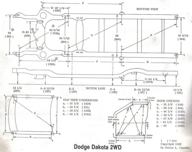

    Please don't desecrate your MoPar with a chevy frame! No really the Dakota is the best way to go with a frame swap on a 55 Dodge. There are three different wheel bases on the Dakota frame. if the frame you get is too long it can be shorten by cutting some out of the center because the center is straight. Some of the Dakotas came with V-8s making it easier to drop in your 440. but if you get one of the V6 or 4 cly. ones you might want to change out the front springs.
    If you get one of the earlier frames, than the wheel lugs will be just like your charger, otherwise they are 6 lug. this still can be up graded because the front rotors can be changed out and rear-end replaced with something that will stand up to your 440. If I remember right the ones after 90 or 91 are the 6 lug. I have a 88 and its 5 lug where the 93 I have is a 6 lug. I have a 55 Dodge pickup also which I'm going to swap out. If you do a search on here it should bring up some guys who have done it. I'm uploading a frame scan to help you. Good luck. upload_2014-11-14_17-50-14.png
