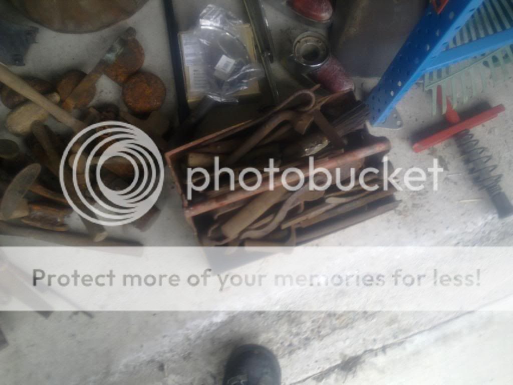

    I bought a bunch of older panel beating tools off ebay for $86, some are in good condition, some average and others totally buggered. Some of them were sitting in a tool box that got water in it and they are pretty badly rusted.
    Is there any way to clean the rust off and keep it off? Some of the dolly's will probably have to be resurfaced if they are salvagable but i figure its worth the effort.
    Here's some photo's to give you an idea, any info or idea's appreciated.
    Cheers
    Dave

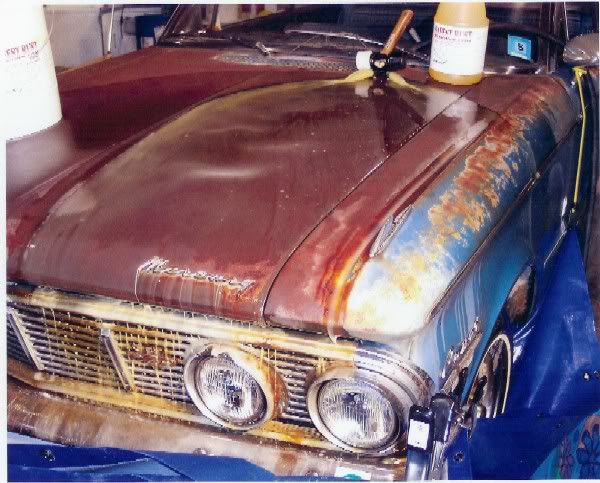

    Stuff to clean rust I found on the HAMB:
    Ultra One: http://safestrustremover.com/#
    Then preserve with Gibbs Product: http://www.roadsters.com/gibbs/#prices
    Gibbs thread on the Hamb:
    http://www.jalopyjournal.com/forum/showthread.php?t=419773&highlight=bare+steel
    Ultra One was used to clean the buried 57 Plymouth from Tulsa.
    Ultra one sprayed on with a $59 pump from Sears through a garden hose and spray gun:
    Then there is CLR and green scotchbrite pad: or Wood Bleach (cheaper)
    CLR/ Wood Bleach thread:
    http://www.jalopyjournal.com/forum/showthread.php?t=522153&highlight=clr

    Thanks guys, i'm going to give the vinegar a go first and will probably give the other idea's a go too as i've got a few car parts to clean up too. I wonder if any one sells ultra one here in Australia because it would be a huge help on my desoto.
    Cheers
    Dave
