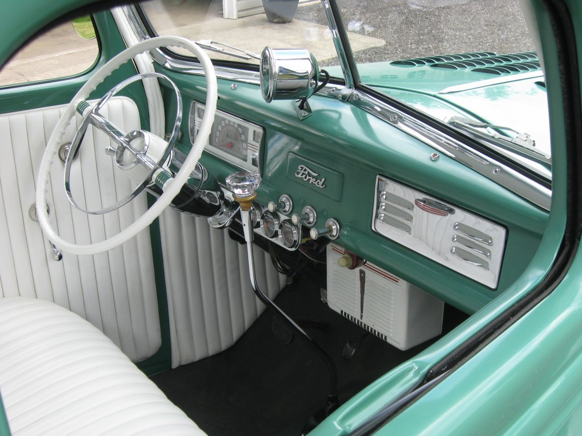

  19. I used Lokar, and bought their shifter knob adaptor also which allows use of your own shift knob, rather then one of their choices. IMG_2865 (1).JPG
