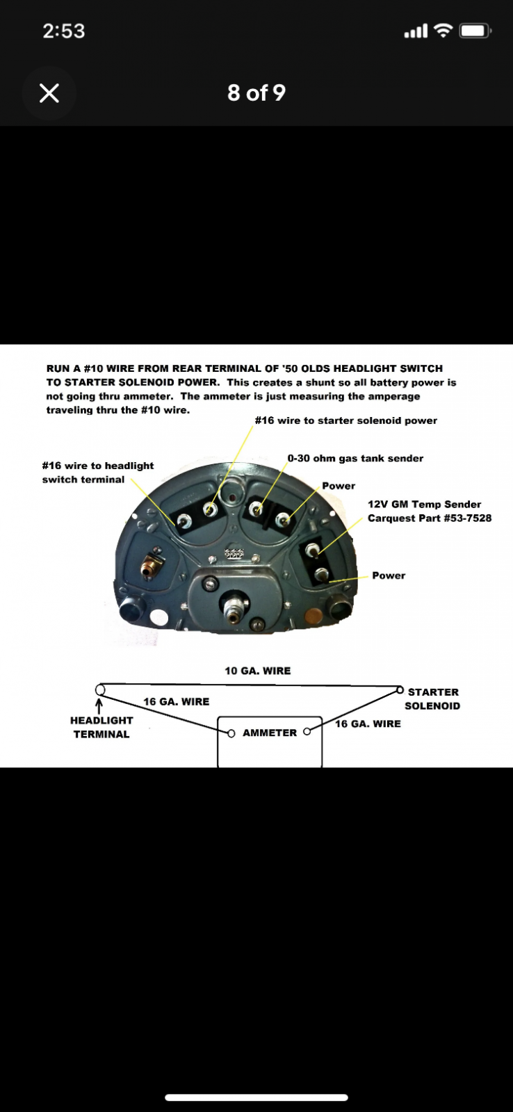

    202A2F97-30D4-4152-A4AB-021290DFC8DE.png D504F54E-A122-4A74-8EAA-5612F7B61F2D.png You will want to wire your amp meter shunted so full current won’t be running through it.

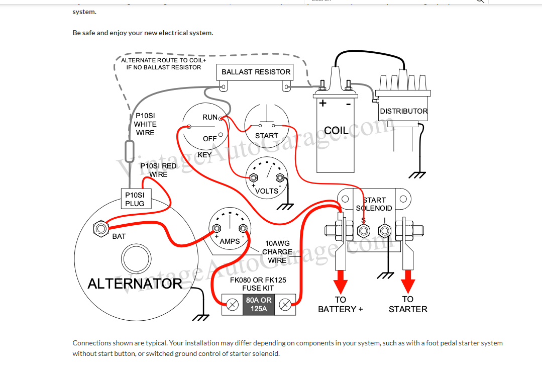

    Screenshot (470).png First off , it isn't the amps that an alternator or generator is rated at that screws up an ammeter, it is the load that the system demands that flows though the ammeter that will burn it up. Simply meaning, if you have a simple electric system without a bunch of items that draw extra with combined components drawing more amps together than the ammeter will handle you can overload and burn the ammeter up.
    On the other hand a simple car with maybe a rather simple AM-FM radio head unit with no amp and a simple heater and no electric windows or electric seats or other accessories that draw a bunch of power you are safe with an alternator and the ammeter. Still I would prefer a volt meter.
    Poking around looking for wiring diagrams for alternator swaps I found this one. You do need your decoder ring on as it shows both volt meter wiring and ammeter wiring.

    I disagree with the schematic shouldn't the ammeter be between all loads and the battery so it will see the charge or discharge to the battery the way it is shown only output if the alternator will register.
    jimmy six likes this.

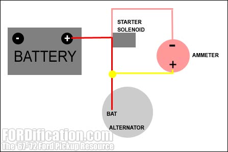

    I'm pretty new to that concept of a "shunt" - actually had to look it up (as a German anyway) - but not sure if I understand it right - I found this on a Ford forum:
    So a shunt is basically just a kind of "bypass wire" that takes most of the load from my ammeter - and I guess the difference of the cable diameter/gauge is in some sort of relation how much load is taken over. Does that make any sense?

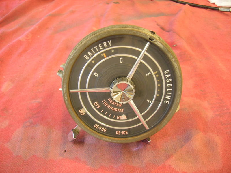

    The sixties big Pontiacs had the best amp meter. It worked like a amp probe. It said, "Battery".

    Well... A current shunt is basically just a resistor, usually with a very small resistance. When current goes through something with a resistance you get a voltage drop proportional to the current, according to ohms law:
    Volts=ohms*amps
    If the resistance was 1 ohm and the measured voltage drop was 1V, the current has to be 1A. Now, 1V loss is far too big to be acceptable, but something more like 1 milliohm could be used, that would give you 1mV for every amp, and a relatively low voltage loss even at hundreds of amps. If great accuracy isn't necessary you can simply measure the voltage drop over a suitable length of wire, instead of using a dedicated ballast resistor.
    There may be other ways to use shunts with old automotive amp gauges, you never know what someone may have dreamed up through the years, but this is the common way to use a shunt to measure current - run the current through a small resistance and measure the voltage across it, then do the math to figure out what the voltage says.
