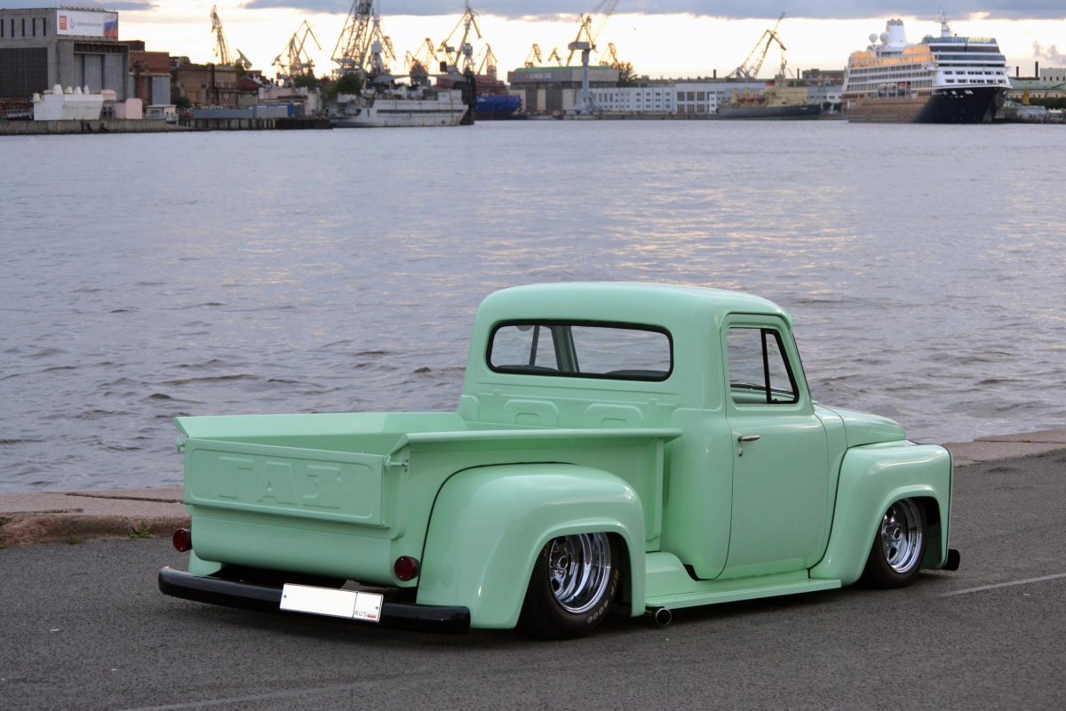

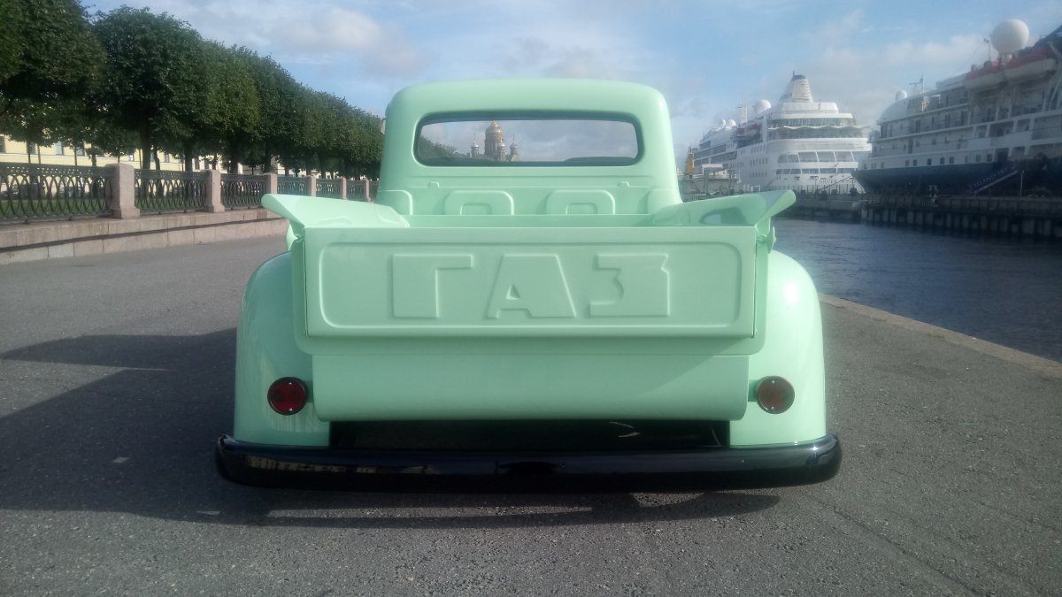

    Hi every body! My name is Egor. I am from Saint - Petesburg, Russia. Last 7 years were spend on building of my Gaz f-153. Actually, I ream about Ford f100 53-56, but is it real problem to foud in Russia, that's why I took old 3,5 tonns truck Gaz 53's cab, chassis from chevy Maliby and SBC 305 engine and mix... Now you can appreciate this.

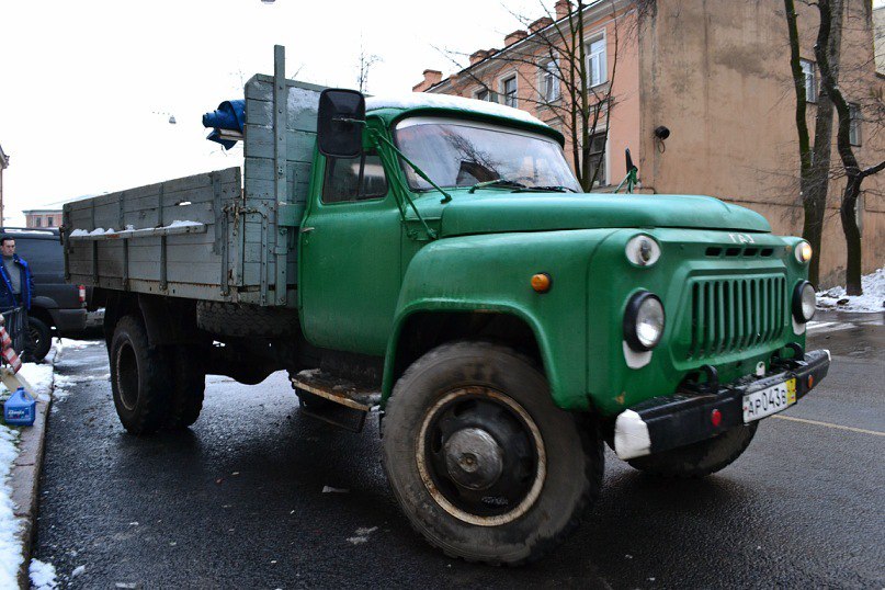

    Thanks alot for your comments. Later I will post some pics from the begining. And this is original truck's foto. Truck was presented me on my birthday by my wife

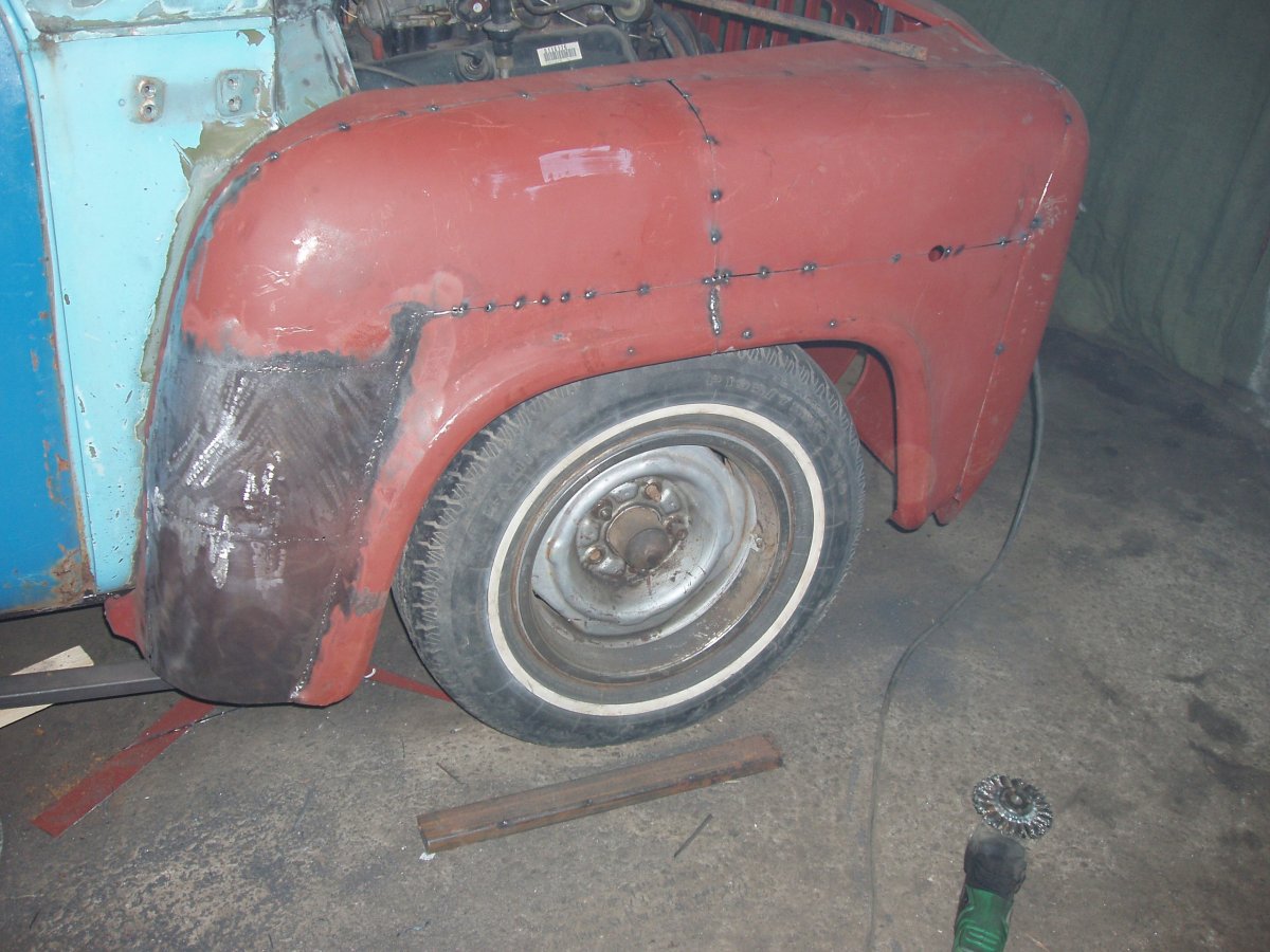

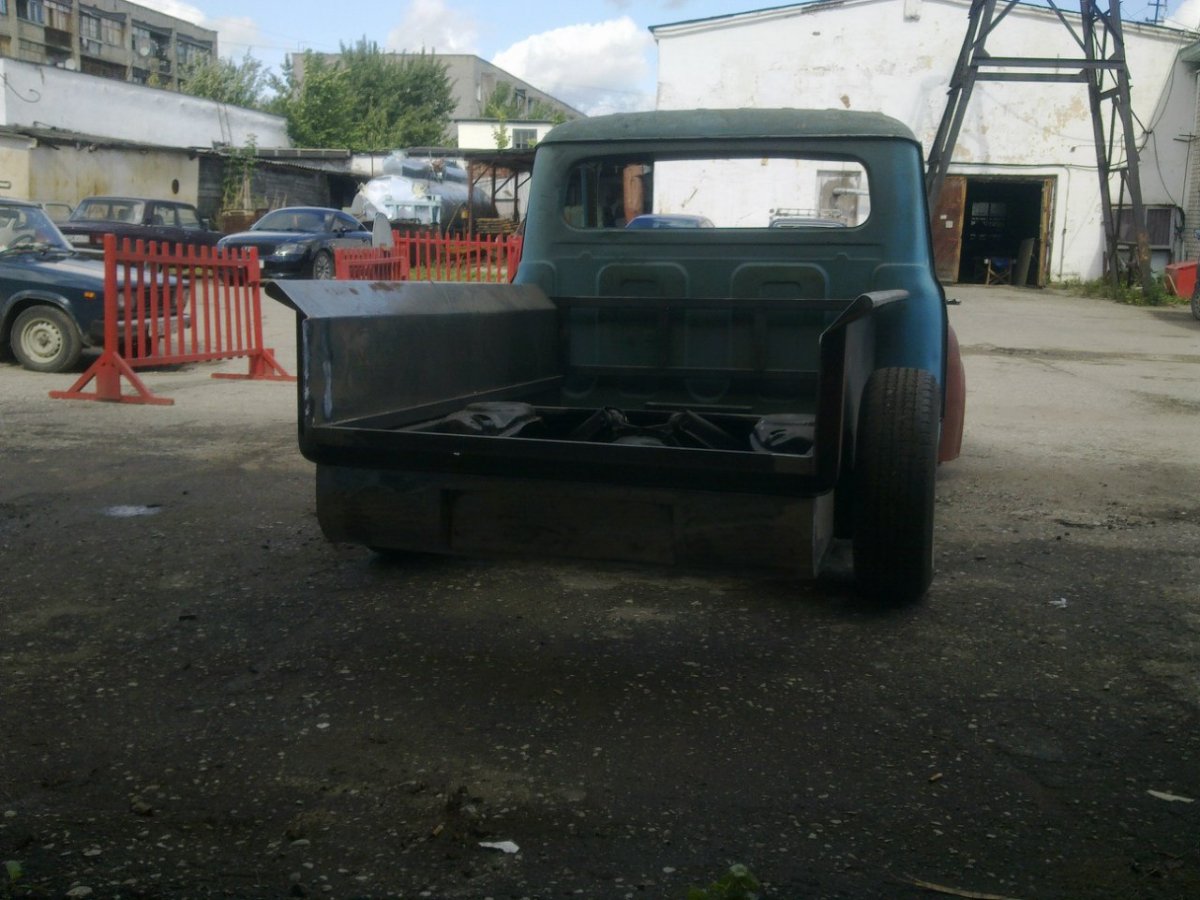

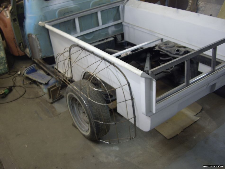

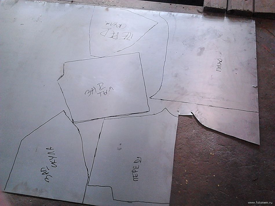

    These pics from 2011. It was first version of my Gaz. Cab from junkyard. I produced basket using 2mm. steel. Frame was forsed by additional pipes.

    OUTSTANDING WORKMANSHIP! Very impressive skills you have. I am supposing you also fabricated the rear fenders too. Thank you very much for posting this project and hope you will post more.

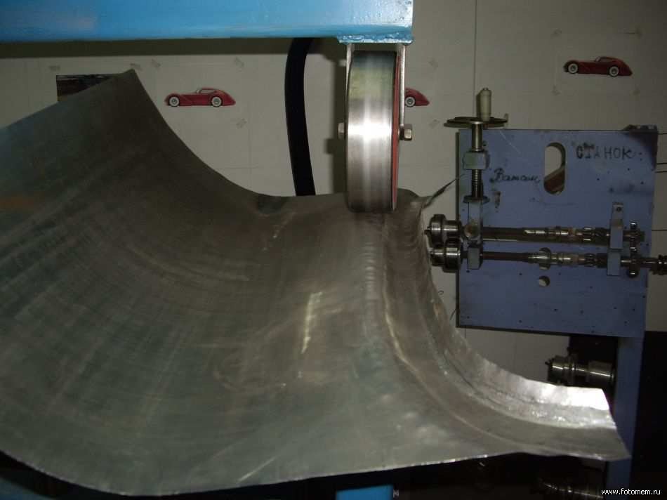

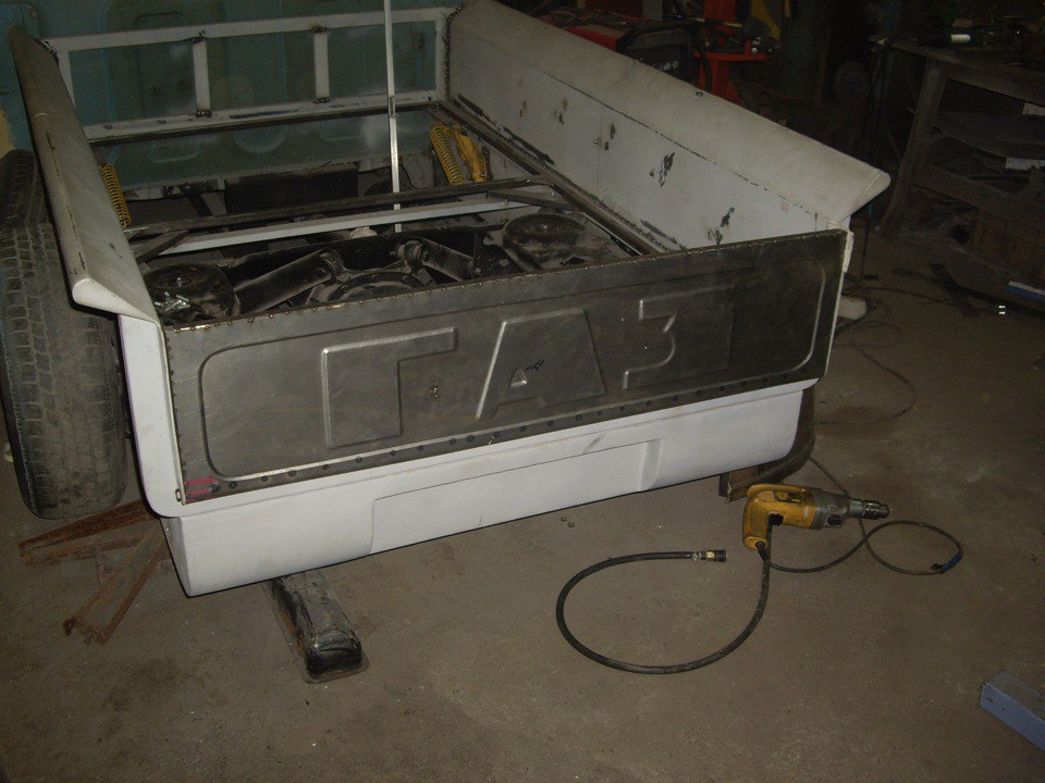

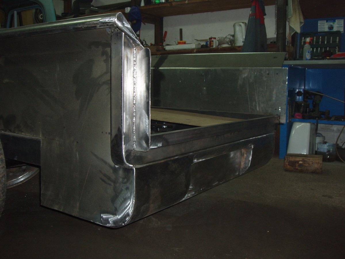

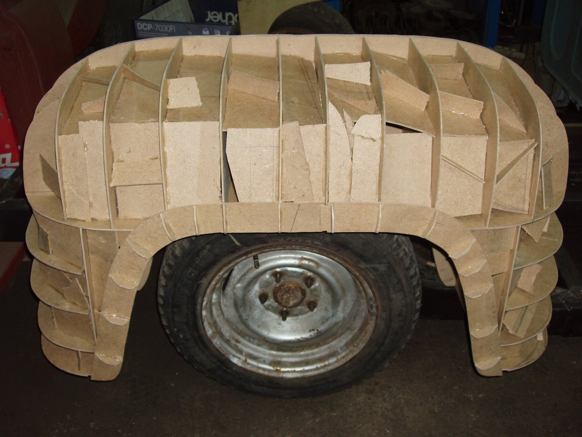

    It was really hard story. First of all it was my first experience of metal work and welding, and after fwd fenders which were modified from stock, I understand that have not sufficient skills for continue. I made the model of rear fender and depart my truck to local professional workshop. They spend alot of time for work with my Gaz. I visit work shop many times and work together with professionals. I am on last photo.

    I try made it using fiberglass, but it was wrong way
