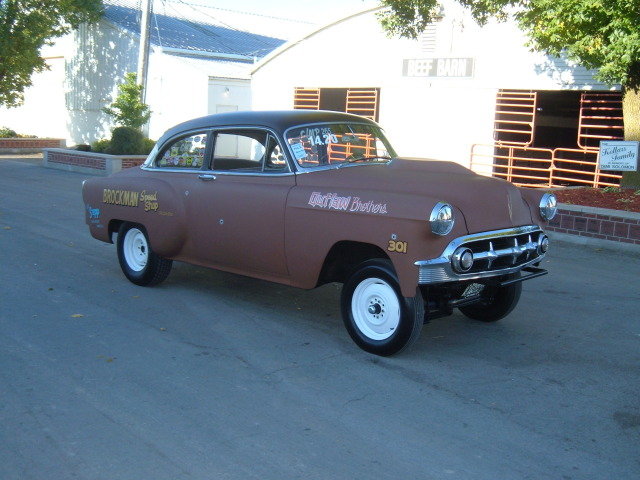

    Here's one of ours without, Ball joint extenders and coils and twist in knuckles.
  17. Lild
    Joined: Feb 22, 2010
    Posts: 260
    Lild
    Wow. Very nice

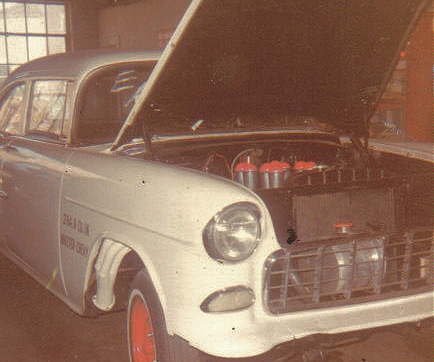

  22. falfas55
    Joined: Apr 21, 2004
    Posts: 288
    falfas55
    Here's a photo of mine.

    That 55 is beautiful.
