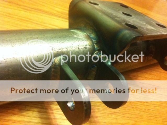

    A custom 2.5" .312 wall axle I made the other year

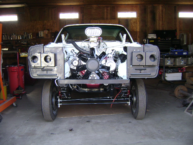

    And here's the setup I'm building presently. Econoline axle in a early Falcon:

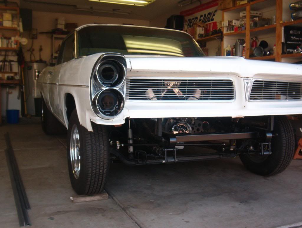

    Showed the start of my Catalina back in 2011. Still building it but much, much, more done. Frame and suspension all done. Motor built and together but yet to fire it. Trailered it to a local Pontiac Car show event last weekend. I got the "Best Engine" award even though mine was the only engine there that did not run, LOL.

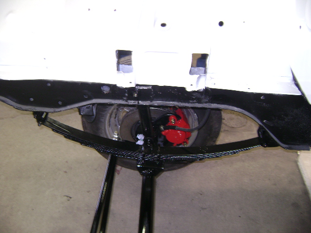

    This is the finished front end. I used a 525 Saginaw steering box with a cross steer drag link ahead of the axle. I used the original Chevy rear tie rod mouts behind the axle to retain the original Ackerman and use the axle to protect the tie rod from road debris. Made all rods with 5\8ths rod ends. I may change to a power steering system later if I need it. If I can find room on the motor to add the pump and brackets.
    The car at the show with the award.
    Getting closer to drivable but a ways to go yet.

    Looks great. Come along ways from the earlier posts / pics. Plenty of power with the twin Turbos I'm sure ! Congrats on the award.
  16. Everytime I see that Pontiac I am impressed, way out of the box and so cool! You go! And keep posting progress, please... :D

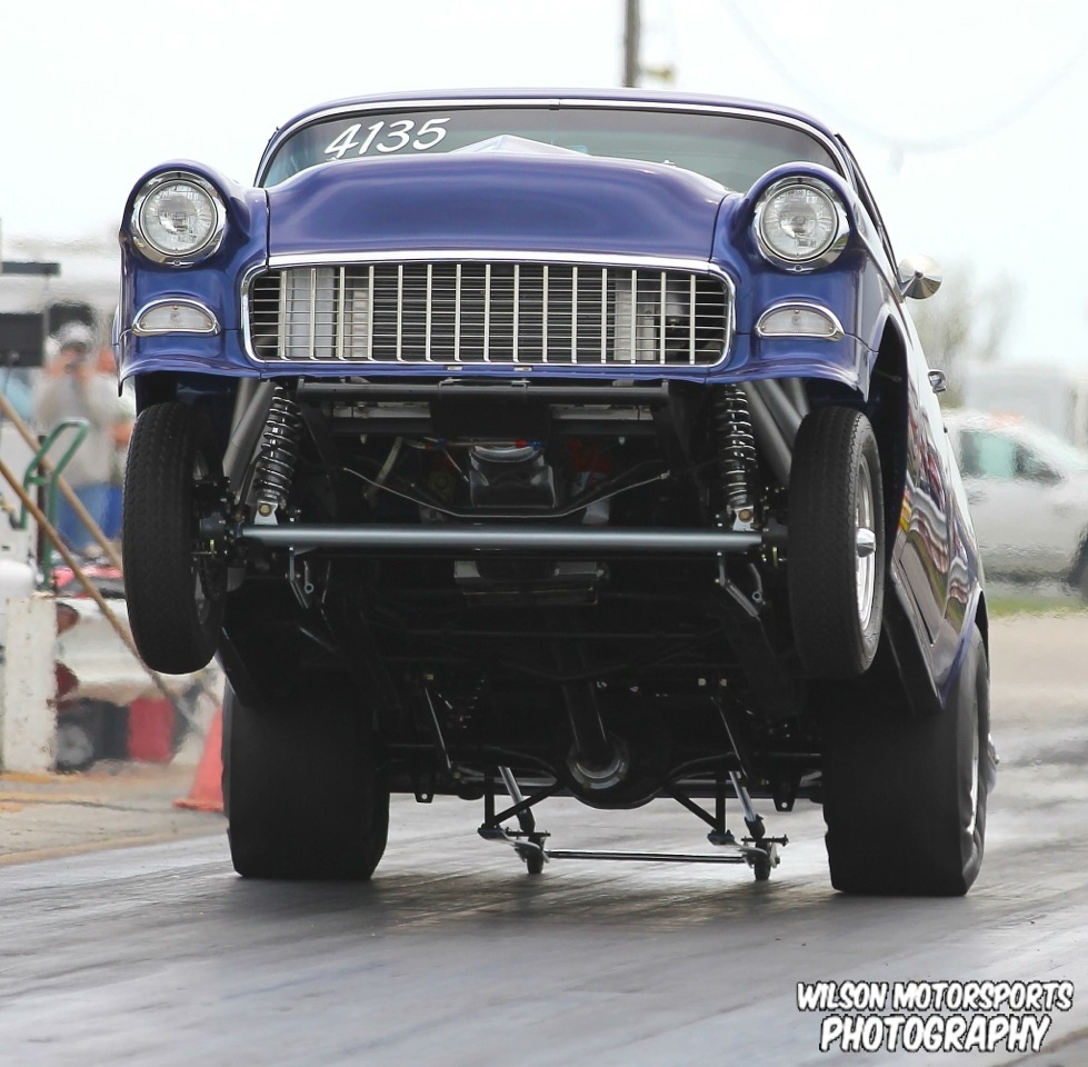

    I realize its not for everyone but mine works well with coil overs. You can't see it from this shot very well but I used hair pins instead of 4 bars. No complaints the cars drives and handles like a dream, been 143 so far and looking forward to more.

    GasserDude. I really like the looks of the hairpins and the coil overs. Probably saves a few pounds over the leaf springs too. Are you using a front panhard bar or something else to locate the axle? Mark L

    marks73turbota. here's a couple shots of the panhard and shocks. kinda hard to see but it's mounted right behind the axle so it's not so visible. it saves a few pounds and the adjustable shocks don't hurt either.

    Nice nice set up. I like the way you hid the panhard bar and the pins with coil overs make it look so clean. I would like to go to a true straight axle sometime in the future. The truck axle I'm using is so bulky looking and it restricts how wide it can go. For my tastes I'd like to have the axle a little wider to place the tires out a little farther. Right now I'm using 1/4 inch spacers and offset 6 inch rims. Also the tires are a little bulky too. But because the car is so "BULKY" it is not too bad looking (to me anyway). Your '55 is just so "right" looking, love it. I've always loved the gassers and the full bodied altereds, but I'm a loving the early '50's Pontiacs. I had to go with a Pontiac. The first "Street Gasser" I ever saw was a '57 Chevy with a Mopar 416 or 440 set way back into the firewall, back around 1967. I was a year away from my license and it has stuck with me all these years. Matter of fact. It was pretty much the same color as your '55, maybe a little bit deeper blue. It's the car that hooked me because I had never been to the strip yet. Man I love your car. Mark L
