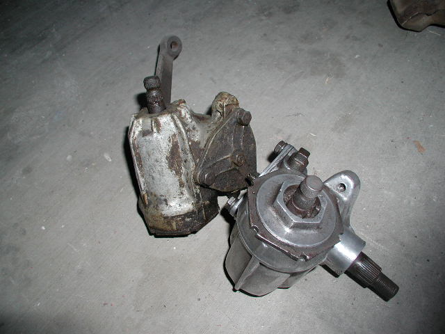

  2. GM 525 box,...with Speedway steering components for cross steer. 37 coupe build 217.jpg

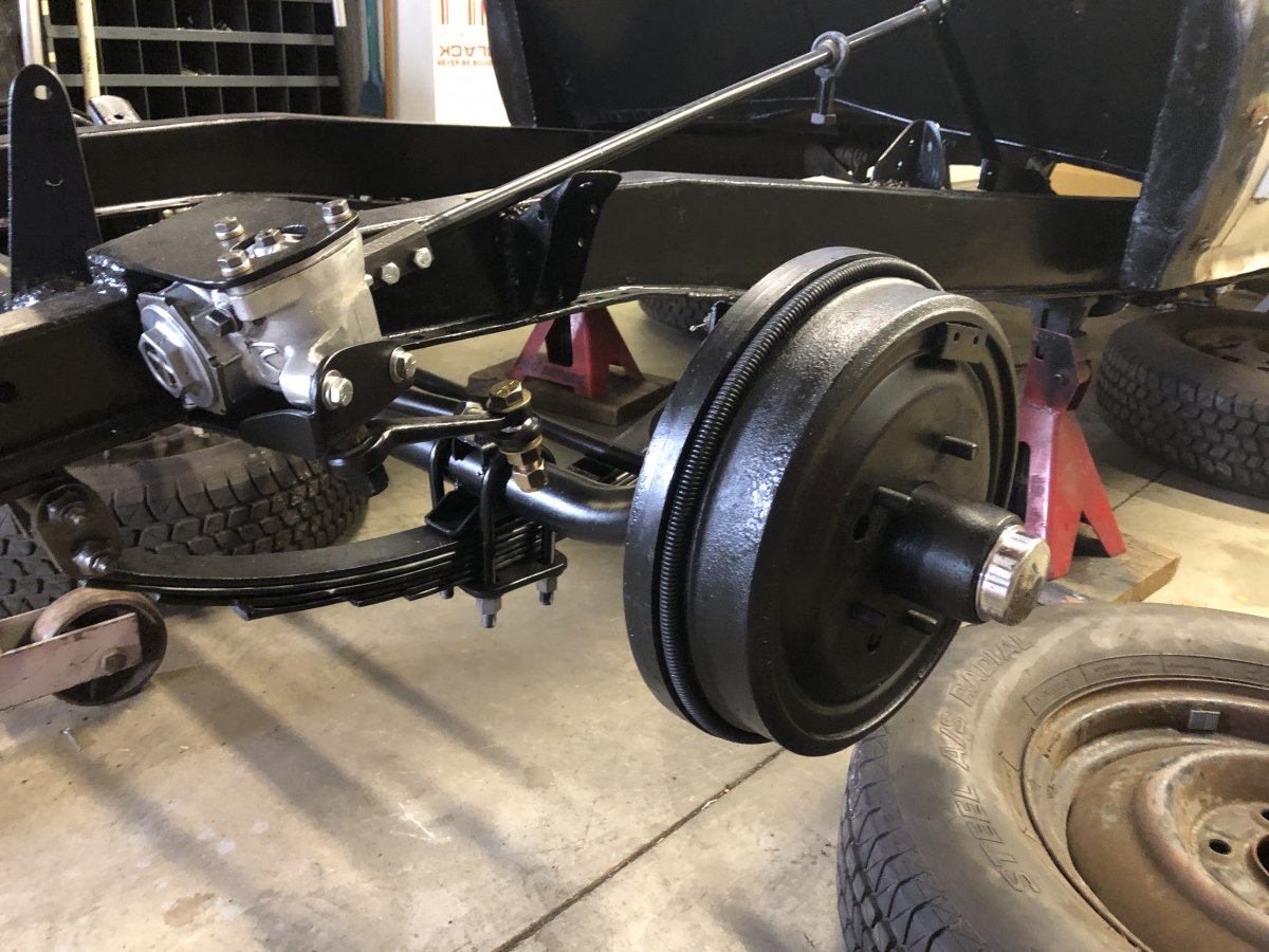

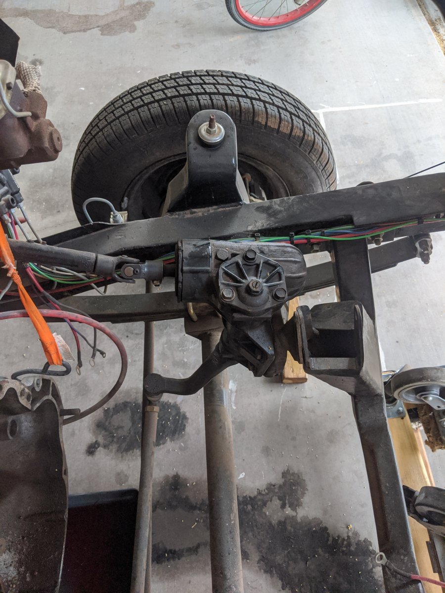

    I like it, would love to stay with a mopar box.

    since when are those Mopar manual boxes cheap and easy to find? :) Plus you have to build a really wild bracket to mount it to a frame rail.

    Squirrel is correct. They are not cheap or easy these days, and the bracket is a little ridiculous. It basically boils down to its what I had so I used it...... So I guess it was cheap and easy for me.

  14. Those flat plate arms limit you to Heim ends. If you use one of those tie rod ends with a tapered hole for the drag link; you could very well retain the stock steering arms. I don't know if the taper is different on the truck arms; but the car arms I had needed to be reamed out to the larger Ford taper.
    Someone gave a 525 appearing box they said was Jeep; it had a short input shaft and a quicker ratio then a regular Chevy 525 box.

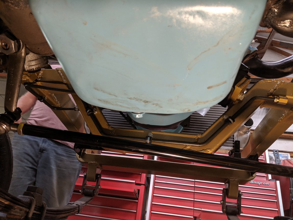

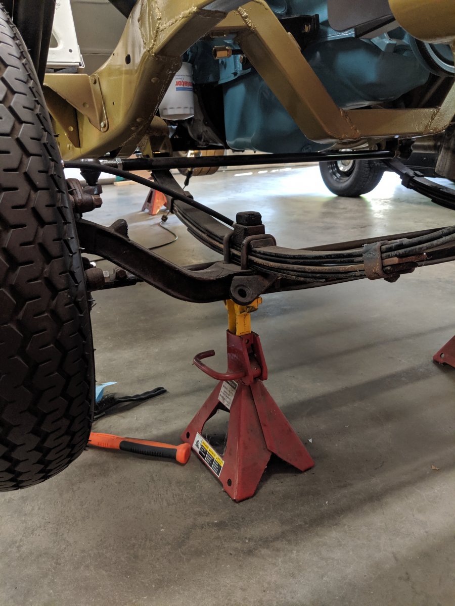

    I use a Corvair box stock mounted in front of the axle. The spindles are 62 Corvette with bolt on arms facing rear(stock position) tied with 5/8” rod ends. There is a purchased arm (Speedway) mounted to the right spindle and the tie line is 1/2” pipe with 5/8” rod ends that steers in front, almost over the top of the axle. The stock box works great like this.
    Brakes are also 62 Corvette. The photo is tough to see all of it since it’s all painted black. Engine is a 302 GMC 6 all iron and probably heavier than what you have. F893D05B-CBA6-40E4-AA4A-F5AF295AE460.jpeg 37E05D83-6817-4800-9B4B-82C0FEA7643A.jpeg
    METAL MELTDOWN and d55dave like this.

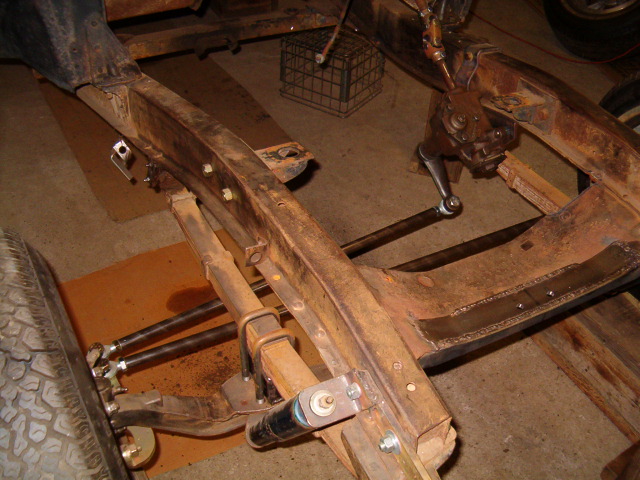

  25. About as traditional as you can get!!

    "the tie line is 1/2” pipe with 5/8” rod ends that steers in front,"
    I hope that "pipe" was just a loose term used in your description and that the tie rod is actually DOM or some suitable material.
