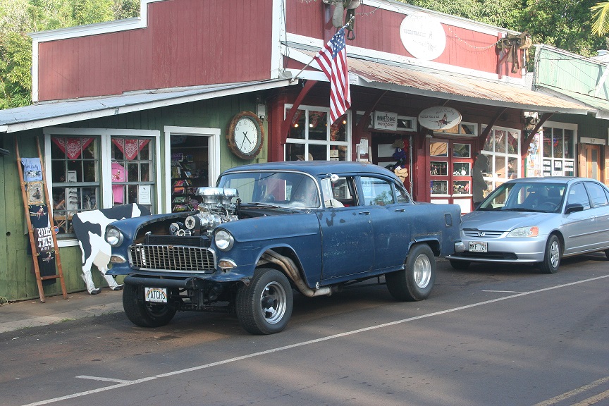

  27. bill3337
    Joined: Sep 30, 2007
    Posts: 231
    bill3337
    Hi Willy,
    Here's a shot of your '55 in downtown Makawao (a small cowboy/tourist town in upcountry Maui for those that haven't been there). You don't see many of those around there! Hope your eye is healing up. Bill
  28. Willy's 55 Chevy is a Maui version of the 55 from Two Lane Blacktop, just plain NASTY!
