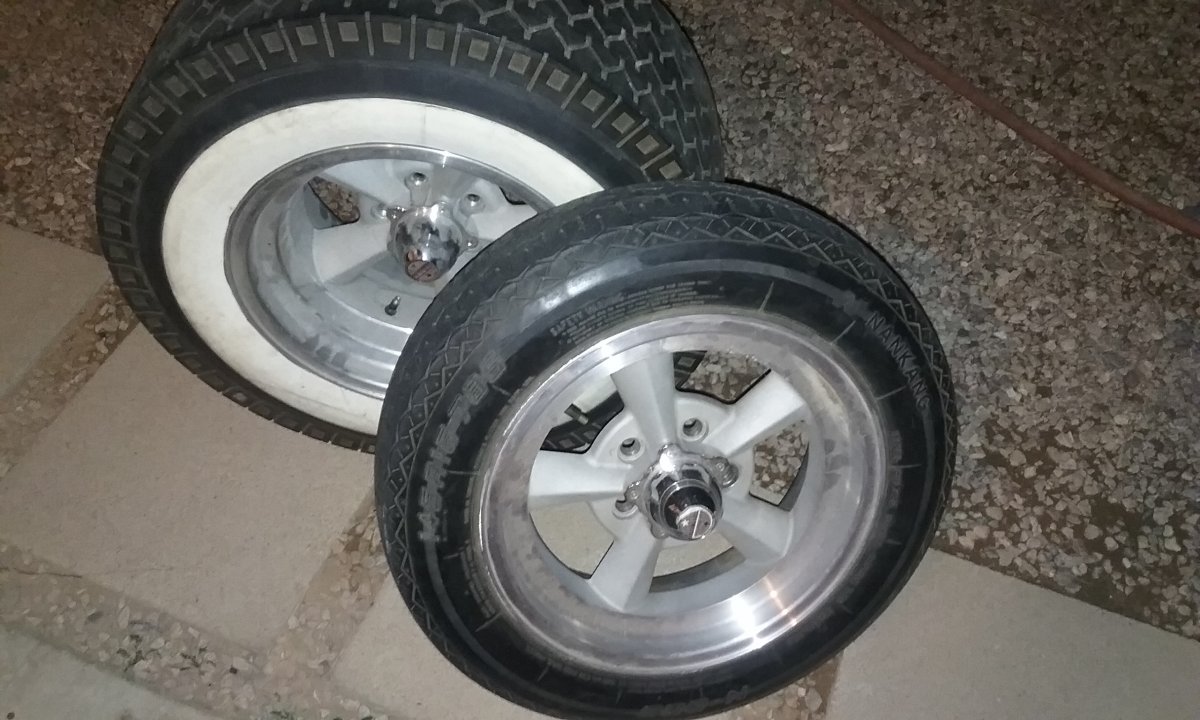

    I picked up another set of 4 today
    15x5s and 15x8.5s $200 not sure if backs will fit, but i have 7s and 8s
    simpsonrl and chevy57dude like this.
  19. Hell of a deal on those wheels.
