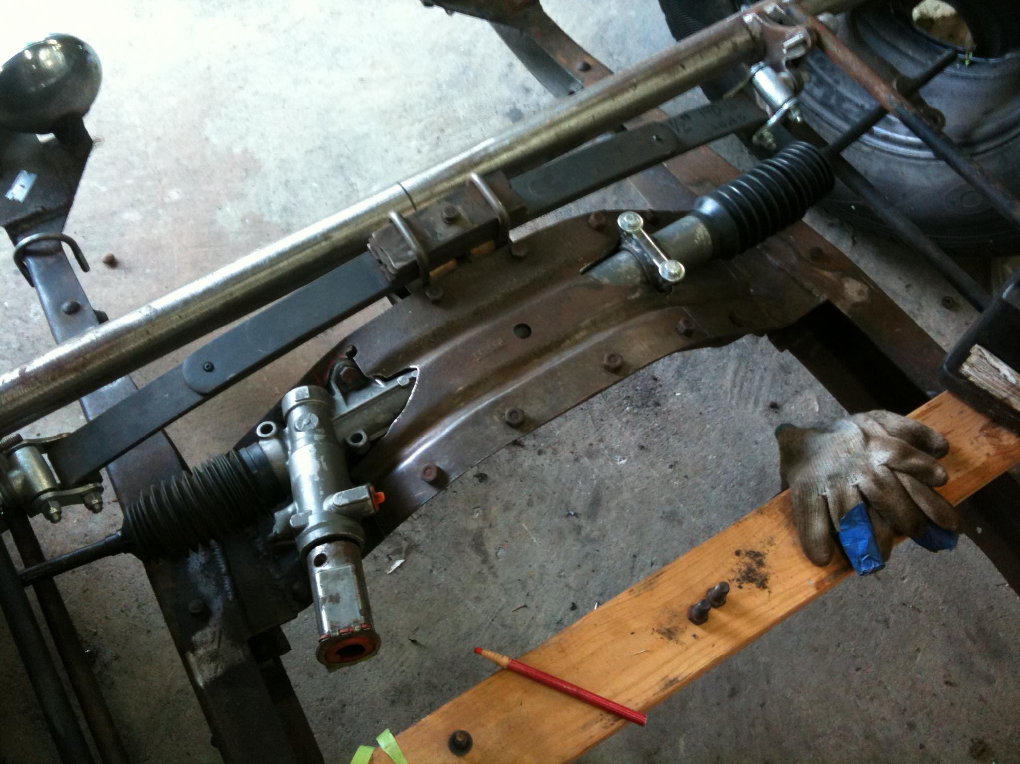

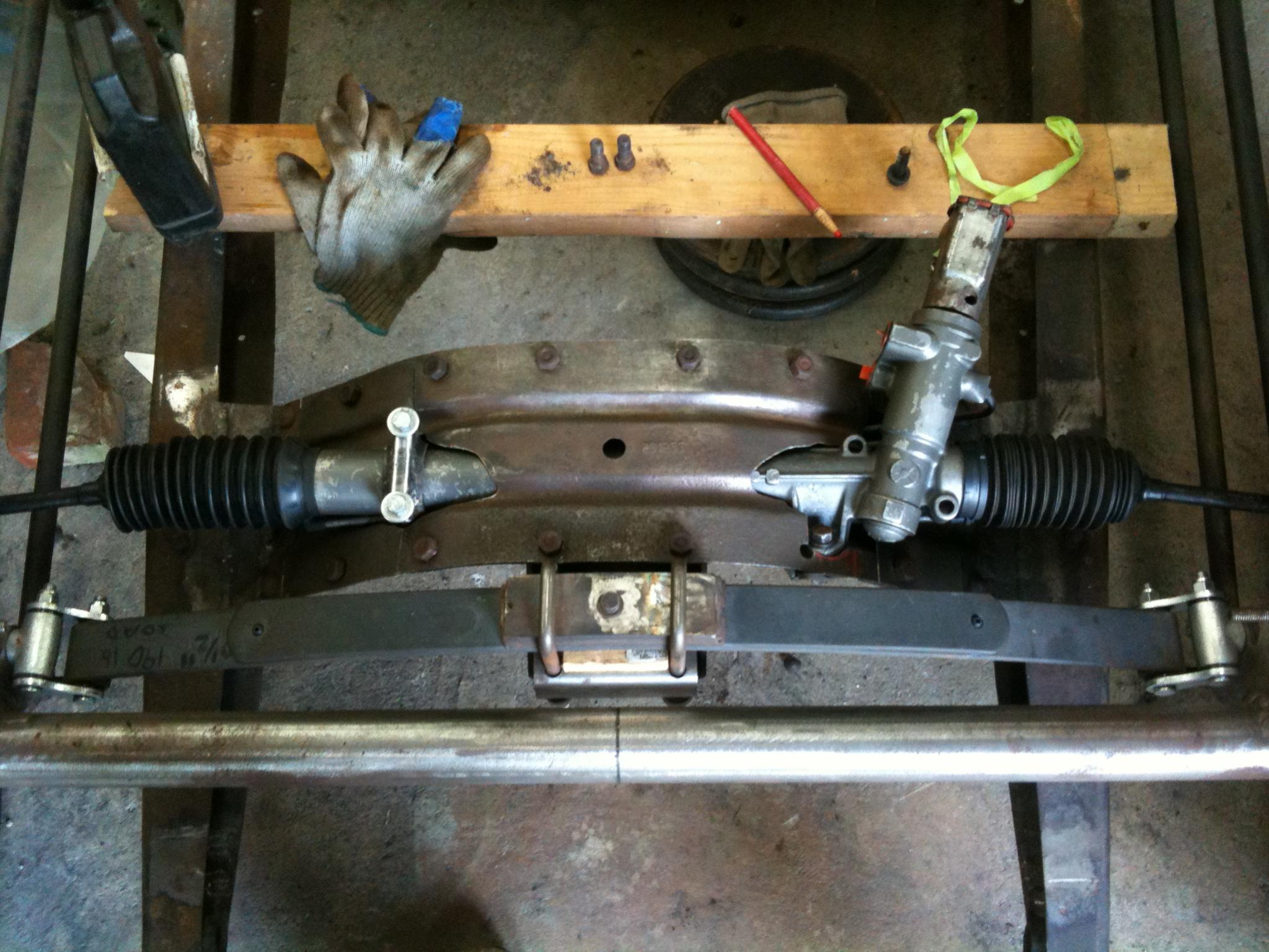

    Rack assumes final location. Next, fabricate cover which was the bottom of the cross member before I flipped it.

    As stated, that rack is going to pull the toe in all over the place as the front axle goes thru its travel. At highway speeds when you hit a dip you better be holding on to that wheel. No McDonalds or coffee in your hands. I'm sorry, I love innovation and I'm far from a traditionalist, but that is just plain dangerous. If you attached the rack right to the axle and let it travel with the axle, than it will stay stable. You're scaring me Dude. MArk L

    You have successfully built a death trap. Congratulations.
    I wont bother you with facts or the laws of physics as they are clearly beyond your grasp.
    I will say once more that what your doing will not work, its not worked for anyone else thats tried it, and it wont for anyone in the future that tries it.

    With that long fourbar rods you need much
    heavier tubes or they going to bend and
    the stearing is not going to work you
    are going to get bumpstear and tirewear
    if you can keep it on the road that long

    Here's the thing that pisses me off about this kind of thread.
    The original poster will NEVER come back on and say how bad this thing drives, he will instead extoll the virtues of the style, or the look, but will never mention that it cannot be driven over 5 mph without wanting to crash.
    Then some wannabe/newbie will come on and see this thread. He starts thinking,, Wow, I like this guys style, hes a true rebel cause he's throwing it in the faces of the professionals, and since he hasnt come back to say what a heap of shit it really is he must have not had any issues. So he then copies the build and "engineering" and ends up with another undrivable piece of shit.
    Now since he has no experience with what it should drive like he just assumes that all straight axles drive like this and it turns him off to the hobby, or worse kills him or some other innocent bystander. This in turn gives us all a bad name as by his reckoning we all drive uncontrolable shitboxes, no matter how nice they look.
    All because someone didnt cycle the suspension and watch the front wheels toe in and out because of his shitty attitude and under engineered design.

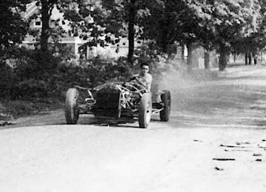

  23. First off, you are no where near the first to attempt this (Streetrail) as you claim, maybe the first with a truck cab and tractor grille which makes it fit nicely in Rat Rod mentality. Also your frame mounted rack with the axle will NOT work as many have posted - you seriously need to rethink that
    This one is similar, and about as silly looking as yours and was at Bonneville a while back
    This one was done and street driven in 1951
    And this one was on the show circuit a few years back and at least looks something like a Rail - not a crap rod

  27. arkansas Bob
    Joined: Aug 2, 2011
    Posts: 27
    arkansas Bob
    If you use a rack-pinion on a axle it has to be mounted to the axle to avoid bump steer, the steering shaft has to be a flex cable or a slip joint to provide suspension travel. As for alignment settings- 1/2#Neg camber--10#pos caster-1/4in toe measured as close to the floor as possible front and rear. This has worked well for us, at close to 200 mph,
