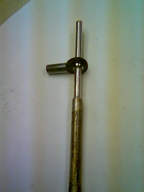

    Hello, I am building what I call a Streetrail. 45 Dodge pick-up
    I am fabricating a gasser axle over frame, spring behind, four link front end. The engine will be about three feet behind the axle.
    I am curious as far as opinion on this type of fabrication, what the positive caster should be set at?
    I have tried to make a level surface. The best I can come up with is a department store mirror shimmed up with poster board. I have found that the practice king pins rock fore and aft on the gauge blocks slightly. I would like to know if anyone has seen a Speedway gasser axle off just a little bit. I know I will not no for sure until I find a surface plate to set this up on.
    Info will be greatly appreciated in this anal hour of need.

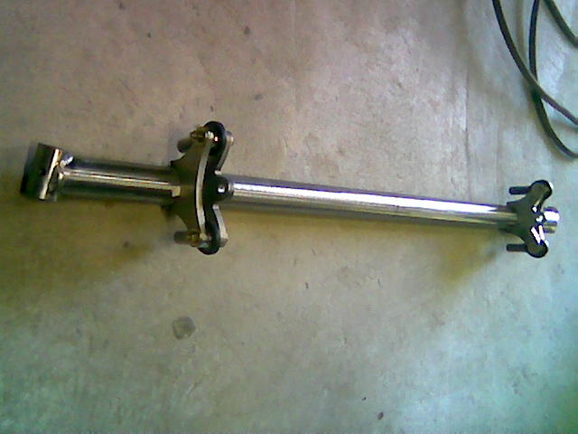

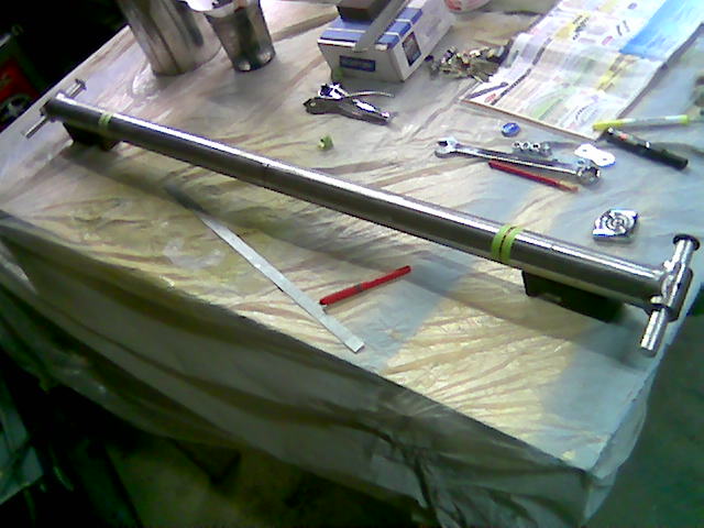

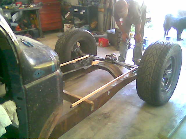

    Here it is. Nine and one quarter positive caster.

  12. Lakeshadow
    Joined: Sep 4, 2008
    Posts: 55
    Lakeshadow

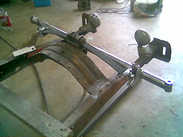

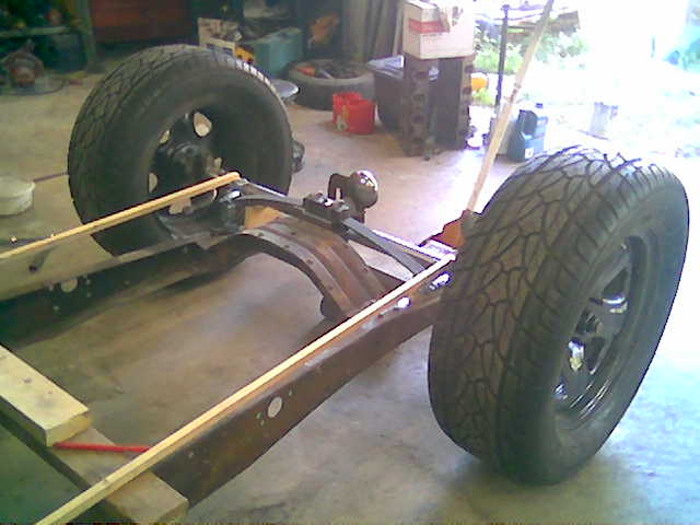

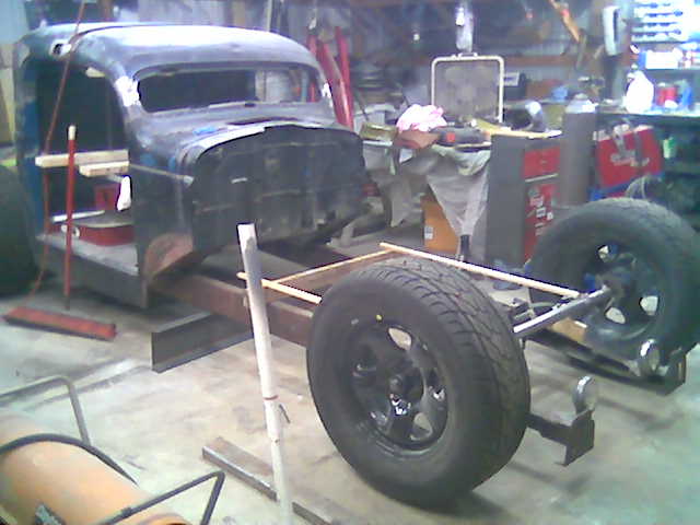

    here we go

    What the heck is going on there?

    Hello Chuckles,
    Well, the design is a design in progress. A continuing development. Next thing to fabricate will be the four link rear brackets. The radius rods will run all the way back to the cab. They're mounting location will be hidden, behind fabricated cab sheet metal parts, which will bolt on as the rear of the stock fenders did. The suspension parts as well as all the suspension build so far, front and rear, will be height adjustable, at least for now. Until there is a fully dressed Hemi and six speed bolted in. And cab and box completed.

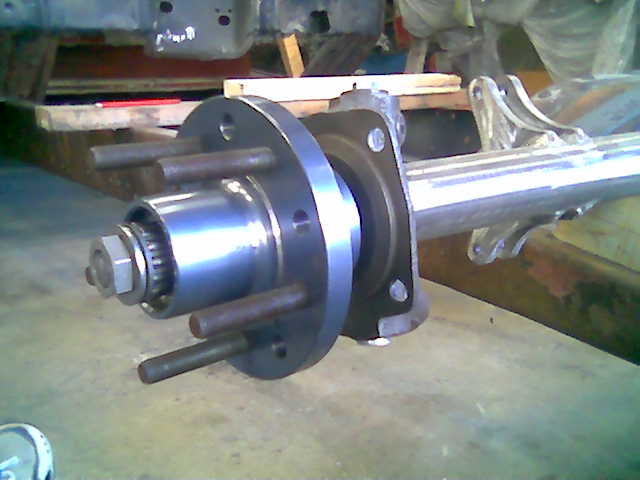

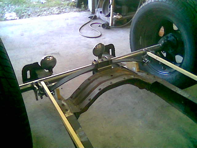

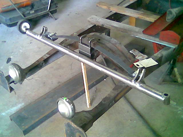

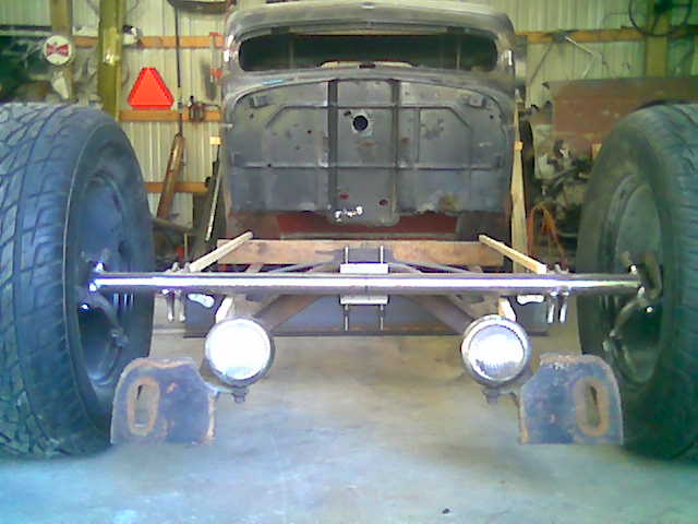

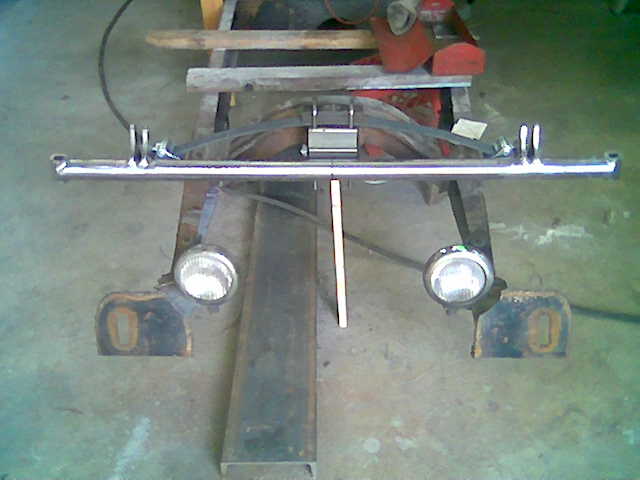

    Front end, rear 4 link brackets.

    Good parts, and great fabrication, but I think the truck will be WAY out of proportion. I mean, I am guilty of that crime in the past myself, but this one seems wacky IMO.

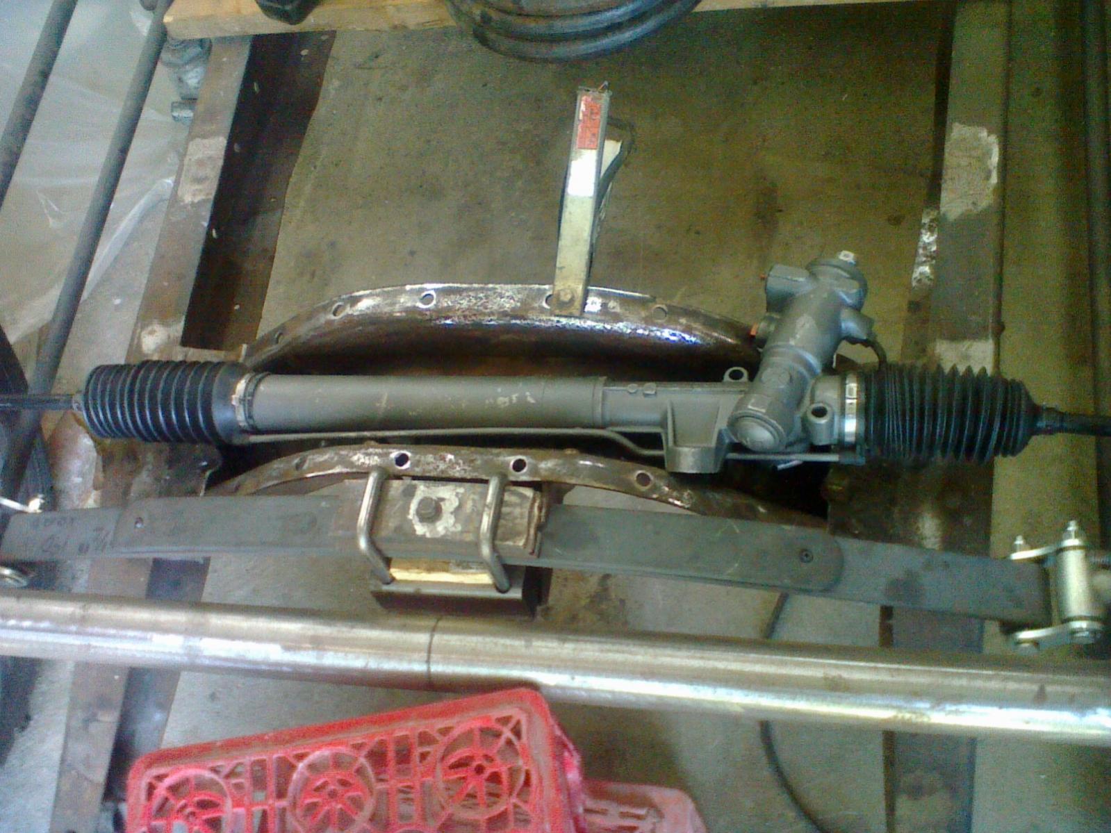

    power rack on a straight axle????

    so once you get your rack mounted do yourself a favor.
    cycle the front suspension and watch what happens to your toe in/out.
    what your building is an uncontrollable/undrivable death trap.
