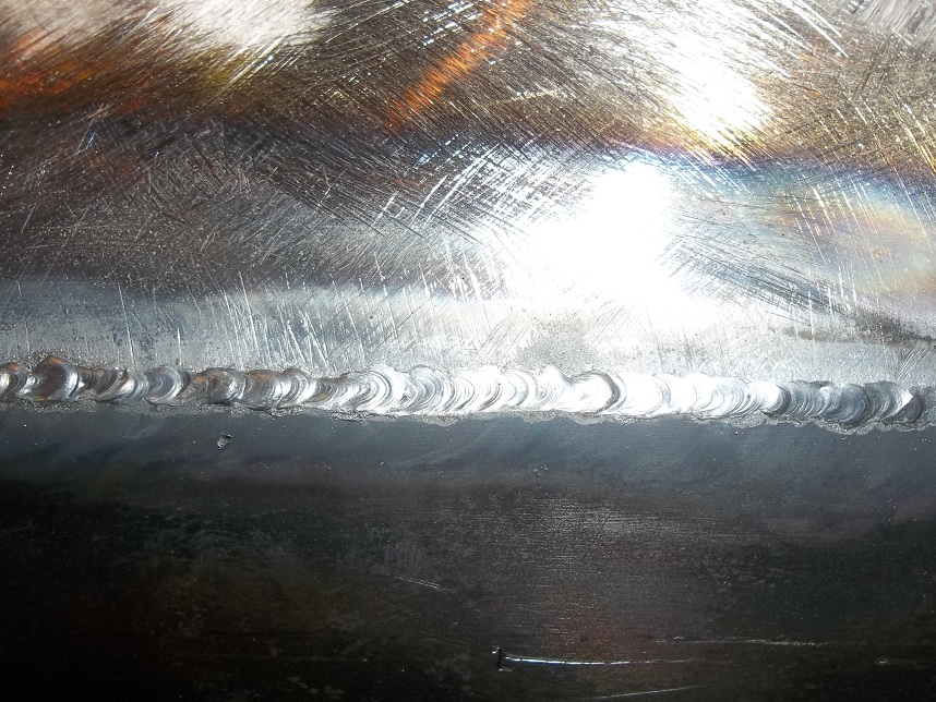

    Just picked up a nice oxy/act outfit for welding and I can't wait to give it a go. I hear its possible to make nice welds and would love to see your work. Any tips before I start would be awesome too. Is this also called Hammer Welding?
  2. langy
    Joined: Apr 27, 2006
    Posts: 5,735
    langy
    Hammer welding is done when you have welded and then using a hammer & dolly the bead is hammered flat while still hot, It takes some practice to be done right. usually done with gas welding but can also be done when tig welding if you quick enough.

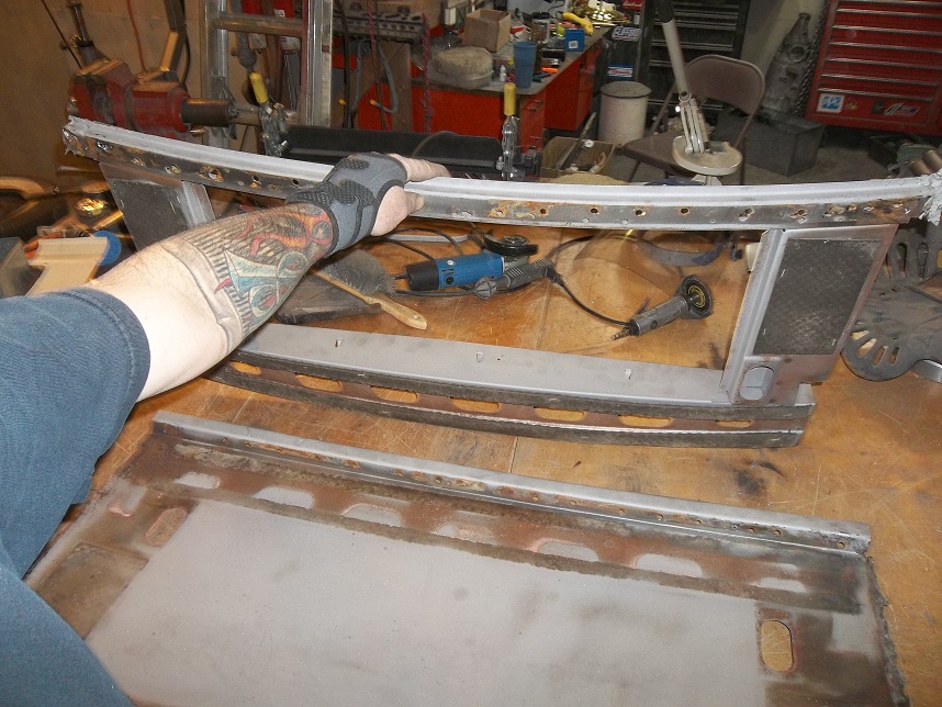

  3. I did this yesterday. It's a "cat walk or two lip" panel that was hacked together on a 57 bird. The panel had been mig welded in with the inner structure of the car pushed over 1& 1/12":confused:
    I needed to add to both ends of the panel. I had to separate the skin for access
  4. I O/A welded a 1&1/2" strip of 18 ga. on the end of the skin. I did it with little correction during the weld. Tacked every 3" hammered the tacks. Then welded, pretty much just let it move how it wanted. Hammered only to maintain alignment of the seam. Then filed the weld bead then planished on my RR track, followed by a few passes on the air planishing hammer.
    Total time about 2&1/2 hours. Not a metal finish, but close. This piece will lap over the quarter and be leaded same as the factory. This is why I like my torch:D

    hey Tinbender, what is that tool in post #3, the air tool? Never seen that before.
  7. Big D n' snuffy
    Joined: Jul 27, 2009
    Posts: 5
    Big D n' snuffy
    looks to be a spot weld cutter?
  8. Yeah it's a Spotel. Cuts one layer at a time to cut the resistance spot welds.

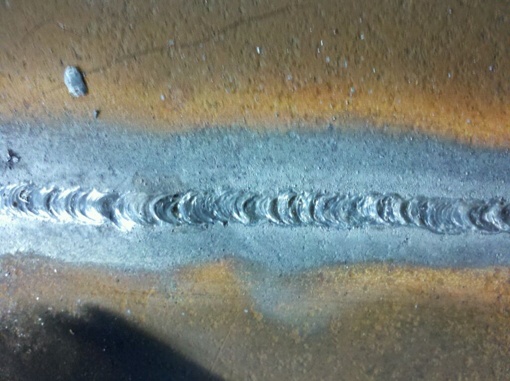

    This is from when i first got a torch, i was proud.

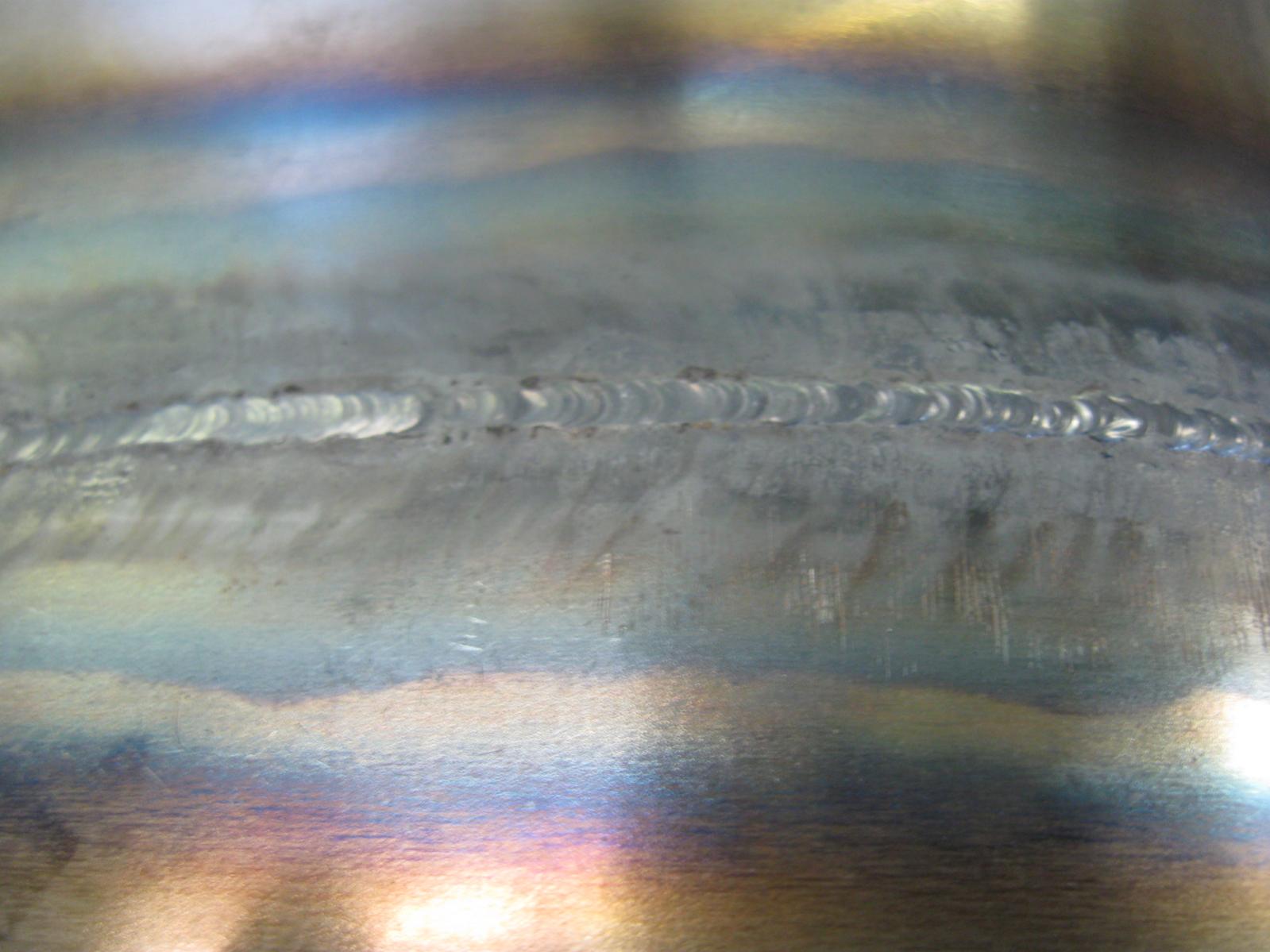

    The fattest section of a tuned twostroke exhaust I started making as a practice project shortly after getting my Henrob O/A welder. I had no welding experience, just seen some demo videos on youtube and read a handbook. What you see in the pic is probably a third of all welding I had ever done at the time, so there's a good reason it's not perfect. Under those circumstances I'm pretty happy with it, but I want to keep getting better ofcourse.
    0.7mm (0.028") mild steel, fuse welds mostly, filler added only where the gap was too large to make fuse welds. All sheet metal shaping done with a simple mallet over a steel pipe, so no fancy tools used. :D

    Very nice G-son for so little practice.
    This thread is awesome. I've learned a lot in its short life so far! I've always heard that if you can gas weld you can weld using any other technique.
  26. Nice job G-son! My first "real" gas welding project was a pipe just like that one!
