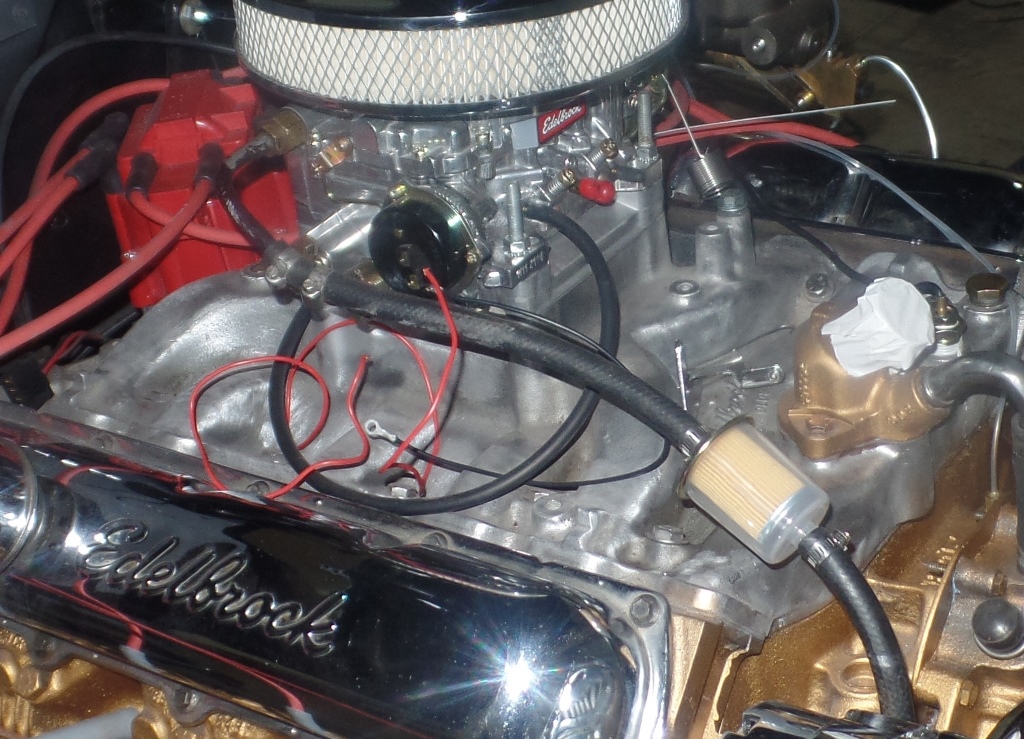

  20. main line steel and some rubber the steel to the carb and im gonna take that plastic filter and change it out to a glass one and insulate everything
  21. EZ Cool

    A glass fuel filter housing is not a good idea.

    Yeah I agree, metal filters. Plastic or glass are just asking for trouble

    On that note it doesn't look like on your photos that you have any line that runs near a hot spot? Does it get near the manifolds or other exhaust as it runs back to the tank? Figuring out where it's getting heat will help a ton.
    If it's not close anywhere you can see I'd be leaning towards the carb spacers as a possible solution?
