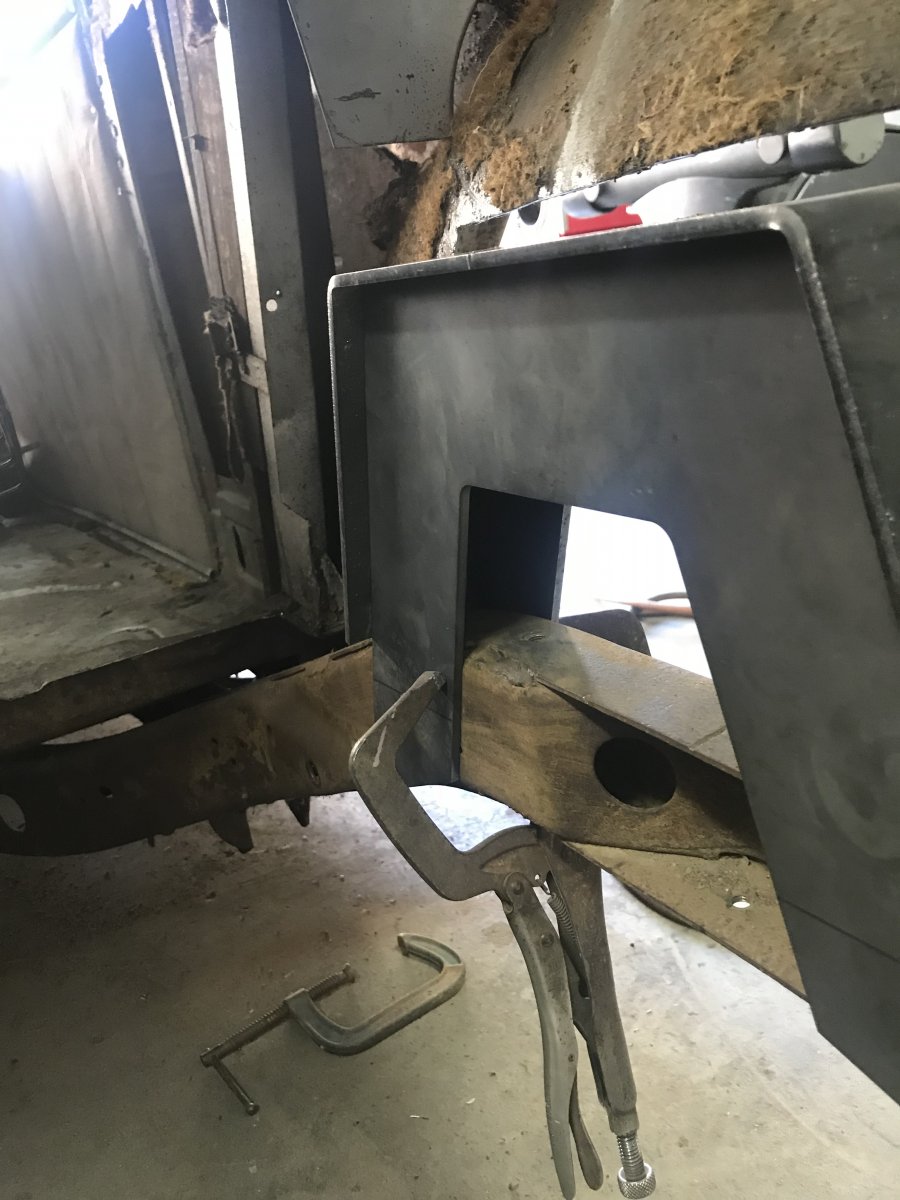

    Ive been following this thread and its really helping me install my Gambino taildragger kit. On mine I noticed that the c notch width is about 1/2 “ wider than the frame once one side is welded flush thus causing a 1/2” overlap towards the inside of the frame. I chose to let the overlap towards the inside instead of the outside of the frame in order to not disturb the brake caliper clearance on the outside of the frame. Browsing through the web I have not seen any setup that has such a large overlap.
    I cant imagine there being a structural difference just cosmetic. Does anyone have any advice or have seen a setup with an overlap this large?

    I'd just cut or grind it back to a 1/4" and run a nice fill weld to it. Should give you a good strong weld area.
    I'd say they are made wide to fit different frame width and you cut to fit width.

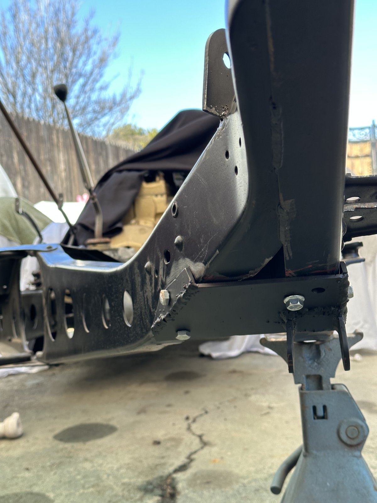

    Thanks for your help and pictures. I ended up boxing the frame before placing, alligning and cutting 1/4 inch from the inside overlap. This game be a 1/8 inch overlap and I was able to weld a good bead in between..
    Boxing the frame made the frame width the same which then allowed me to better alling the notches
    Attached are some pics before and after I boxed the section of the frame
    buzzbrother likes this.

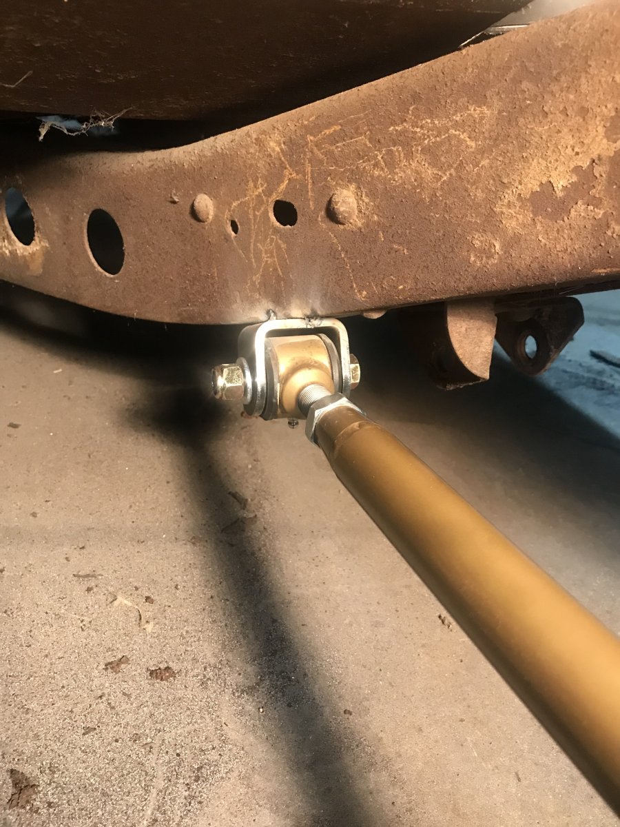

  13. 40desoto
    Joined: Jun 19, 2013
    Posts: 80
    40desoto
    Any updates on the ride? How did it all turn out. I have a 1940 Mopar and my frame is an X frame. I havent seen many examples of one with a triangulated 4 link installed.

  15. 40desoto
    Posts: 80
    40desoto
    Thanks! Yes life happens like that sometimes.
    Im wondering if it even matters. Most Ive seen are mounted about 4-5 inches inwards from the inner frame. Mine appears to be about 6-8 inches inwards. Wondering how much, if any, it matters.
  16. gimpyshotrods
    Joined: May 20, 2009
    Posts: 24,267
    gimpyshotrods
    It will affect handling. The should be as far apart as possible.
    That said, I'm not sure you'd notice, unless you were setting up a road-race car.

  23. 40desoto
    Posts: 80
    40desoto
    I ended up relocating my lower bars to get them closer to the wheels and made a bracket to help strengthen the mounting point. They are now at the same location as the original leaf springs. My project was delayed due to childbirth in between so I'm back at it now.
