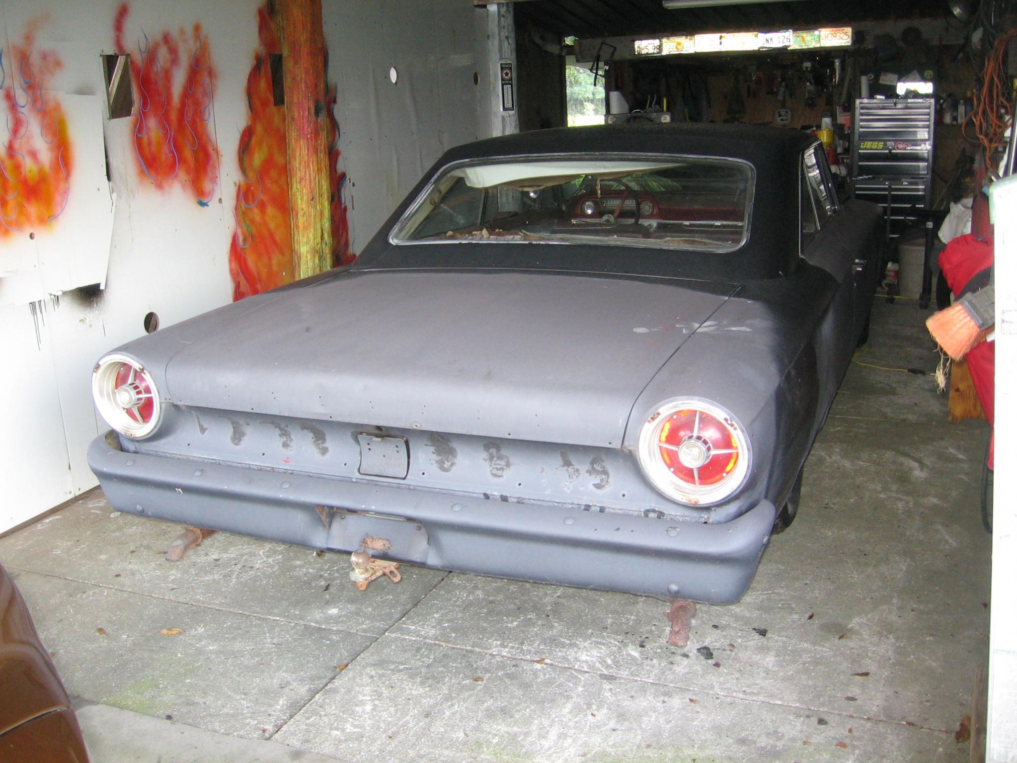

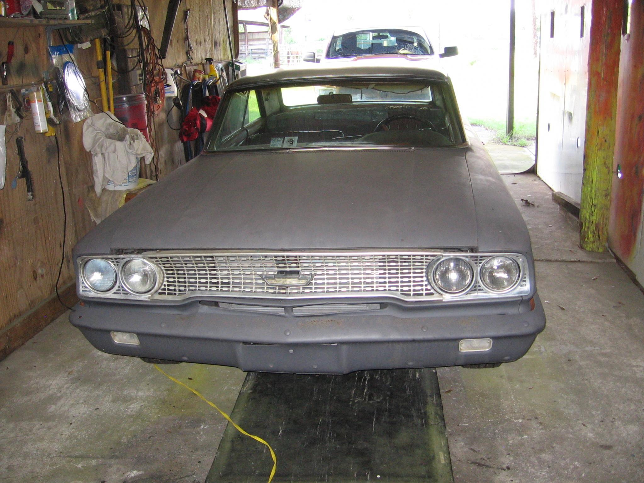

    Just wanted to share my new project with you, I recently sold my 64 Country Squire with the sole purpose of building a streetable STOCK CAR CLONE more specifically the Holman Moody 1963 1/2 Dan Gurney Galaxie.

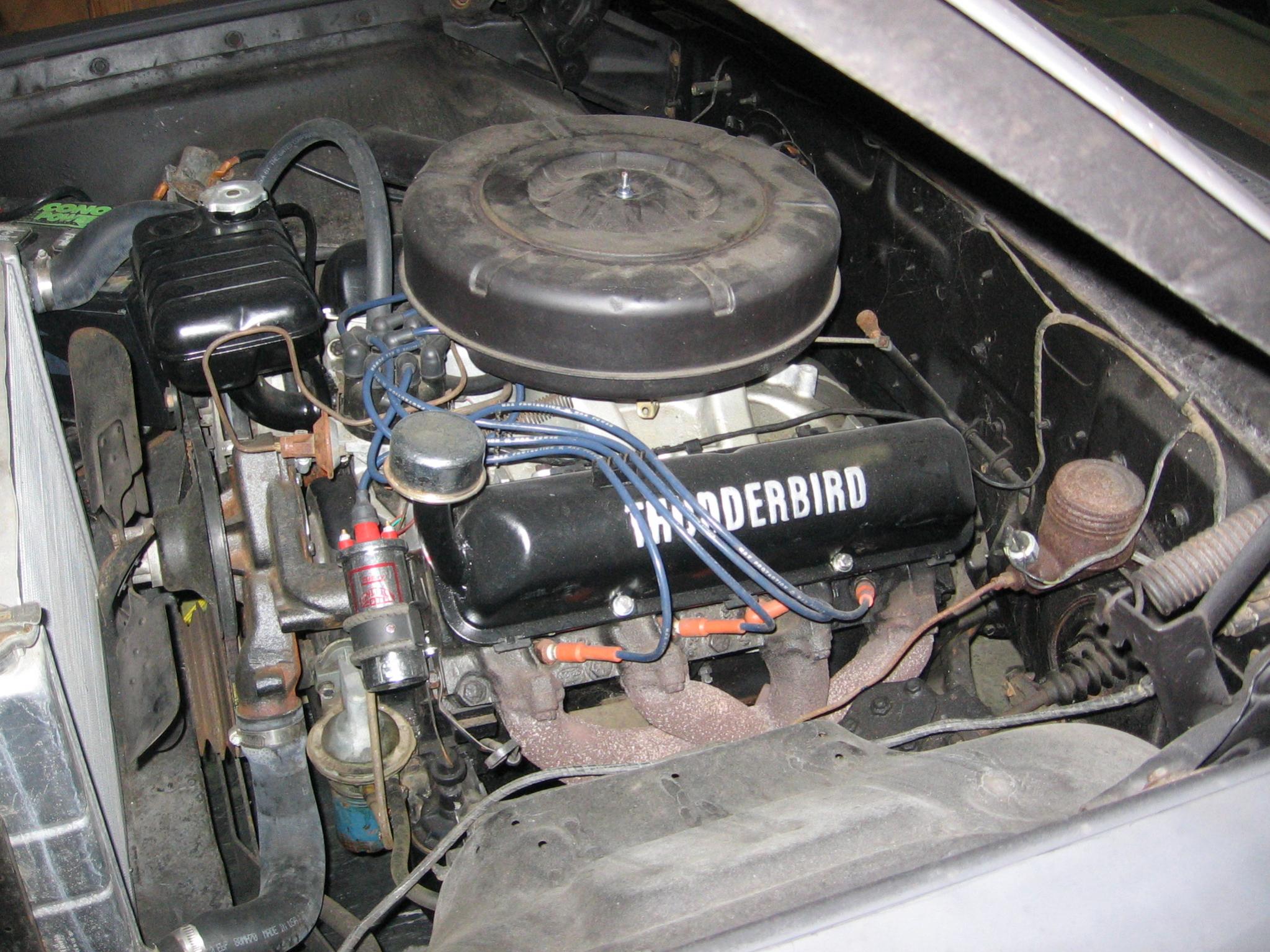

    I picked up a nice project car all of the engine trans work done. Its a 63 1/2 Z code with the factory 4 speed originally out of Virginia but was down in Deltona Florida. Body not great he put new lower QTRs, patched the doors and front floor pans lots of little dents / dings but fixable.
    The car sometime in the late 60's had the motor replaced with a 390 1963 Police Interceptor "P" Service Replacment Block" per the casting numbers, it was built correct it has the late model 1963 406 tri-power solid lifter heads and cast iron headers, it has a posi rear end versus the orignal dog leg. NO Options on the motor manual steering and brakes just like the race car. I am not doing any major suspension stuff just dropping it lower to get the race profile and may do a dual Master cylnder conversion, It has a nice 3 core aluminum radiator. I will be adding a remote oil filter set up to give a race vibe.

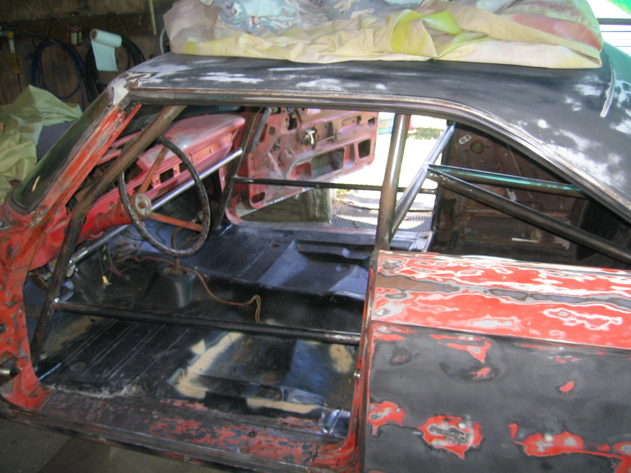

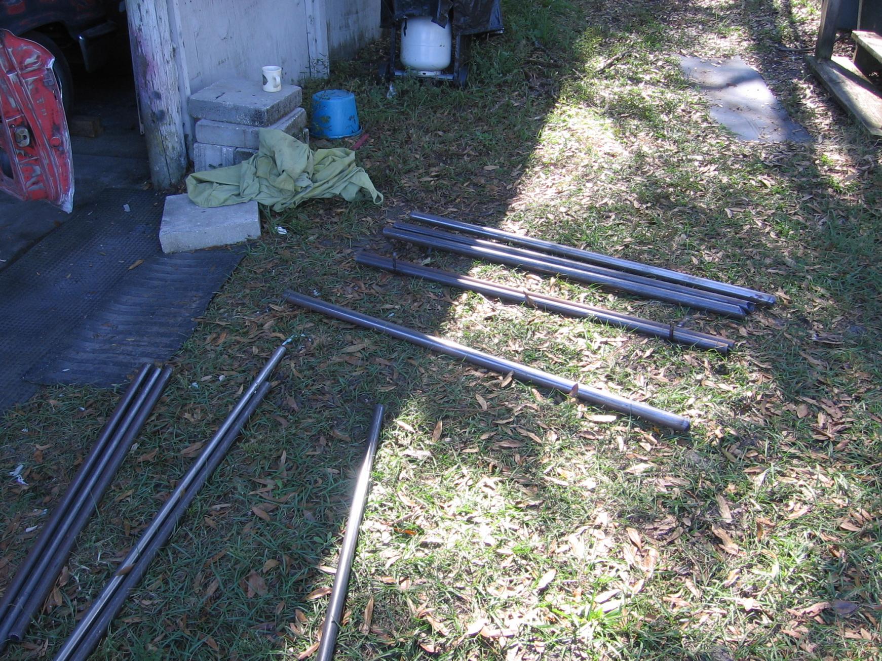

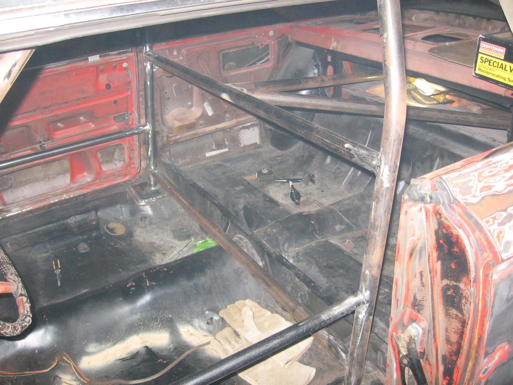

    I have had the car 3 months and have stripped the interior to a bare shell, I have installed using a 12 point roll cage kit from JEGS a new roll bar set up matching the orignal HM Race car set up wit hthe exception of the bar going thru the fron floor to the frame as I may add a passenger seat in the near future.
    It will have a custom made 6 gauge pod set up, toggle /push button start, period style race seat with 5 point harness, I have a new set of Wheel Vintque 15x8 Ford Steelies and a set of street tires matching the original race tire height /width /sidewall which I will shave the black letters and spray the Firestone logo. I am creating the frame thru exhaust just like the race car whcih will require cutting the qtr panel and adding the notch for the exhaust we will run a 3" straight exhaust.
    It will have functioning lights /turn signals but with wire mesh custom made covers for the headl /taillights which will be painted and the race number added. I have set of delete plates Heater / Radio /Clock just like the race car had.
    I am working on a potential "Batwing" aircleaner build with Spectre Performance out in California me and one of my Engineerr budys created the CAD Drawing design to emulate the orignal air cleaner with the option to connect it thru the firewall for a true cowl induction set up like on the race car NO ONE makes this and if it is built I will have the first prototype before they offer it for sale. Probably late spring before it is actually built.

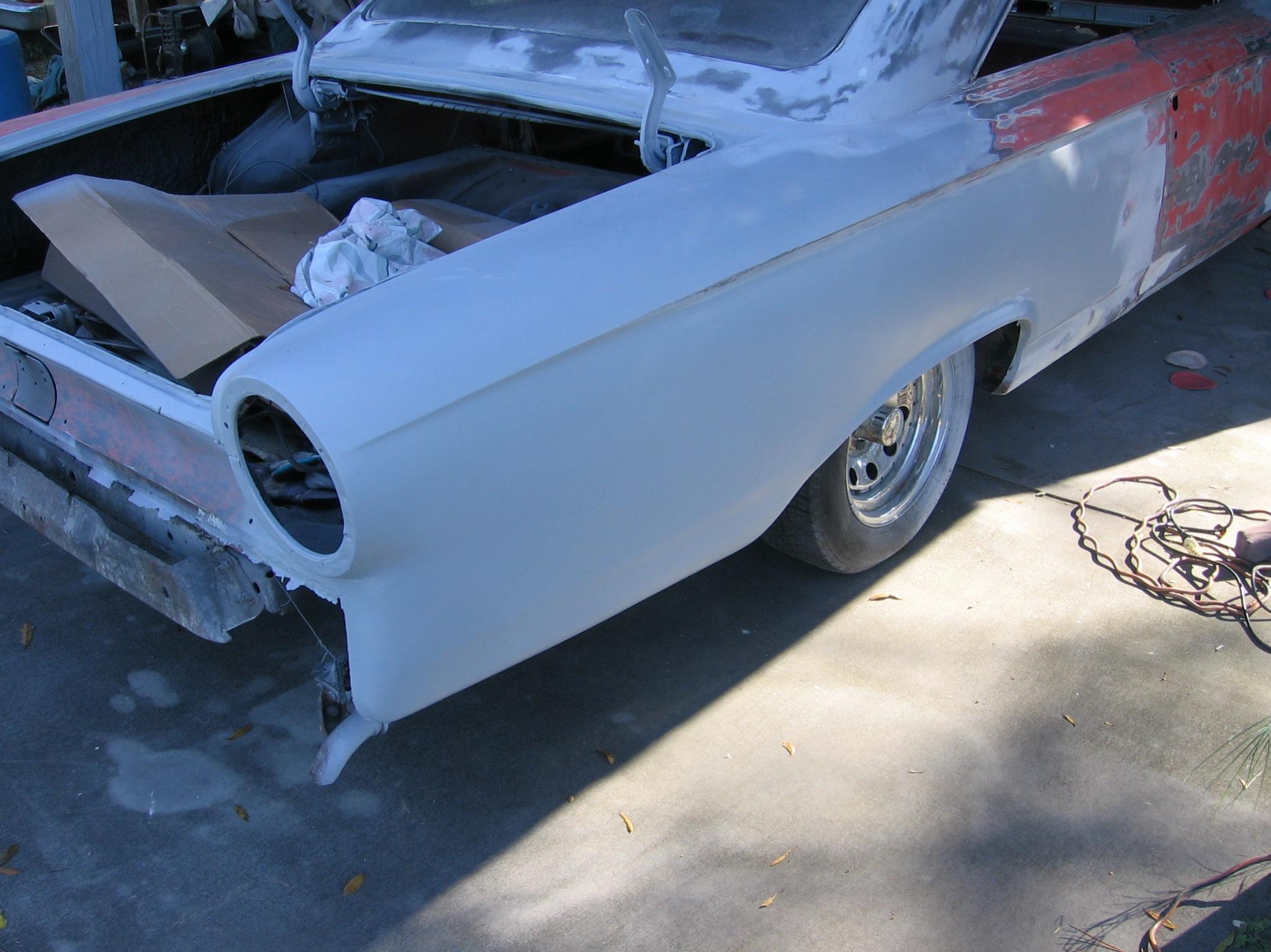

    It wil have full race hood and trunk pins, the car will be painted via amatuer paint job me doing all of the work, it will have three coats of 2 k gray primer, 1 coat of White sealer primer, then a few coats of Wimbelton White and interior/wheels in 58 Chevy Cashmere Blue almost a bright turqouse original race colors.
    I have a freind who will do the old school sign painting of the race graphics no decals here it will be hand painted to match the race car.
    Well I will add photos as the project moves in the summer the goal is to keep the overall project under 10K which included the car purchase I am on schedule so far $8500 car and parts so far, it wil be a driver not a race car but have the race car vibe.

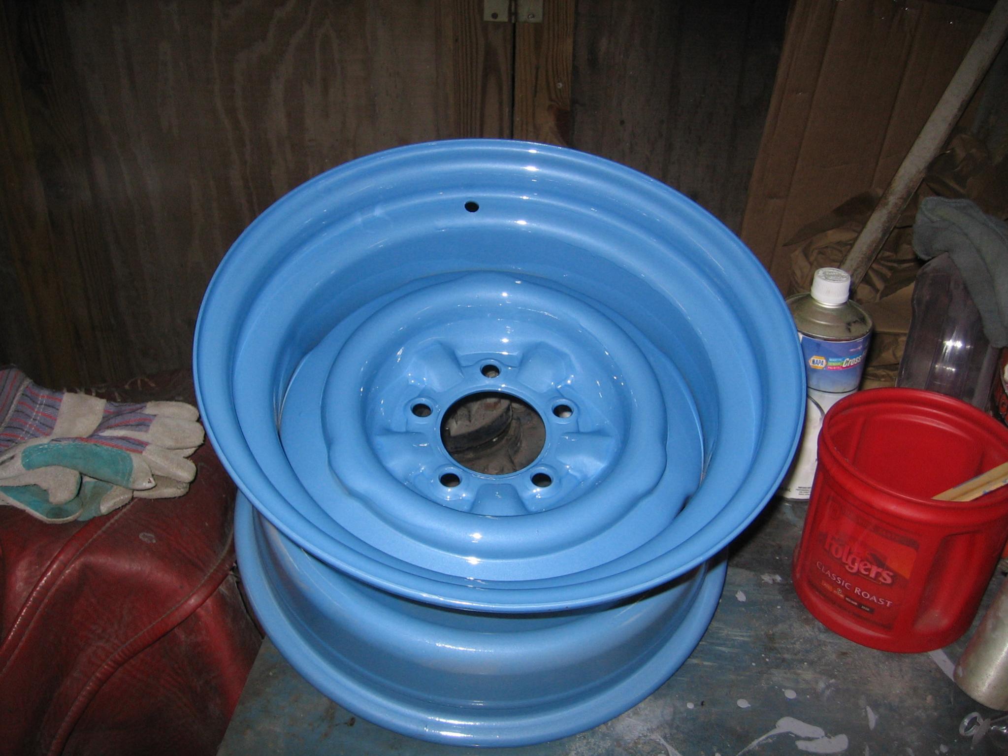

    Posts: 71
    Stacked65
    Well today we where supposed to start on the seat bracket fabrication but my buddy got tied up working on another vehicle so hopefully tomorrow. So as not to waste the day I decided to prep and paint my new Wheel Vintiques Ford steelies 15x8, of course as I start the prep work it starts raining so I have to move inside my covered shop to start.
    The paint color 1958 Chevy code # 910 Cashmeir Blue looks completely different in the can almost has a metallic color but whn you spray it comes out bright blue. Of course since I have not used my NAPA HVLP paint gun since last year I did not have the paint volume set good so I got few runs which I will attempt to wet sadn and then add another top coat.

    Well today started very early as I had lots of runs in the first paint job for the wheels yesterday I started the wetsanding about 6 AM and got them prepped to spray another few coats of paint. Had to wait till around (AM as to not wake up the wife with the compressor kicking on an off in my work area.
    Well I added 3 more new top coats on the fron and two more on the backside. Not bad for and amatuer 3rd time using a paint gun. The were dry about 2-3 PM, so as they sat up I spent them time sanding with my palm sander and 60 grit on the new tires as to shave ALL the big raised letters pain in the ass, all of the small letters and DOT stuff so they look smooth like a race tire look they have very large side walls.
