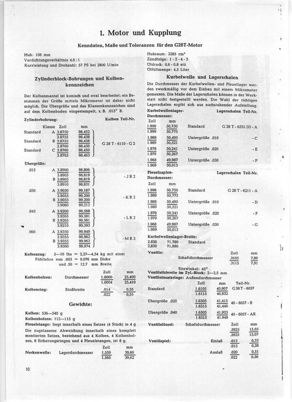

    I have the manual for G28T together with the G39T/G29T information somewere. The problem is that i don't know in what box. I have recently moved You see, but this is a file i have in my computer from that papermanual.

    Thar sounds like what I have, four and eight cylinder trucks (basically 1940 Ford heavy trucks) together, book fron about 1953 or so. Took a lot of hunting to find that and the German parts books. Lots of very long words in there to figure out, too.

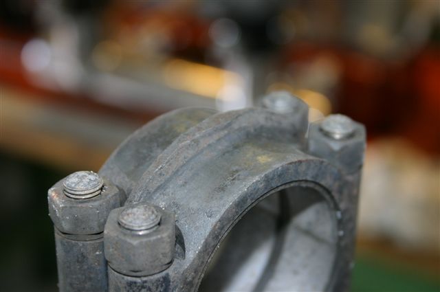

    I found these in a box, and thought they should be interresting to use in the G28T... Real 30`s HAL rods.... :D
    A cool thing about these rods is thet they`re 2 inch in the big end, they have been polished once, and are four bolt...

    First you find a G28t, then you go and really rub our noses in it with the HAL rods:eek: !! Jeez, what's next, a Miller?
    Guess you won't be needing those mundane insert rods. Be glad to take them off your hands.:D

    Won't work unless you have a G28 (--or a Hal) crank will it?
    I do. Also, just curious, what do we do when we need to replace the inserts?

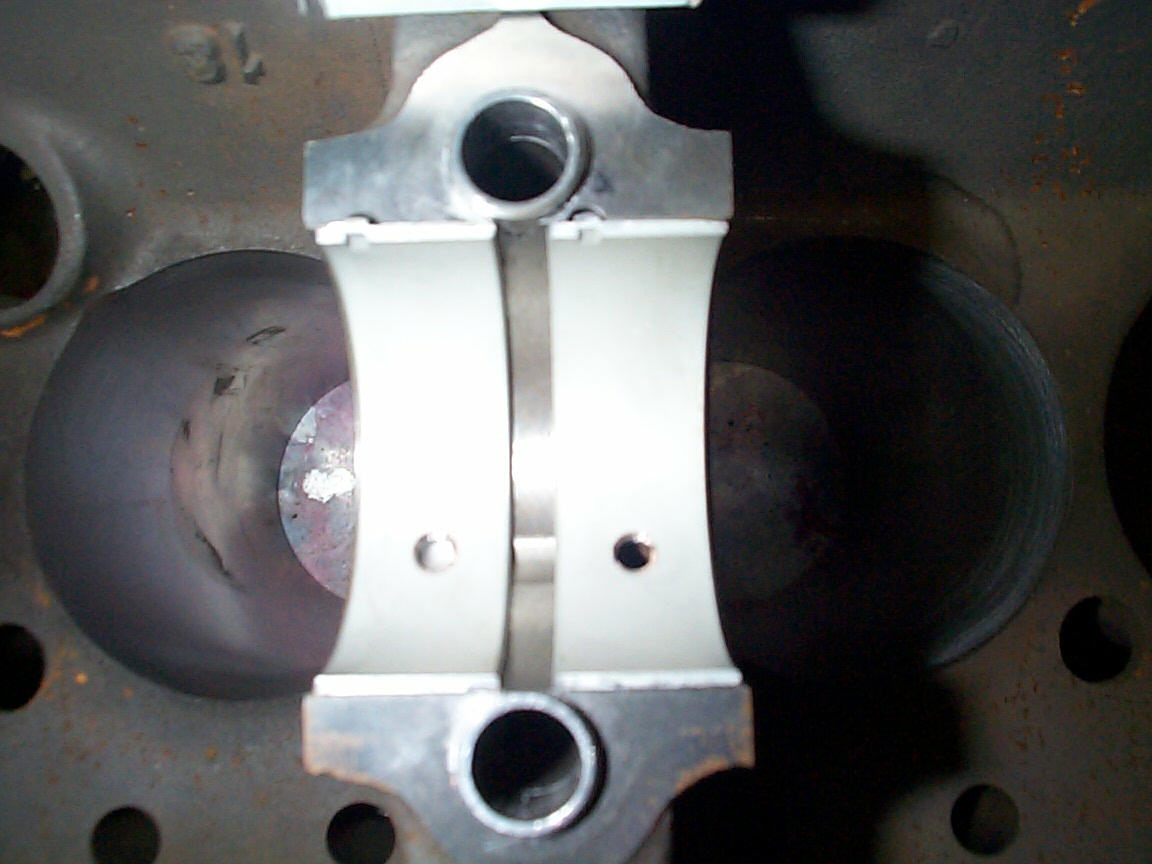

    This is what I heard from another source, so I can't tell how true it is:
    Someone apparently used SBC bearings for the crank and doubled them, placed next to each other.

    I scanned the complete G29/G39T/G28T manual in and have it on CD, if anyone is interested. Also can help You with translation.

    Are you saying on a G28, --or on a standard Model B engine?
    I do inserts just as you mentioned on regular Model A/B engines but the G28 block is line-bored too large to install Chevy rod bearings.

    Brent, I don't remember my Chevy rod sizes, so can't remember whether small or large are the ones for this...but if the small are right, the Grumpy Jenkins piggyback he used on mains would likely work.
    See Jenkin's second book on hopping Chevies...he was by this time period using large main blocks with small main cranks in early pro stockers. He simply fitted a set of large mains, align bored and notchedem, and put the small bearings into the the large--this on VERY fast darg cars. I don't see why same approach wouldn't work with the Chevy rod bearings...I think size step is about the same. I'd add a pin into block out of general paranoia...
